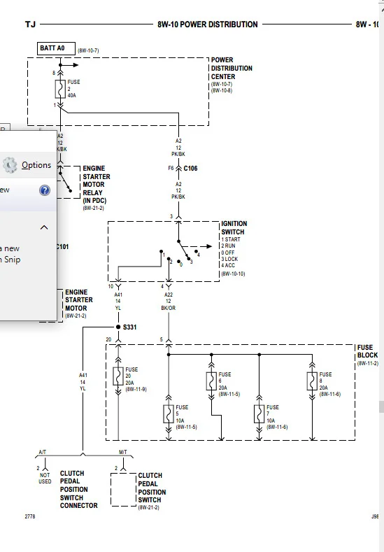

I just bought a 98 Sahara and the blower motor wasn’t working. I traced the issue back to no power on #8 fuse. I also don’t have power on fuses 5, 6, or 7. I traced it back to the ignition switch and no power on the black and orange wire. I have voltage in and the jeep starts and runs great but I can’t seem to get power on the black/orange wire. I replaced the ignition switch with a new one and still the same condition. What am I missing? Also what is with the 2 wire green connector? What is its purpose? Could it stop me from getting power to the black and orange wire?
