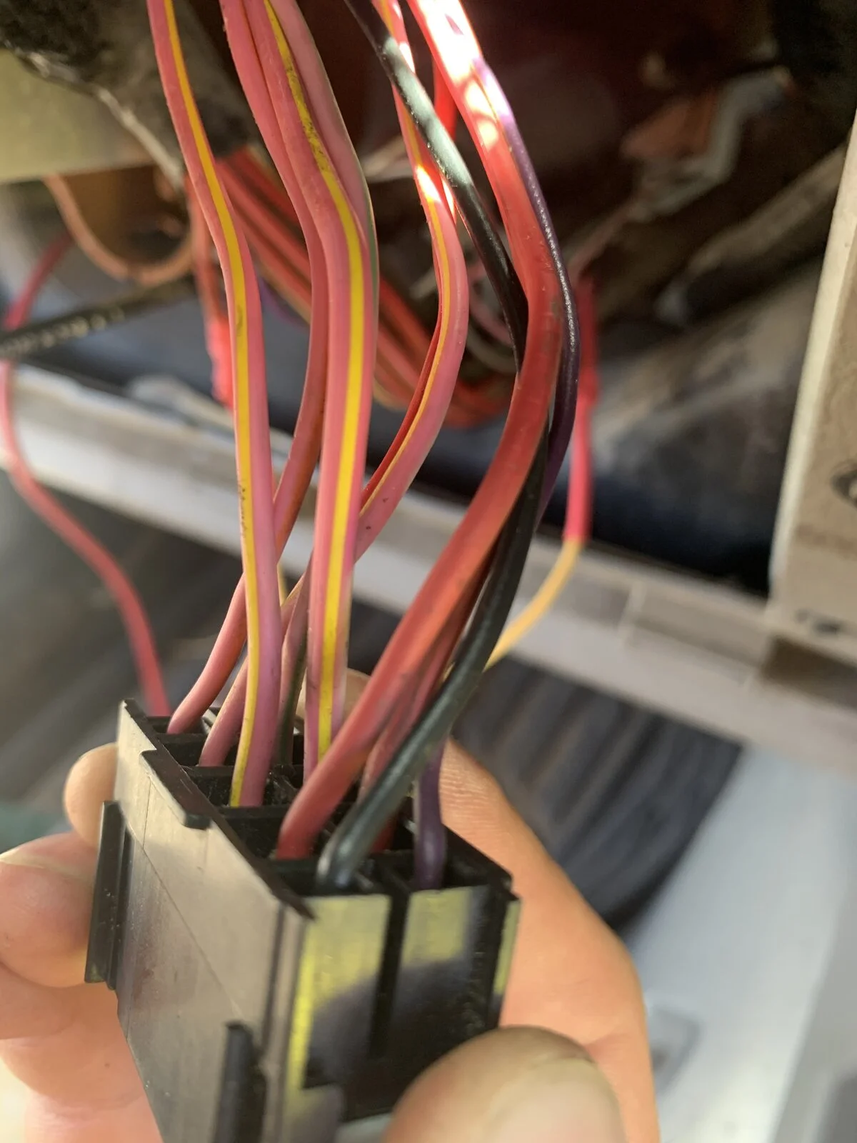

Does anyone know what the purple and white, black, and two smaller red wires are for on the ignition switch harness? Putting in a push to start ignition panel and couldn’t find any info on them, they seem to be unnecessary

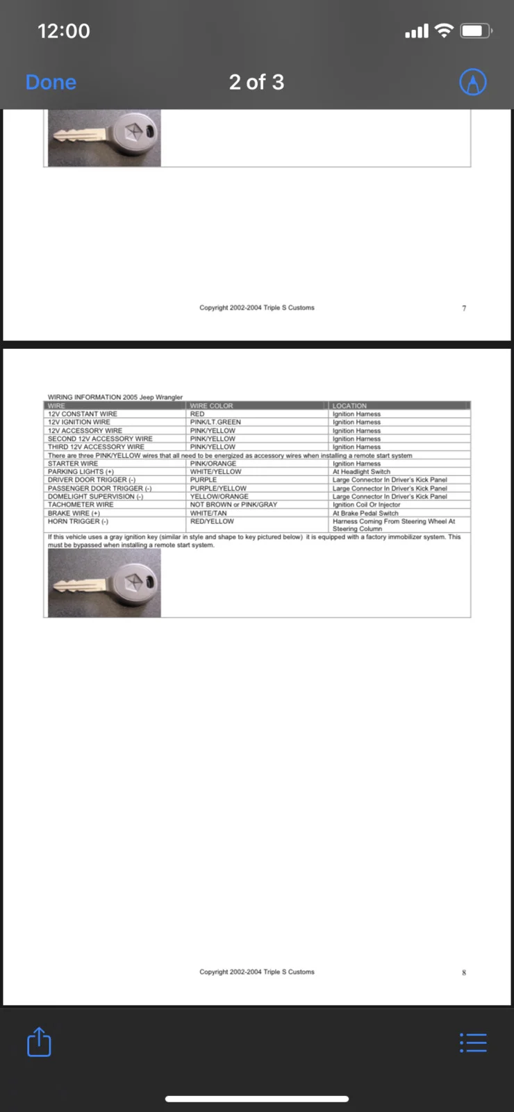

For reference the large red wire is the 12 volt constant, pink/green is the ignition, pink/orange is the starter wire and the three pink/yellow wires are accessory
