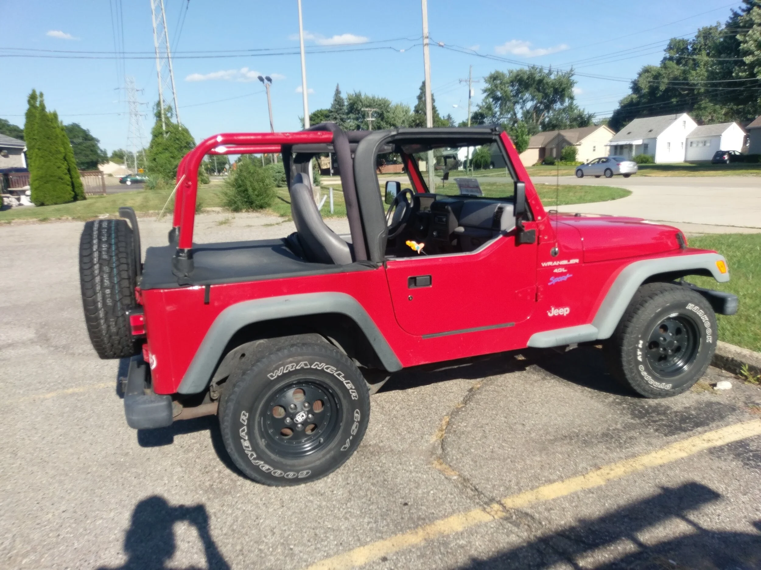

The day I bought it.
I picked up this bone stock 98 TJ sport in 2016. I've had countless jeeps; wranglers, xj's, 4.0's, Cherokees. When I got this jeep I knew I wanted to build it up to be a trail rig that was good on the trails and could drive the kids around for fun to the campgrounds around Michigan we go to. So far over the life I've had it, it's stayed kept up and only driven for fun but within the last year and a half I've been acquiring parts to finally start my build.

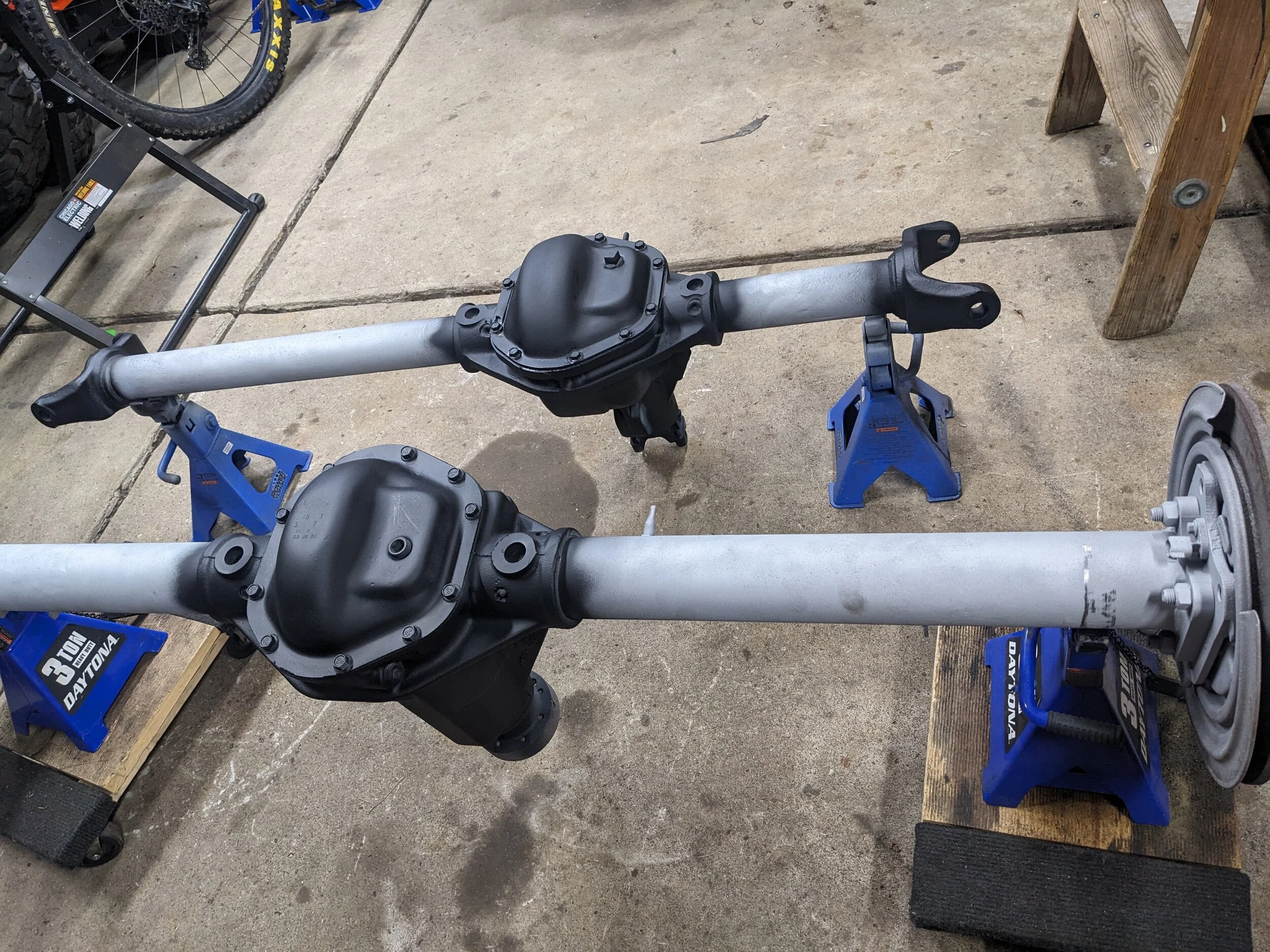

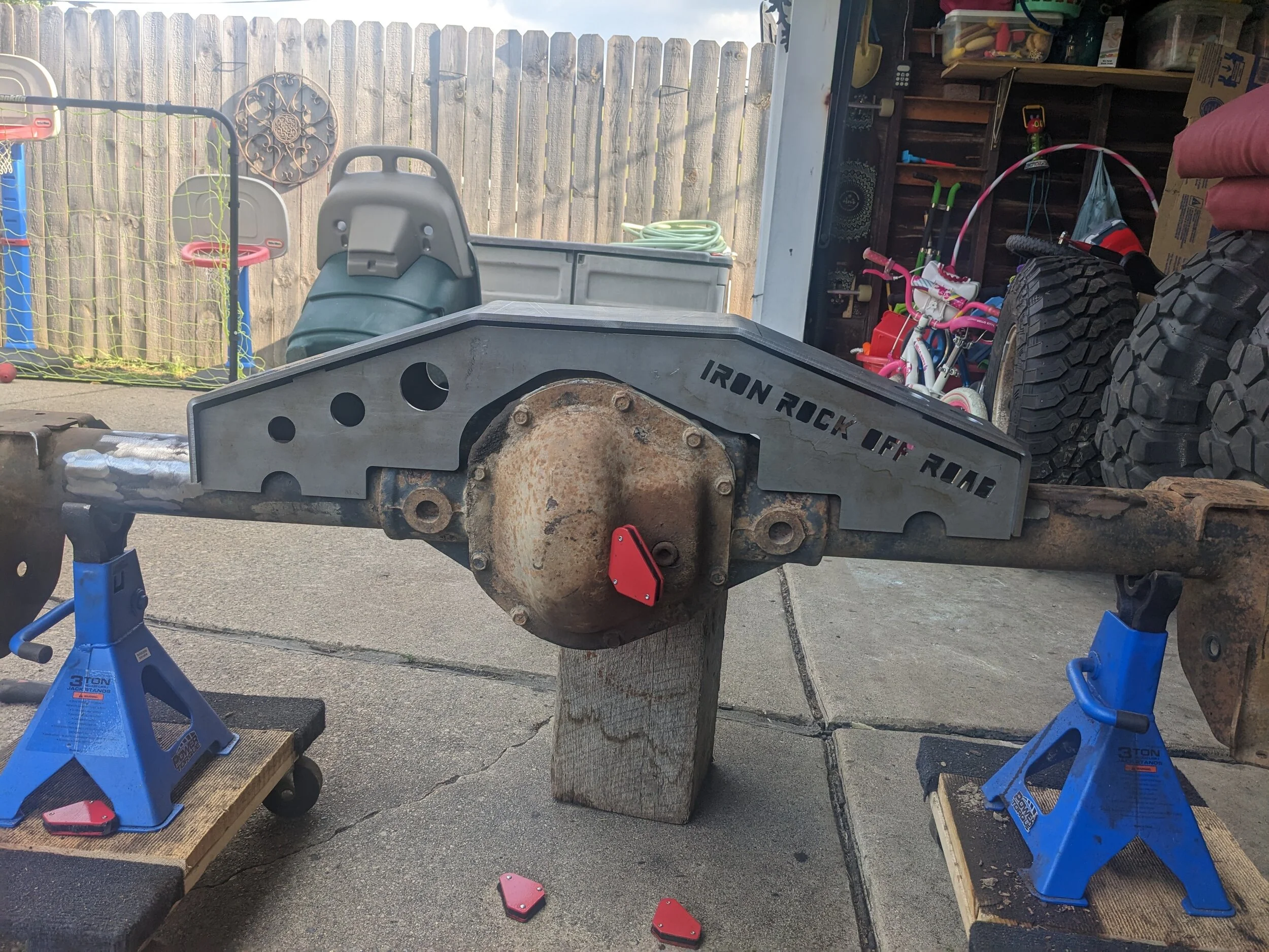

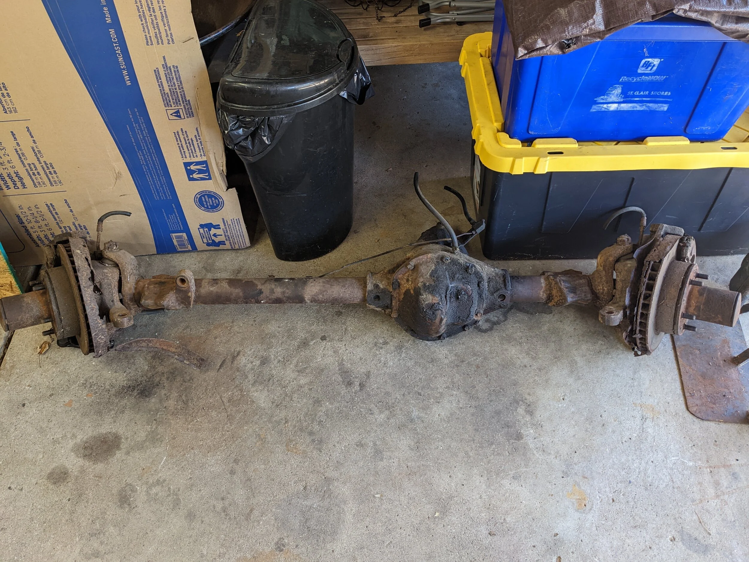

98 TJ, 4.0, Ax15, on a set of 37 bfg krawlers, Raceline beadlocks, Front HP Dana 44 from a 1976 Ford with f250 dual piston 8 lug outers, warn premium locking hubs, 30 spline rcvs , rear jk standard Dana 44 with teraflex full float 35 spline 8 lug wide, TNT front truss for bracketry and front 3" stretch.
Iron rock off road 4 inch long arm kit 3 link/4 link ( front and rear control arms lengthened for stretch) went this route for bent arms, probably would have went another route but it was one of the first purchases, and a big one.
Front steering not established, Front suspension currently 4 inch coils and bilstein shocks, genright rear coilover bracketry, rear 12/14(not sure yet) king remote reservoir 2.0 coilovers, Genright crawler 23 gallon stretch tank, advanced adapters ssye, 1310 joints for driveshafts, brown dog mml, 1inch body lift, and Novak cable shifter.

I've got about 2.75" front stretch and 5" in the rear. I've got the same 23 gallon tank also. I cut my frame and moved the arch back so that the axle is centered in it.

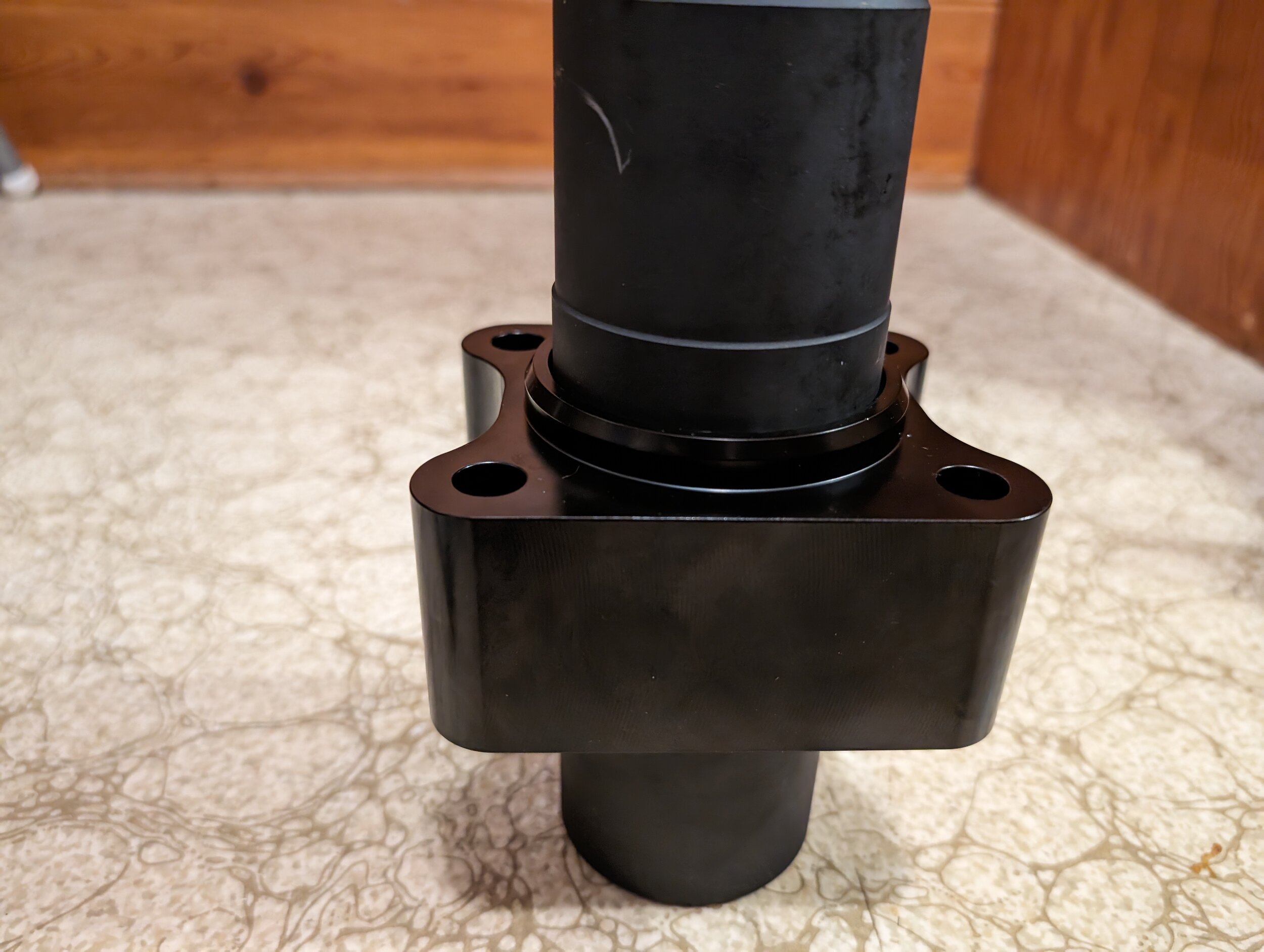

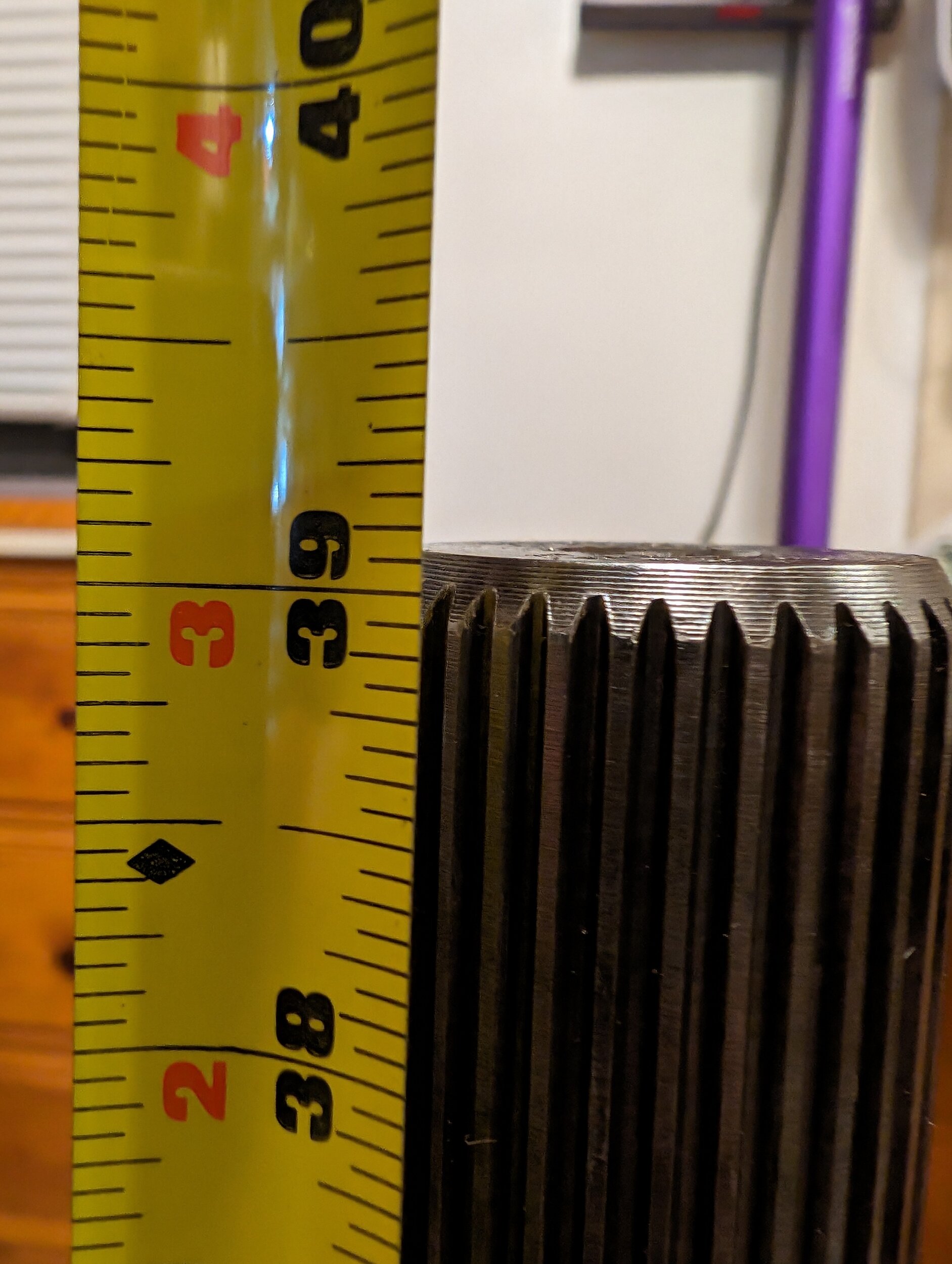

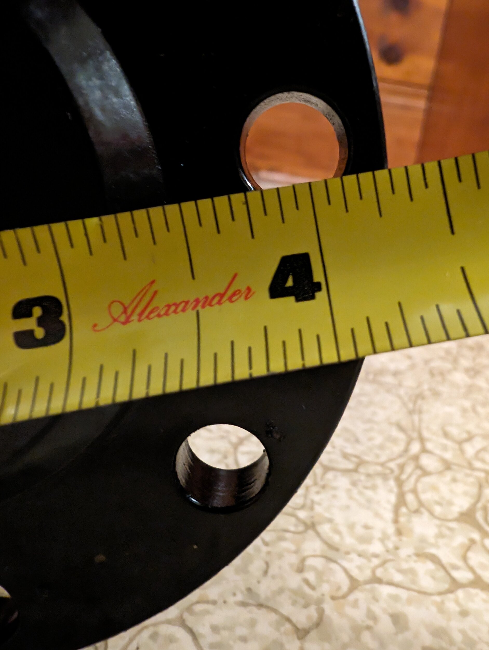

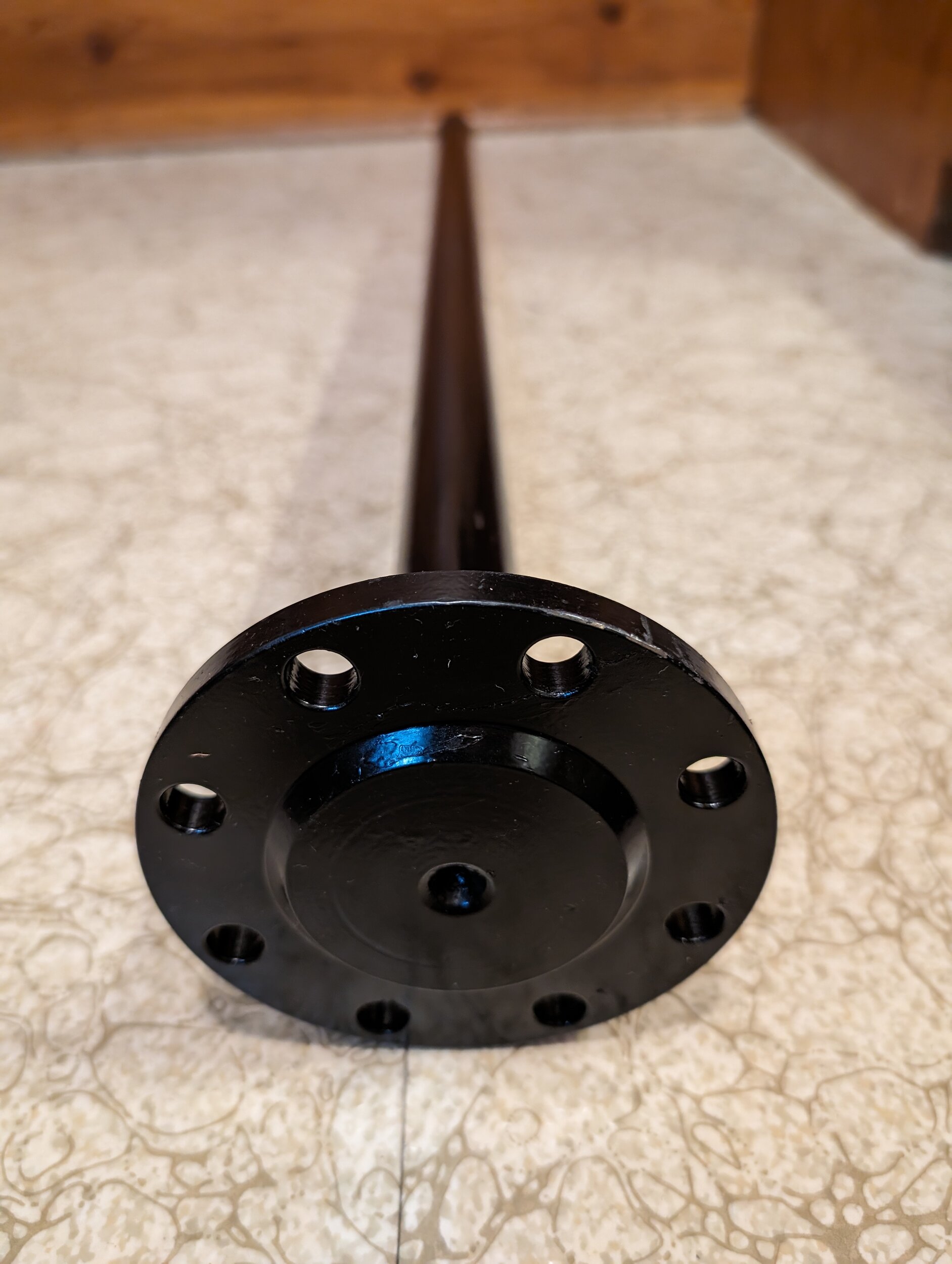

Just got my teraflex full float kit. I don't know about any of you but even if something's not going on Immediately I have to dig through the boxes and see if everything is good, all there, and grab the instructions to start looking them over.
When I originally called teraflex to get some info on the kit I wanted the standard 65inch jk width but with 35 spline shafts. They don't offer 65 with 35 spline only the wide kit so that's what I got. When it got here I wanted to see exactly where that width came from.
Looks like that's it. So it's a spacer that bolts on to the original backing plate. The 65 inch non wide version is just a half inch plate instead of this 2 inch block. Not really any actual info on the difference listed by teraflex. Not a big deal now it's already here.
From the looks of it the 35 spline shafts are just your standard shaft. So it makes me wonder if I could have just bought the standard full float kit and picked up a set of correct length Dana 60 shafts for somewhere like ECGS.

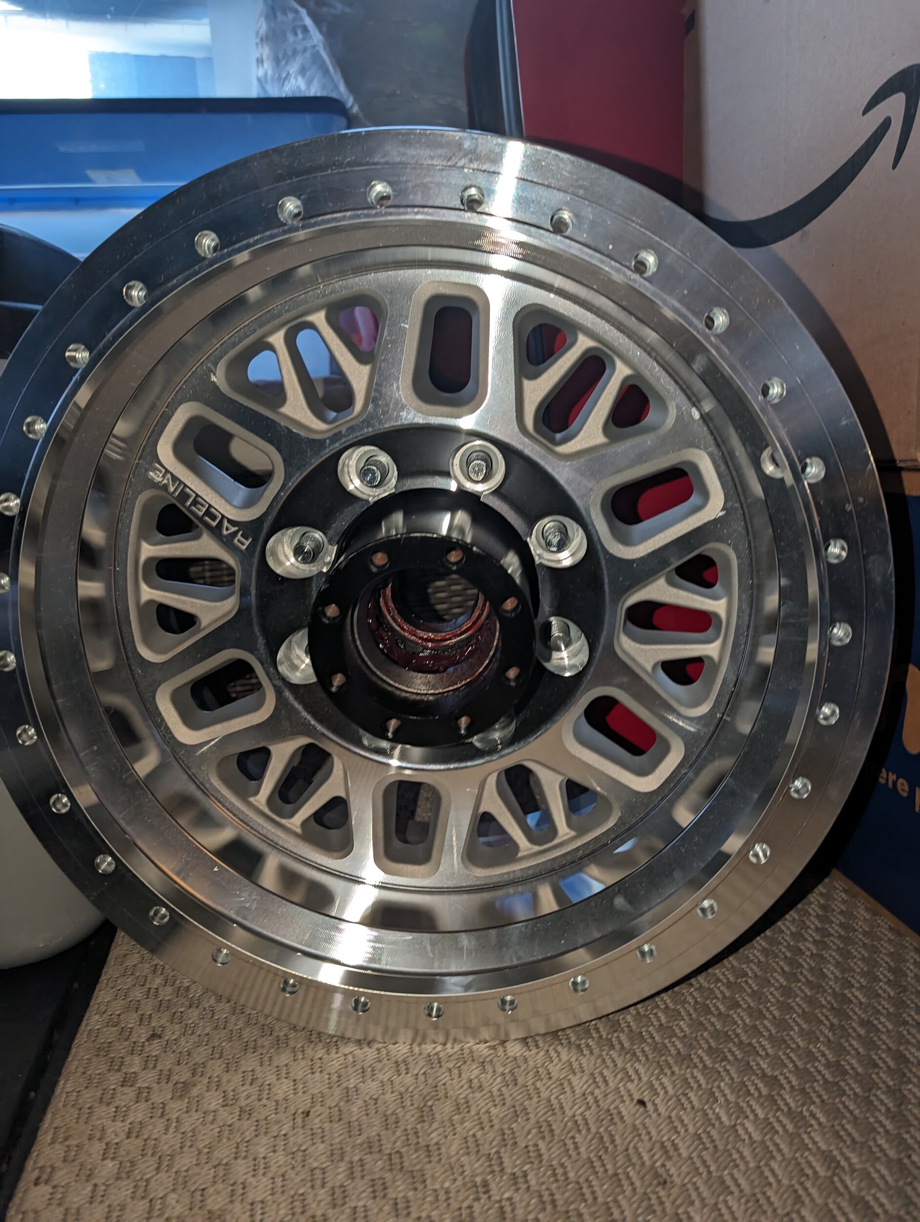

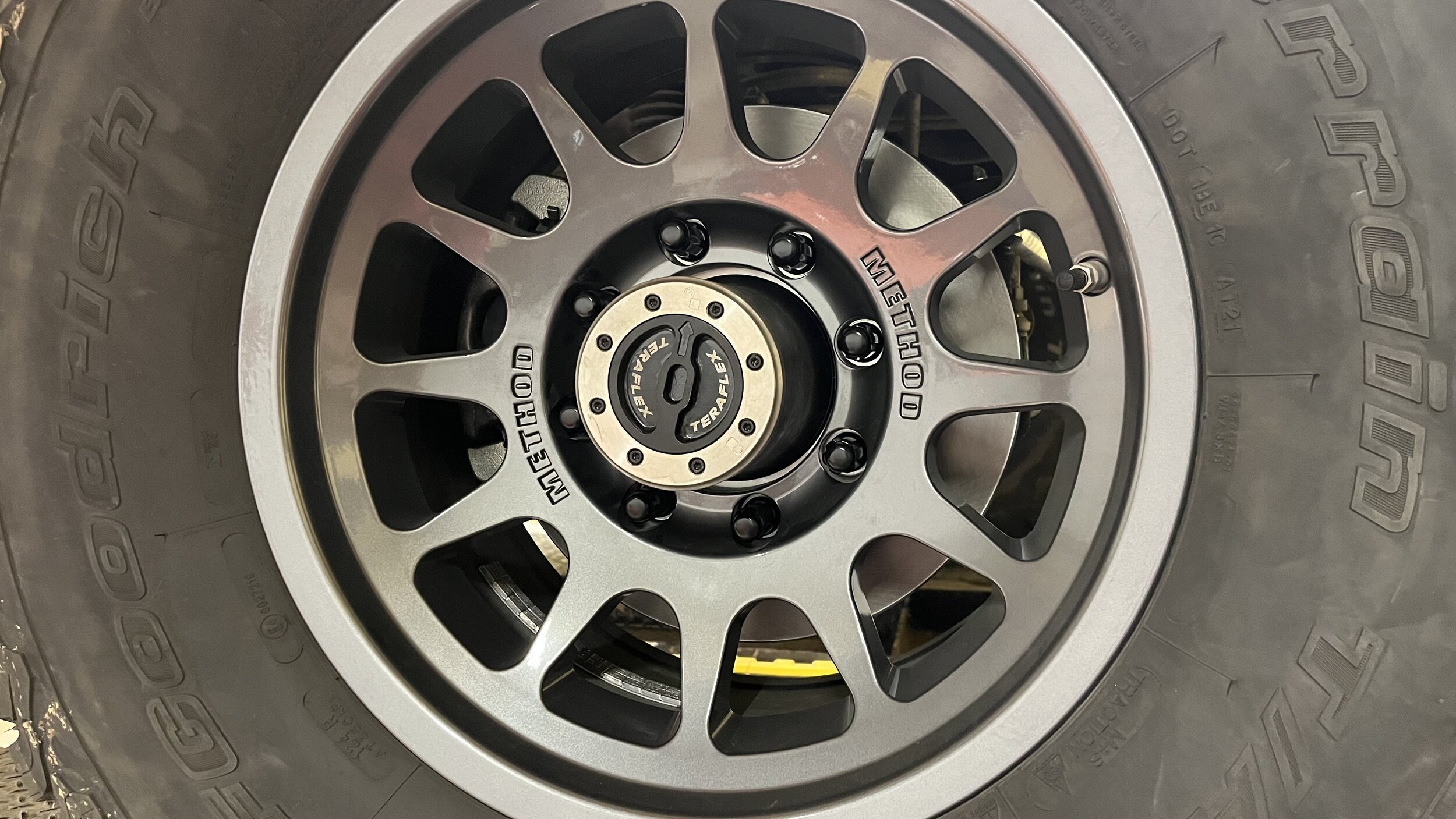

Had to throw the hub in the wheel just to make sure it fit.

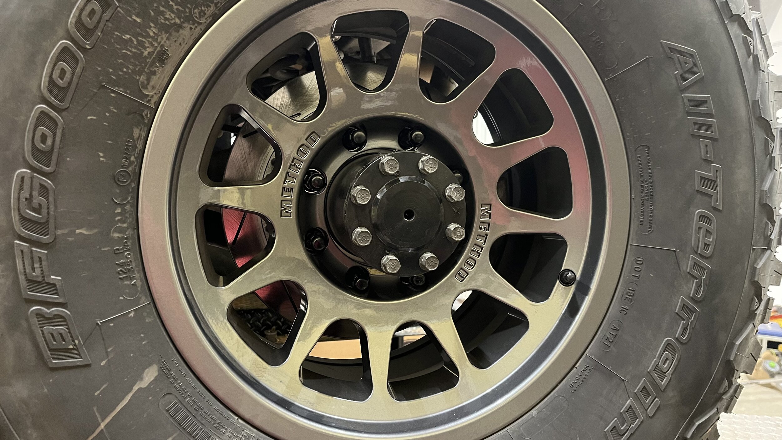

Going manual hubs up front?
Yeah I don't see much on them so I don't mind testing them out. One of the big problems with jk rears is bending the shafts hopefully nothing bends now. As for the front I have a set of warn premium locking hubs.

I had problems with my Warn hubs on my HP44 not locking all the time so I ended up going with slugs. Now I have the Yukon Hardcore hubs.
I picked up a rebuild kit from Jeff's bronco graveyard and it came with them although I have heard about some problems with them they should be ok for the time being. Locking hubs are a big plus because at the end of the day I'd love to have the jeep drive to where I go. Having the hubs disconnect will take off quite a bit of driving stress.

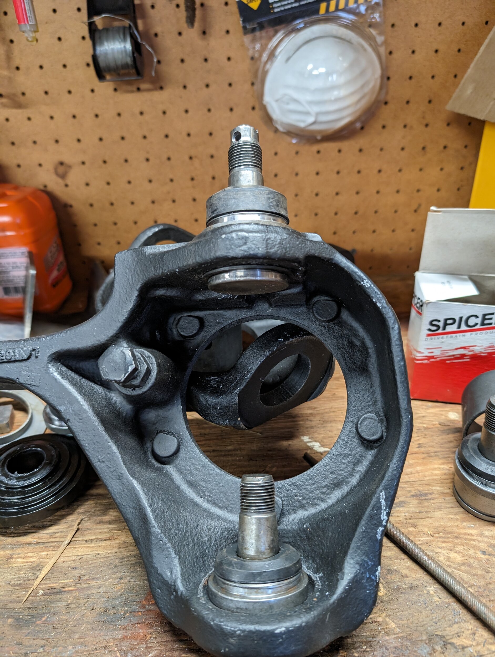

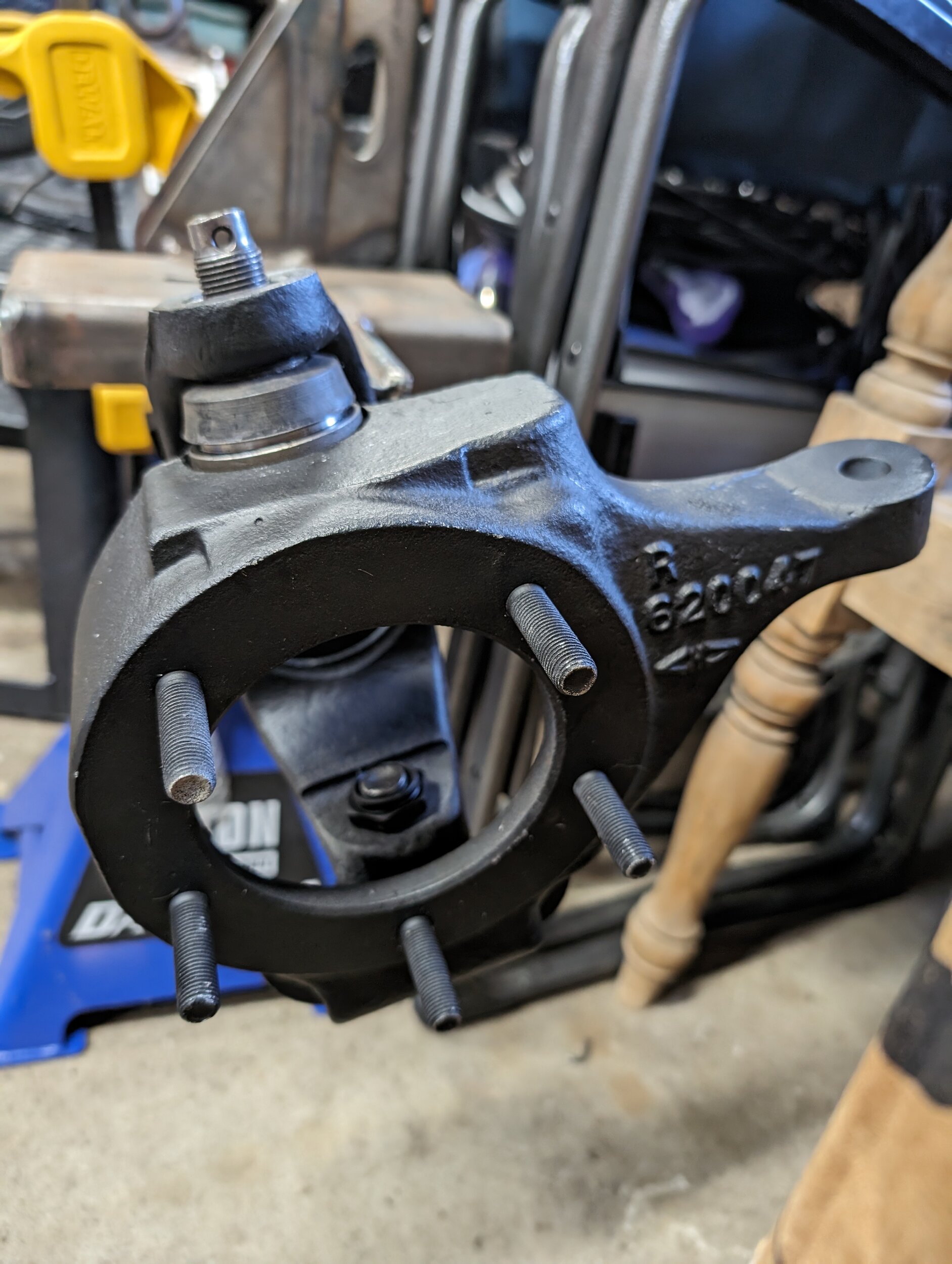

Got some time to sneak in the garage and throw in some ball joints. Kinda sucks Spicer ball joints don't come with clips or the top nut.

I just did the full kits front and rear on my JKUR. I stuck with 32 spline for now since I’m already regeared and still running factory lockers. They make you use the wide kit for the 35spline conversion because it’s parts interchangeability with there Tera 60 axle. You can order the Tera60 housing with a diff and nothing else and the hub conversion parts will all bolt into it I’m fairly certain.
I did the conversion so I could unlock the hubs, carry weight of camping gear better, reduce the likelihood of axle getting bent, etc. just an overall upgrade in load capacity and durability. I’m not out rock crawling the most technical stuff but I do have a family of 5 and we go camping and do MTB trips, and the weight stacks up quick.
