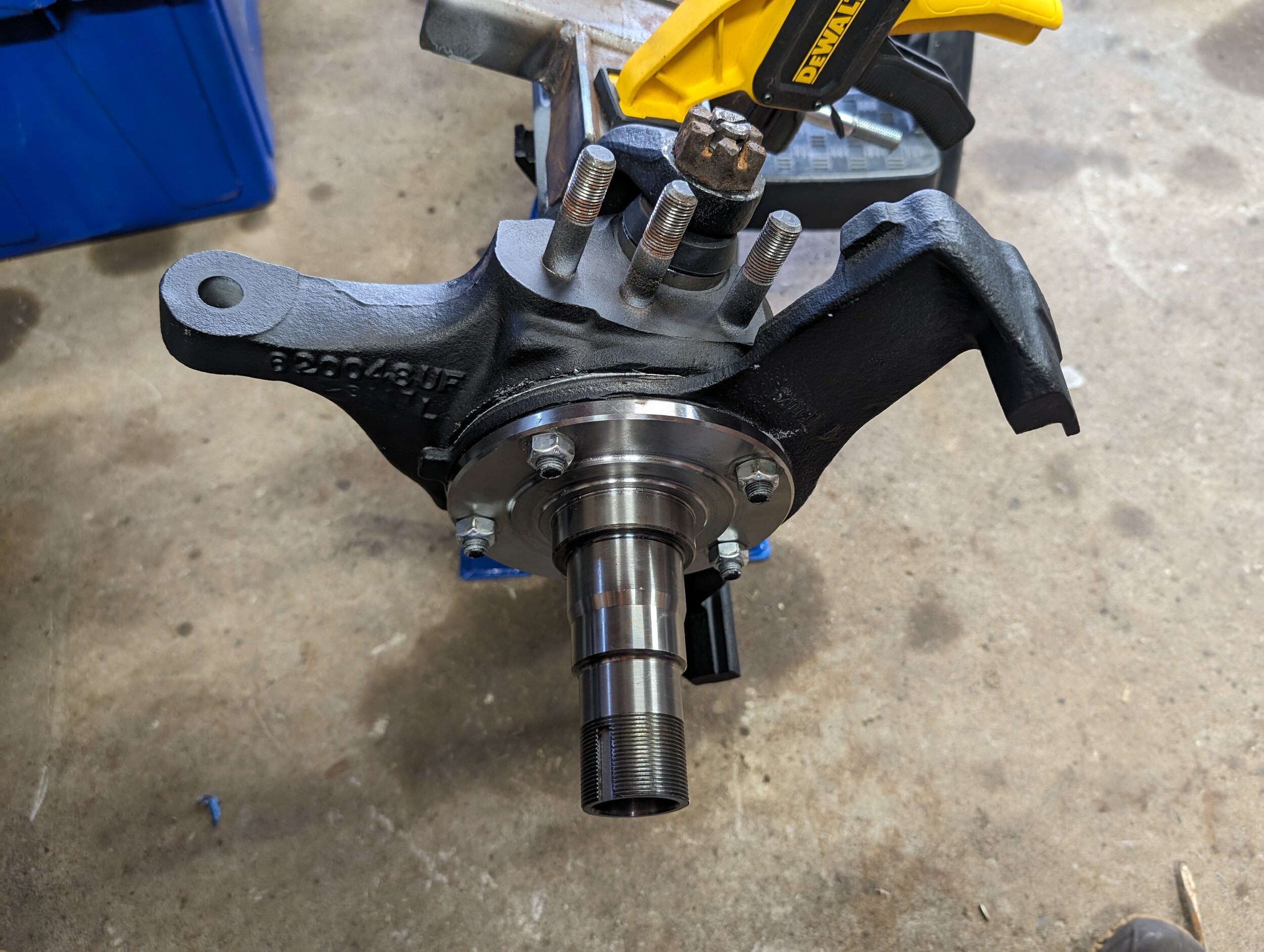

I can’t imagine they’d reinvent the Dana 60 hub and axle bolt pattern. All the parts appear pretty off the shelf except the bolt in spindles front and rear. The front stub shaft is even 35spline. The only oddity there is they matched the ujoint to the rubicon 1350 instead if the standard Dana 44 1310.

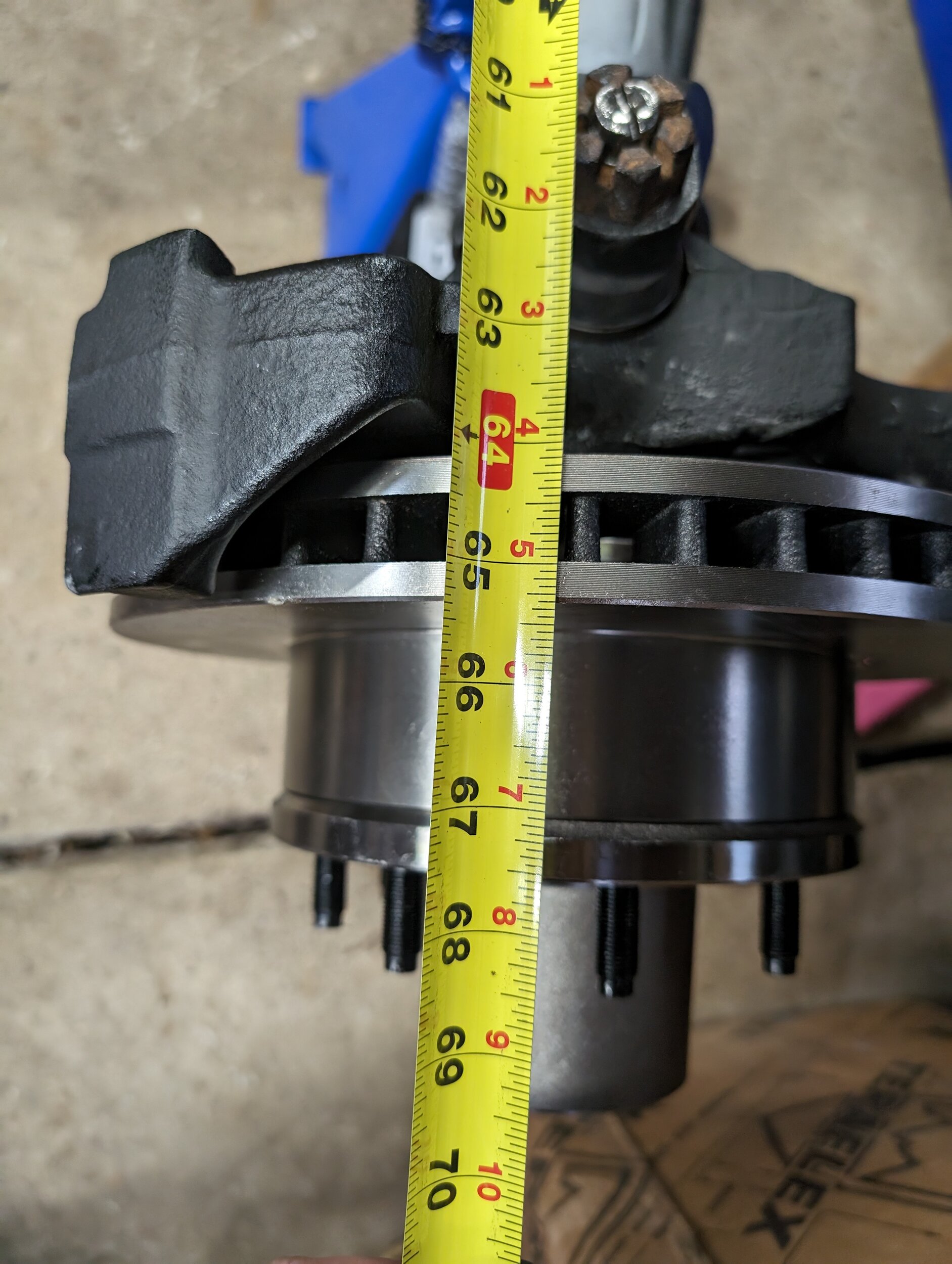

One of the big things I wanted to make sure was that the 250 outers would net me the 67.5 wms I was looking for. Not a ton of info on it without sifting through old Ford forums but it looks like it does. Now hopefully the stock 150 outer shafts will work to get everything tested before I buy new shafts.

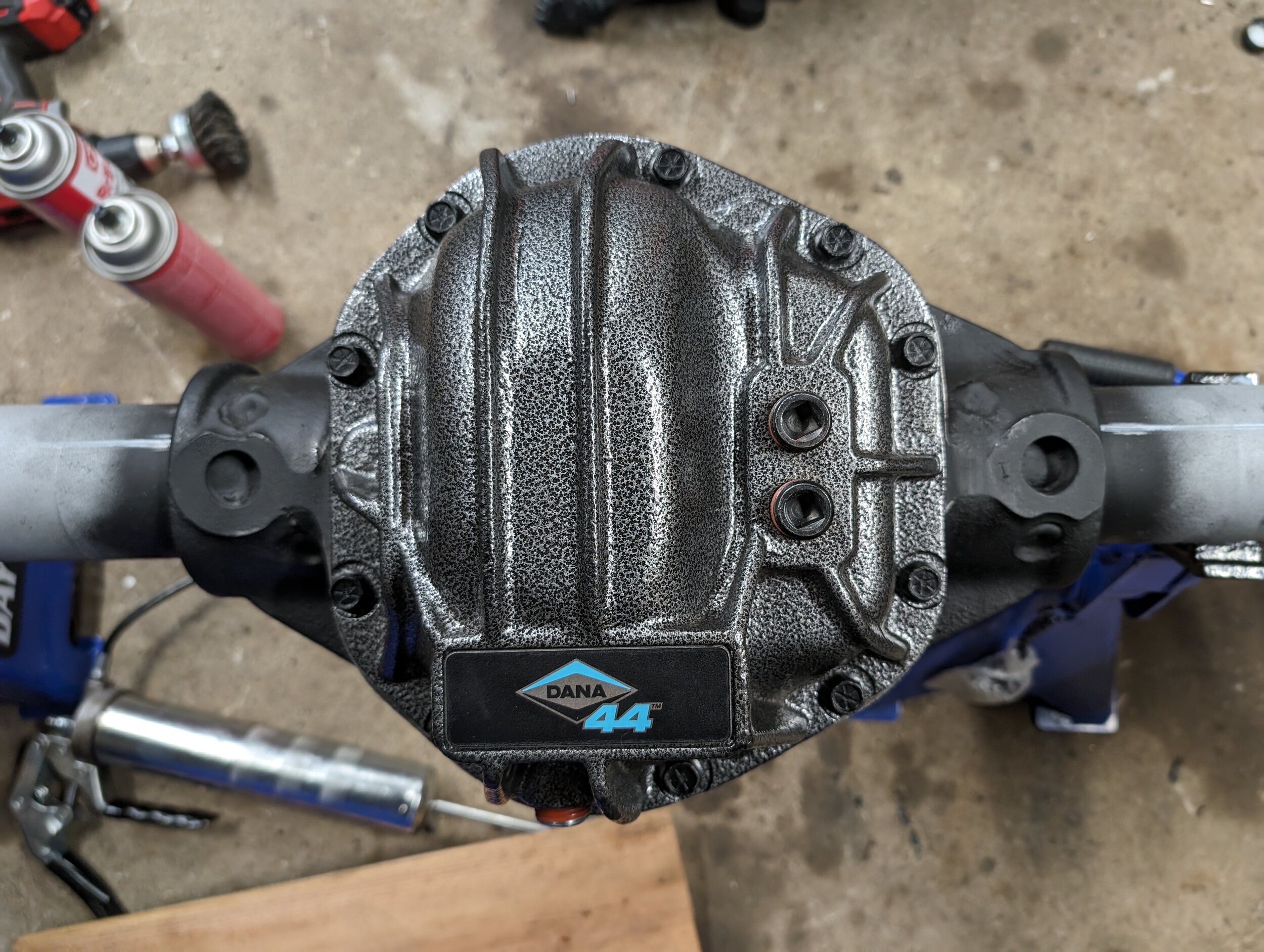

I’m really liking his build. D60s really can be overkill in a lot of situations and I think a well built Dana 44 is really good when done right like yours.
I had a YJ on 38s and fuel injected 350/350 Chevy V8 and a fully built hpd44 held up great even when I’d give the skinny pedal in the rocks. Great ground clearance too.

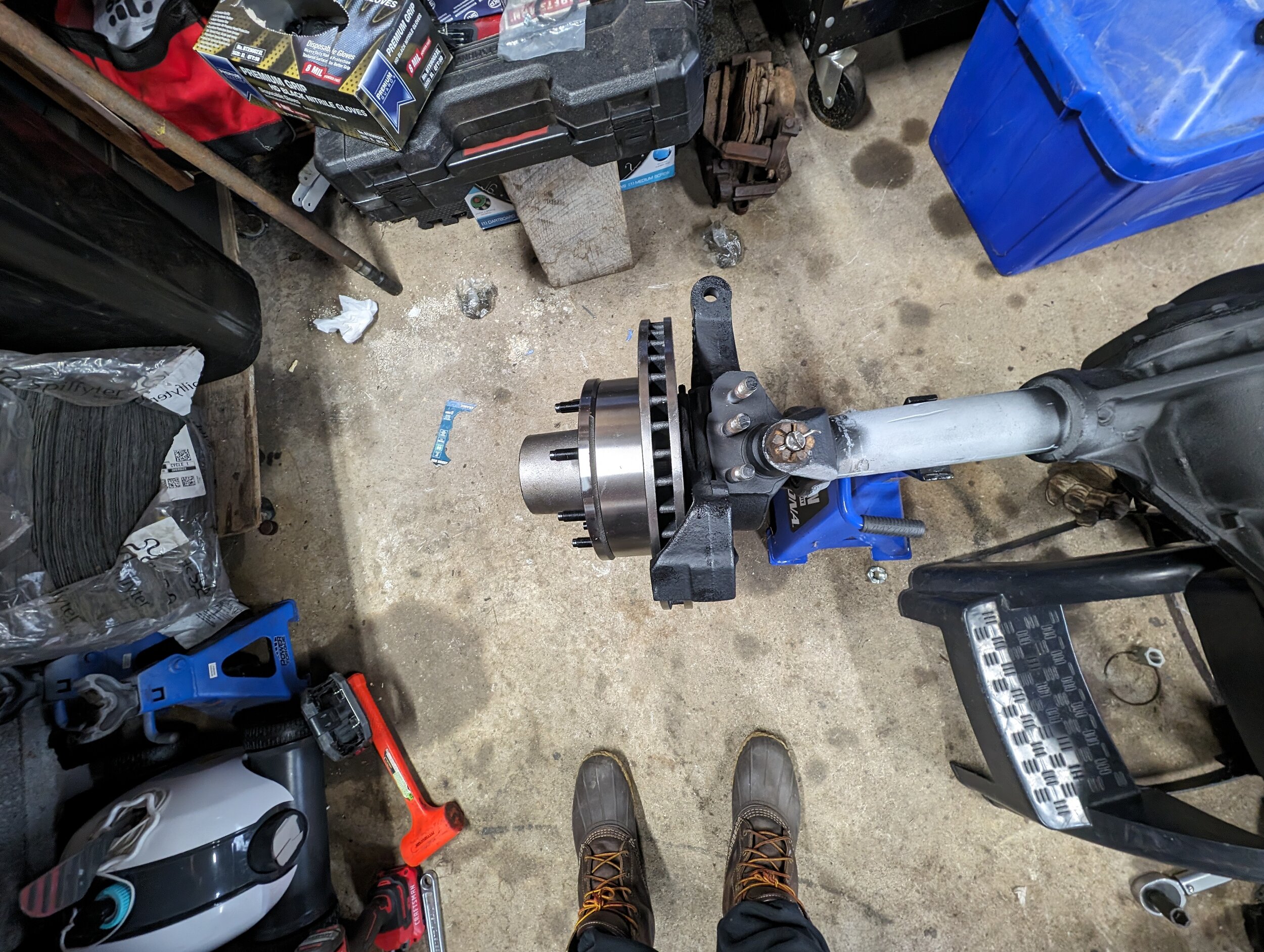

Yeah I wouldn't want to do that. I have a fresh pair of Spicers in so if I get 2 years out of em I definitely say it's worth the 80 bucks I spent on rockauto. Currently I just have stock shafts that I'll use to test everything but plan to just go right to rcvs once I can afford them.
