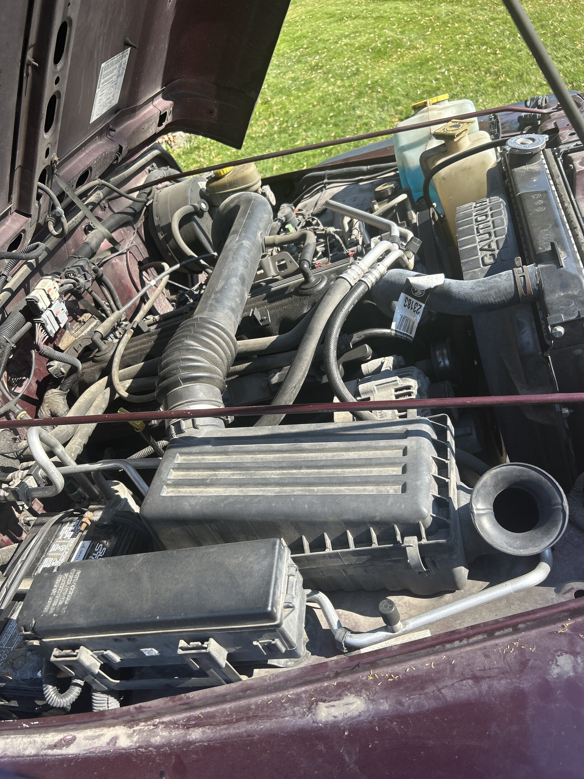

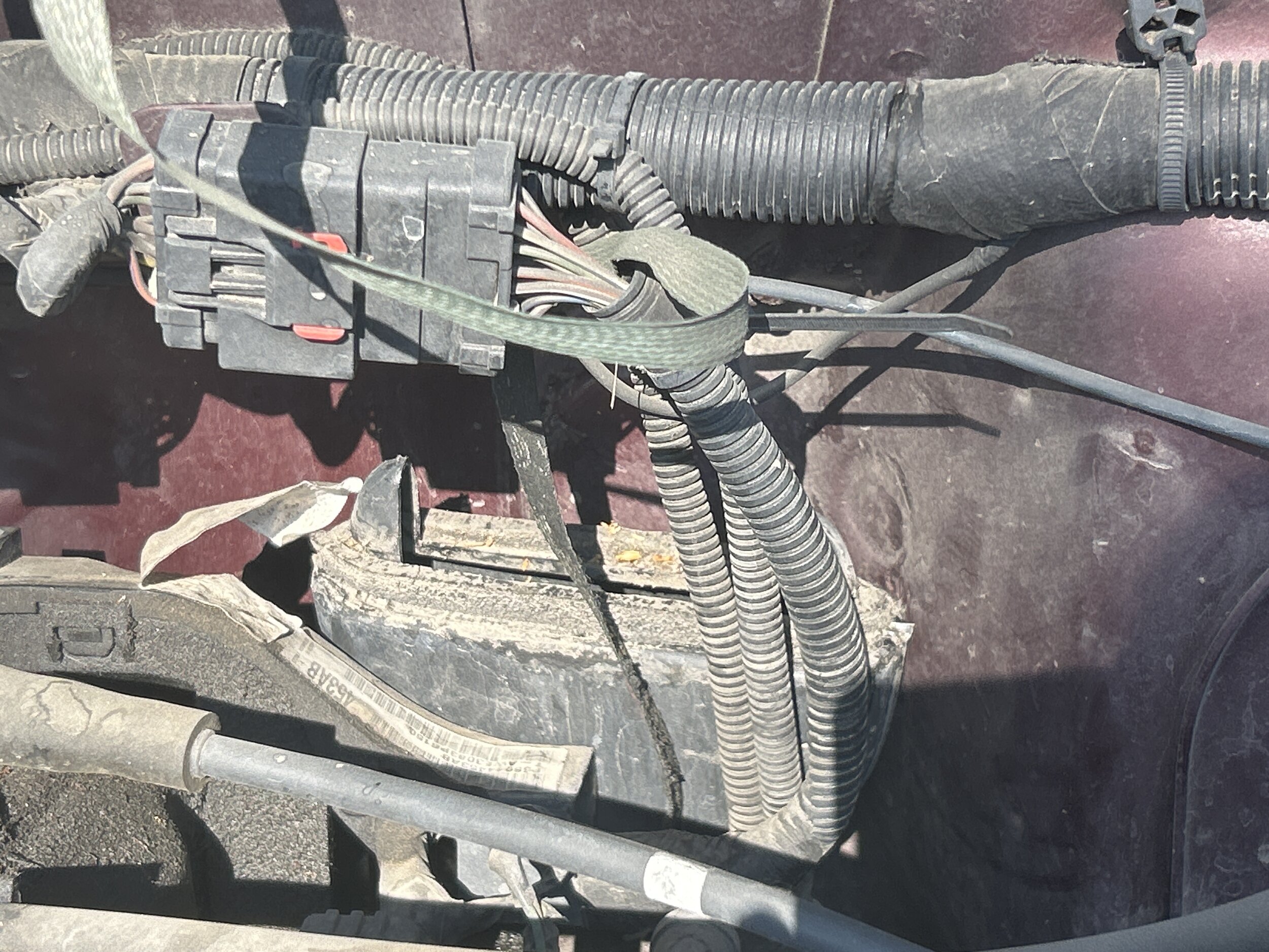

Not sure what to look at. It seems good. One thing I noticed is the workmanship may be a little sloppy? The fresh air vent is just hanging there. See photo.

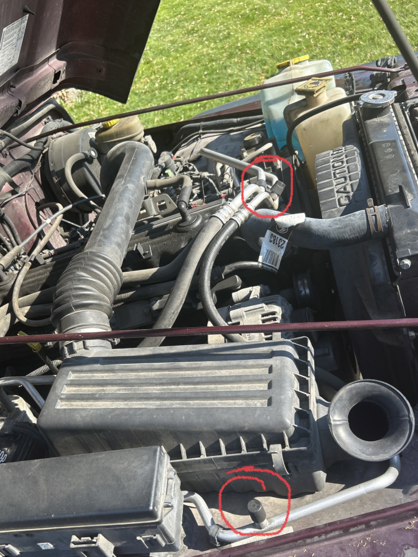

The service ports are circled if you remove them see if you see some leakage there or did they just forget to service it.

The service ports are circled if you remove them see if you see some leakage there or did they just forget to service it.View attachment 541748

The valve was probably the shrader valve these are the service ports under the caps where the gauges hook up. If he replace all the A/C hoses, the schrader valves are part of the hose. He should have put the Accumulator and the o rings in it. I don’t know why the A/c hoses were replaced if the A/C was functioning properly. I would think the coolant hoses were replaced. Is the compressor still making noise? If it made noise and went away it could have been some liquid refrigerant in the compressor. I would think he needs to diagnose the A/C system and discuss what it will take to get it back to the way it was. If you have a invoice and take a picture of the parts I can look at it and see what was actually replaced.
