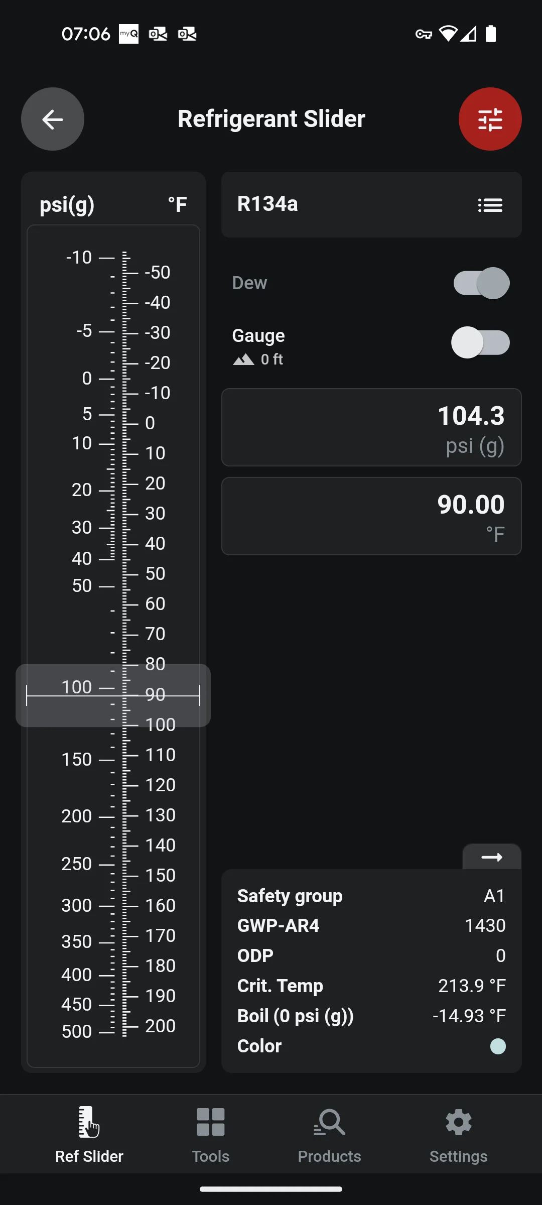

Some of your described behavior lines up with that of a system with "noncondensibles"... An easy way to screen for this is to let it sit for a while until the system equalizes and reaches ambient temperature, and then check the pressure. Both sides should be equal and line up within a couple degrees of the saturation pressure associated with the ambient temperature for R134a (you're looking for the pressure at which ambient lines up with the boiling point). Danfoss Ref Tools or Bitzer Refrigerant Ruler are both good, ad-free smartphone apps that will easily show you that association.
Thanks for that diagnostic check idea, and thanks for the app reference - very useful! I just downloaded the first one you listed.
No problem! I used the Bitzer one for years but found out some of my colleagues were using the Danfoss and I've switched to it, as the interface just feels better designed for switching back and forth between refrigerants and toggling different options, etc. Plus I don't mind the red on black color scheme. :ROFLMAO:
