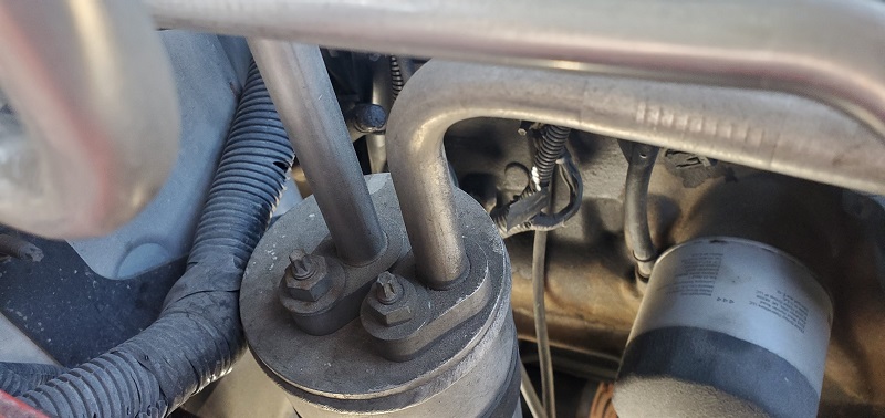

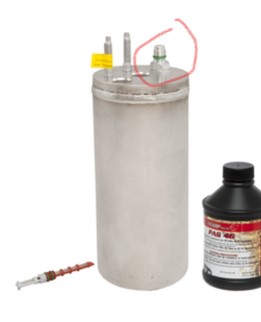

I also figured if I am going to evac the system, I would replace the accumulator/dryer. Every part I find online or in the store has the low-pressure switch on the accumulator/dryer. My switch is inline on the pipe. Even the service manual shows the pressure switch on the accumulator/dryer. Any experience with this (2005 LJ)?
All the parts I find have the port for the pressure switch.

Something doesn't add up. If the compressor is engaged, pressures are within range and you're seeing condensation that points to the refrigeration circuit working normally. I would be looking at the blend door, but you say it's working...are you sure?
Does the air velocity coming out of the vents seem normal? Have you pulled the blower motor to make sure the whole box isn't clogged up with leaves or something?
Welcome to the 05 and 06. Lots of little differences from the previous yrs and the FSM wasn't updated.

Air velocity feels normal. Blower motor is clear. I ASSUME blend door is working properly because I can turn from cold to hot. But....Thinking about it I probably need to verify it is closing fully. How do I check for full closure?
