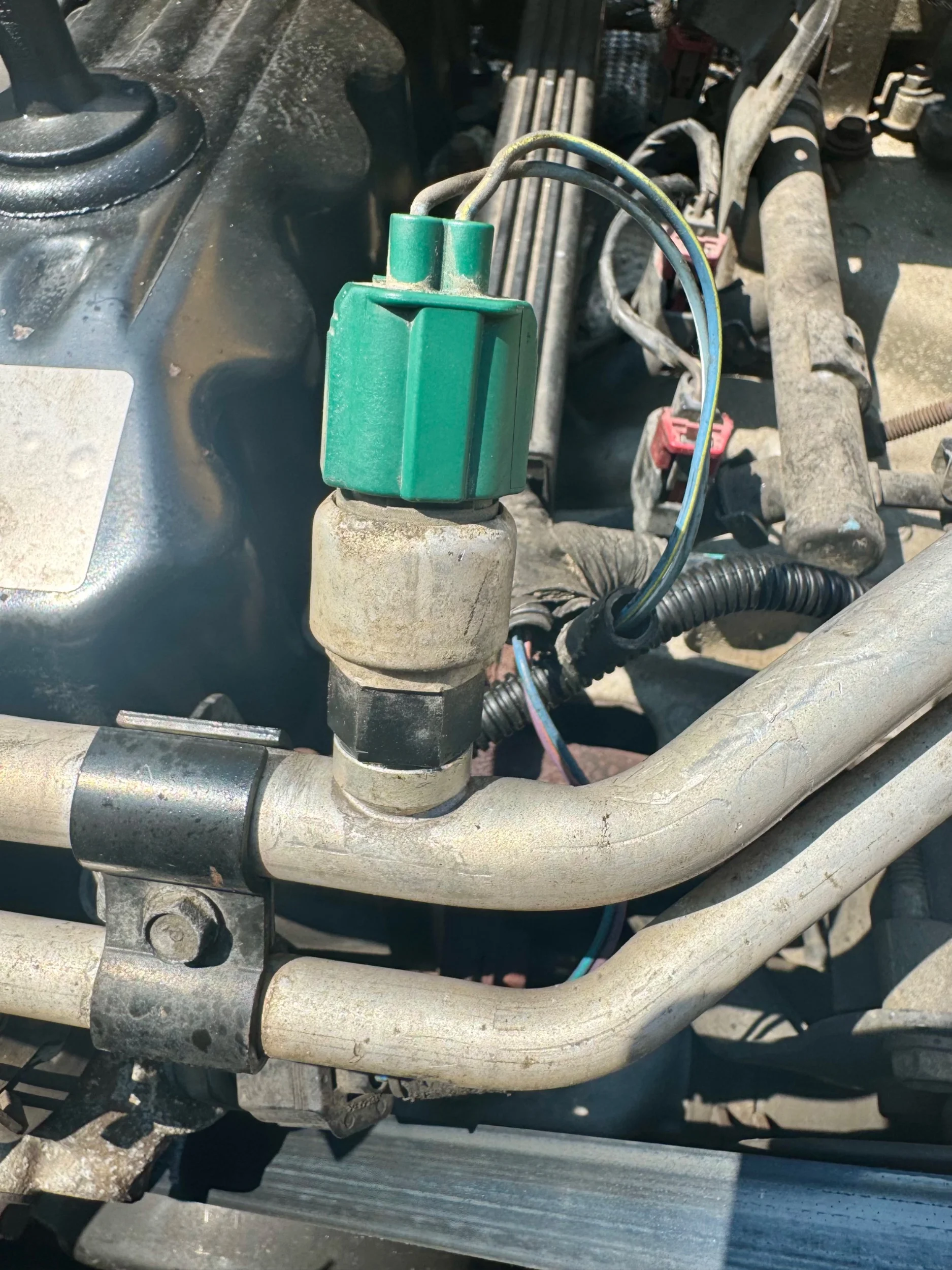

was not sure that i believed this mechanic so i spent a few minutes later in the day troubleshooting by jumping the low pressure switch plug with a paper clip and came to the conclusion that hopefully a low pressure switch might be all it needed since the compressor kicked on.

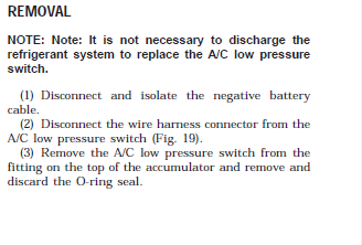

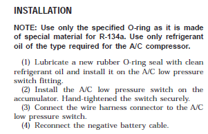

parts store had to order a new low pressure switch which i picked up and replaced old with new yesterday after work. lucky for me the a/c is blowing cold again.
