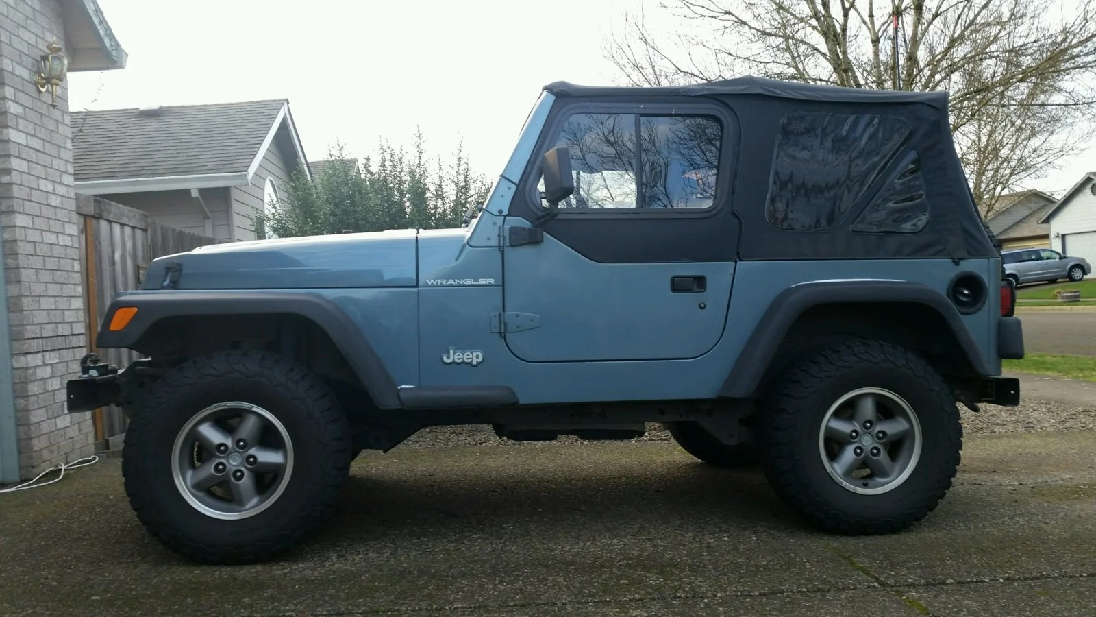

Yes, I think that TJ's look good on small lifts, mine has a set of H&R spring that lifted it about an inch and a half, and they do really well on the street and on the trail. I also run 31" tires and the difference in appearance is noticeable. I did mine for off road performance reasons and increased capacity. Works great, but then I've got an SE and 4.10 gears.
On a side note, those half doors look killer on your TJ @StG58.
