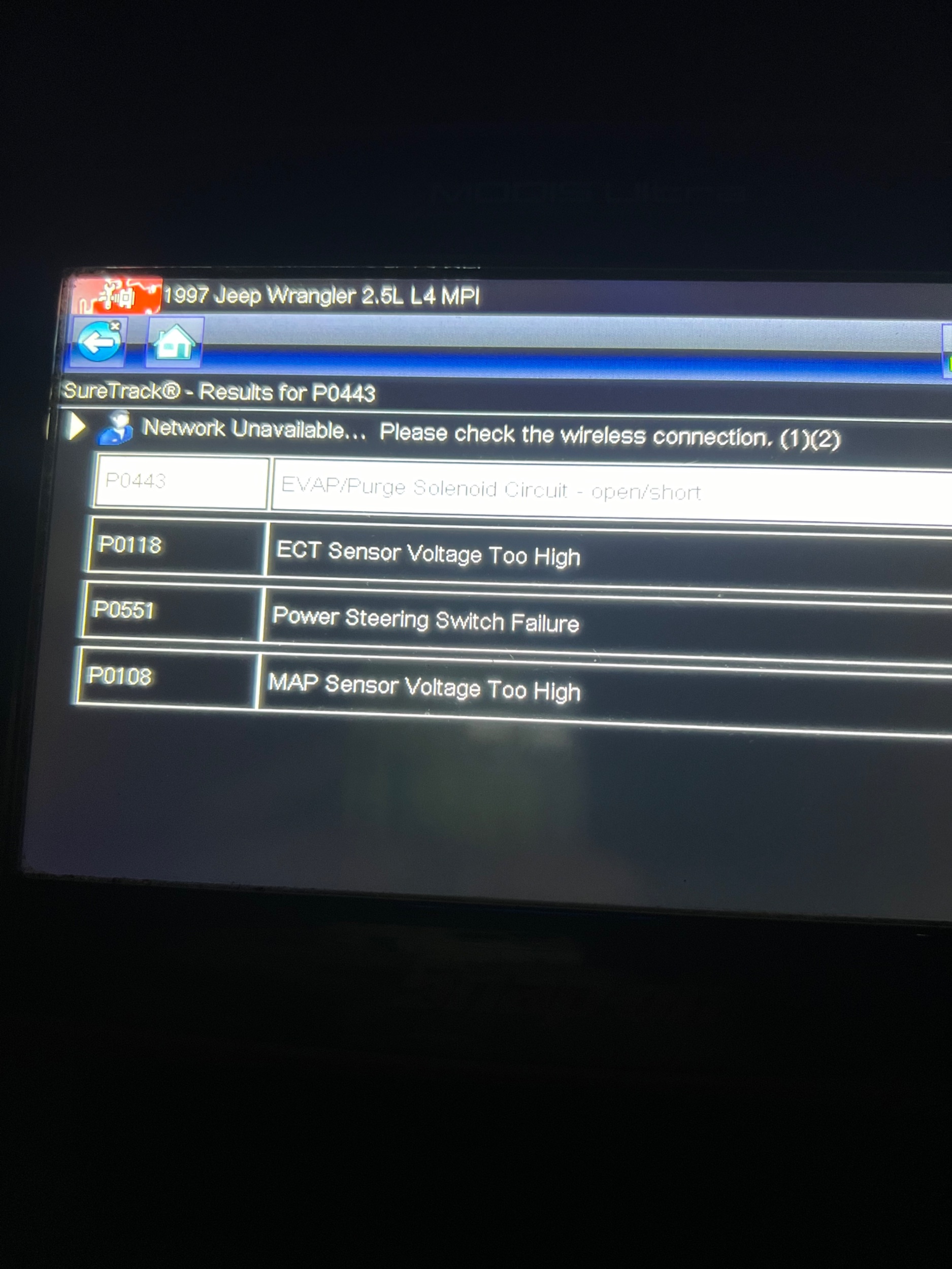

I agree. I don’t think it’s a positive read. I think it’s a false read causing the rich condition. The cherry red exhaust and worsening performance issues with rising temps leads me to believe it’s actually lean but signaling rich thus making the lean condition worse. What the hell is causing it tho ??? My O2 reads are good bouncing between .08 and .68 steady. The MAP is reading right. 1.5 at full throttle. The intake air reads about 165 degrees today which seems legit. The coolant sensor is reading 210-215 until the lean AF mix causes the motor to heat up. There’s prolly some damn simple explanation but I just can’t see it. It’s driving me crazy.
