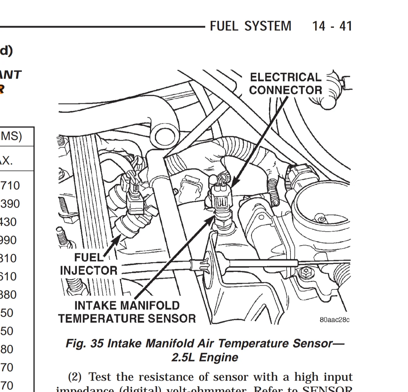

WHERE THE HELL IS THE INTAKE AIR SENSOR !!!
It is a '99 right? Metal sensor threads directly into the manifold. Later models went to a plastic sensor in the intake tube.
It’s a 97 but sweet. I thought that was it but someone eluded to it being in the intake tube. Which I didn’t doubt because on newer cars that’s where it is. That seems a horrible place to put it 🤷🏼‍♂️. Looks like it would be better in the intake tubing. Looks like it would leach heat from the engine and get shitty readings.

The 97 TJ only has one in the thermostat housing. The intake air temp sensor was the one that had me stumped cause it was put to me this way “does the piece of crap aftermarket intake you installed still utilize the intake air sensor?” Sooooo I was looking all over for it to be in the intake air tubing. Turns out it was in the manifold. I found that one and knew what it was but was assuming there were 2 or something. It was just bad intel. It happens.
