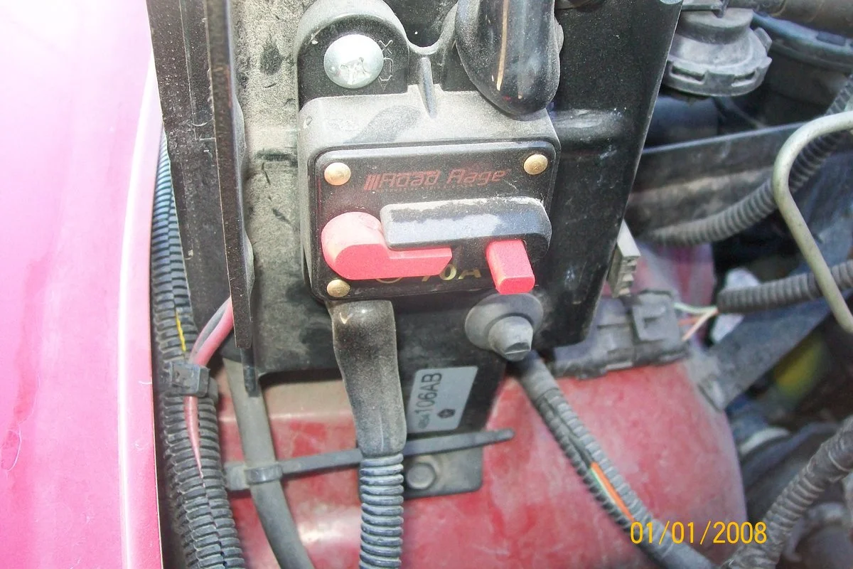

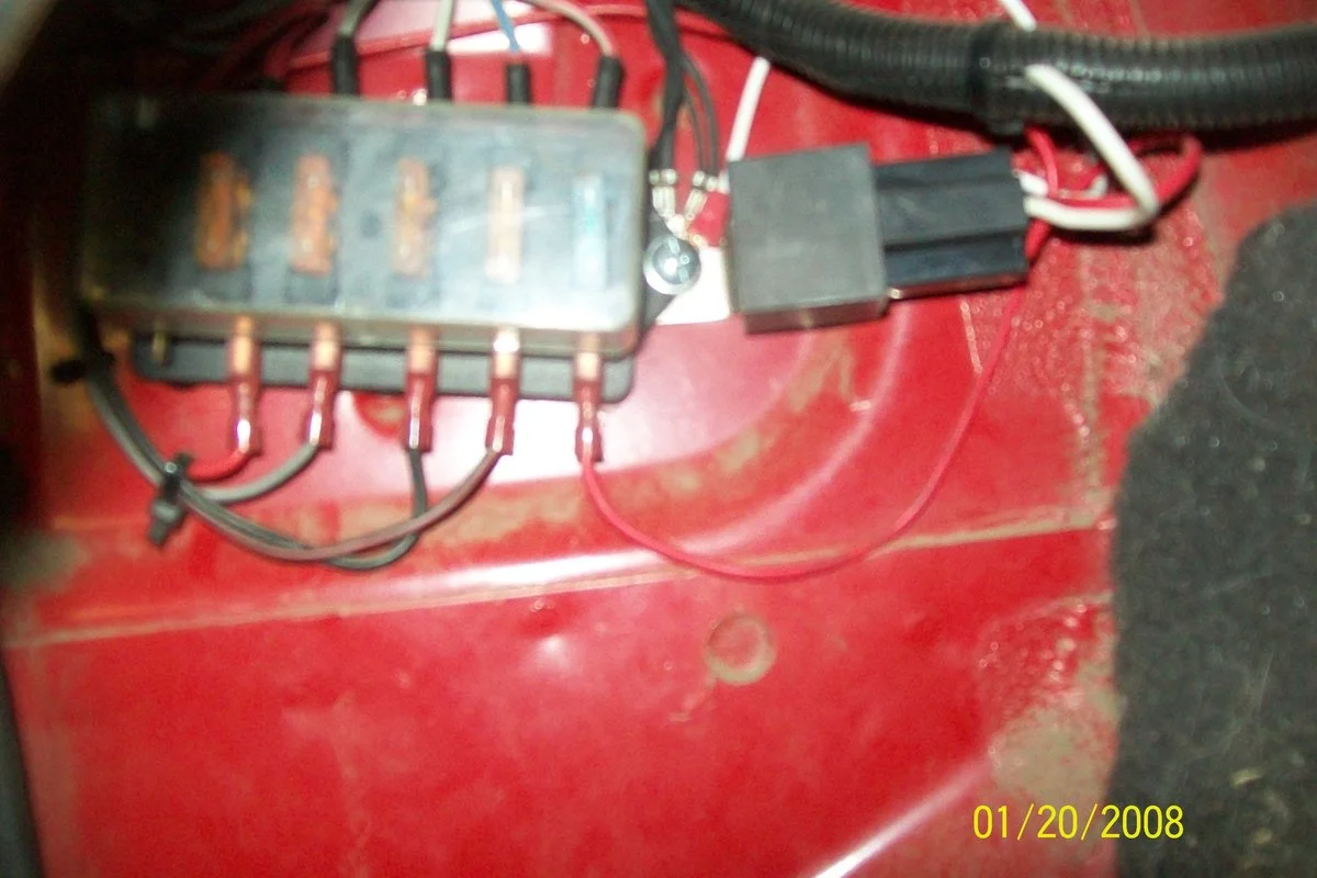

Here's what I have: This is mounted on the tray below the master cylinder. Power runs through the firewall, to the switch panel, through individual fuses, and back to the relays and to the lights
A 10ga. wire runs from the battery to a Circuit breaker to here.

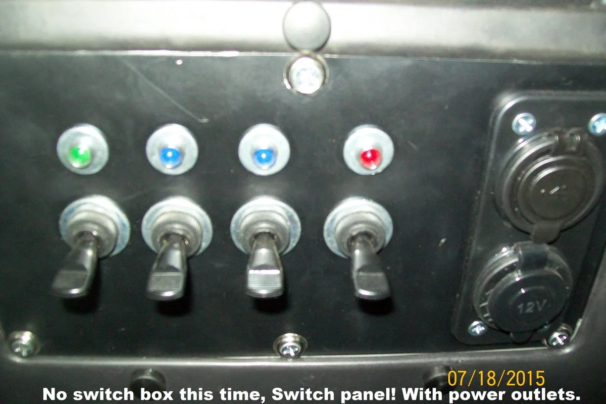

Through the firewall to a switch panel
Each switch has it's own fuse too

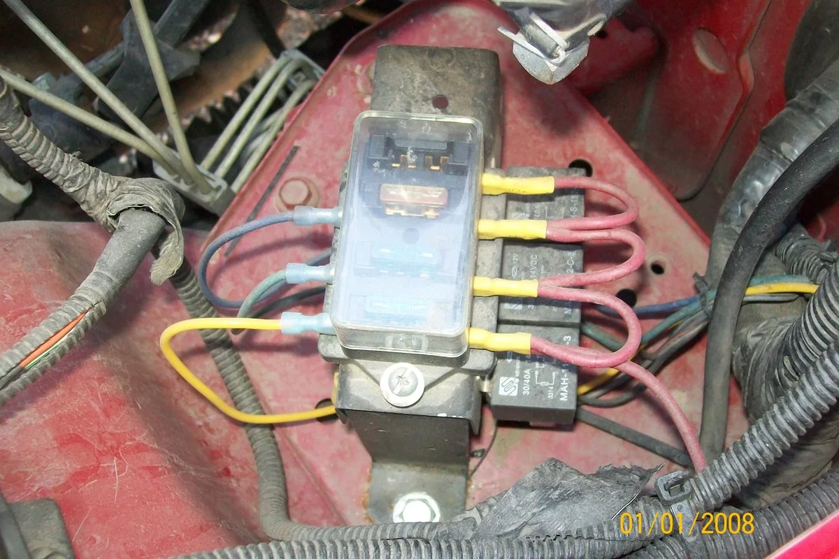

The relay here is for the back up lights.
I hope this helps. Any questions please just ask.
A 10ga. wire runs from the battery to a Circuit breaker to here.View attachment 139375
Through the firewall to a switch panel View attachment 139376

Hi, in my opinion independent fuses for the switches is a bit of an overkill (not recommending you to not do it but I wouldn't), you can supply 12v to all your relays with 1 fused line and activate the relays using GND instead of 12v (which is the correct and safer way to do because all of your individual switch signals in case of a damaged wire are GND signals and will cause no sparks when touching a metallic ground source), and use independent fuses for all of your accessories connected to the switching side of the relay (led bars, flood lights, audio equipment, etc); this will allow you to have different amperage fuse according to the accessory needs.
The only disadvantage will be if your relay fuse is blown you wont have control over any of the relays until you replace it (relays don't use that much current so if your connections are correctly made and protected you shouldn't have any issue).
This is only a recommendation but what do I know... i'm only an engineer 🤷‍♂️👨‍🔧
That sounds good. Did I mention I'm crap at wiring? :) Let me see if I understand what you're saying.
The control circuit would go from the positive lead through a fuse to all the relays. Then the ground side of each relay would go through a switch then back to ground. Is that right?
If I do that right, I think the LED in the switch should still light up.
Yes, you got it right!, just remember to add the individual fuse to all your outputs (accessories); the led on the switch should still light up, keep in mind that LED's are polarized so if the switch works but the LED does not light up try and changing the polarity of the switch connection / switch LED.
Reactions: fuse
Thanks! This is going to make the wiring much cleaner and easier because I'll just have one fuse for all the switches instead of individual fuses for each one.
And, yes, I do plan to have separate fuses for each of the accessory circuits.

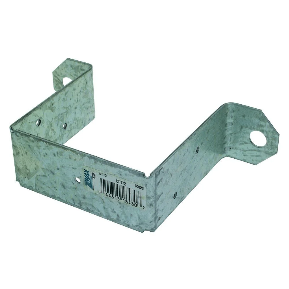

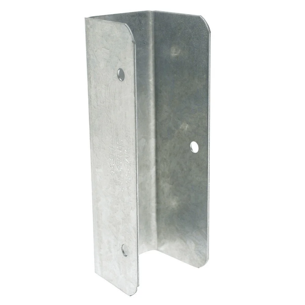

Here's what I mounted the relays and fuse holder to:
These are lumber tie ins from Home Depot. The holes on the top piece line up with two of the holes on the tray. The bottom piece sits down over the top piece, and a fuse block mounts to the top of it while the relays mount to the side.
While I agree that fuses for the switches might be overkill, it certainly doesn't hurt. And while not an engineer, in a former life I was a U.S. Marine working on combat aircraft, and they were always wired hot.
Reactions: fuse

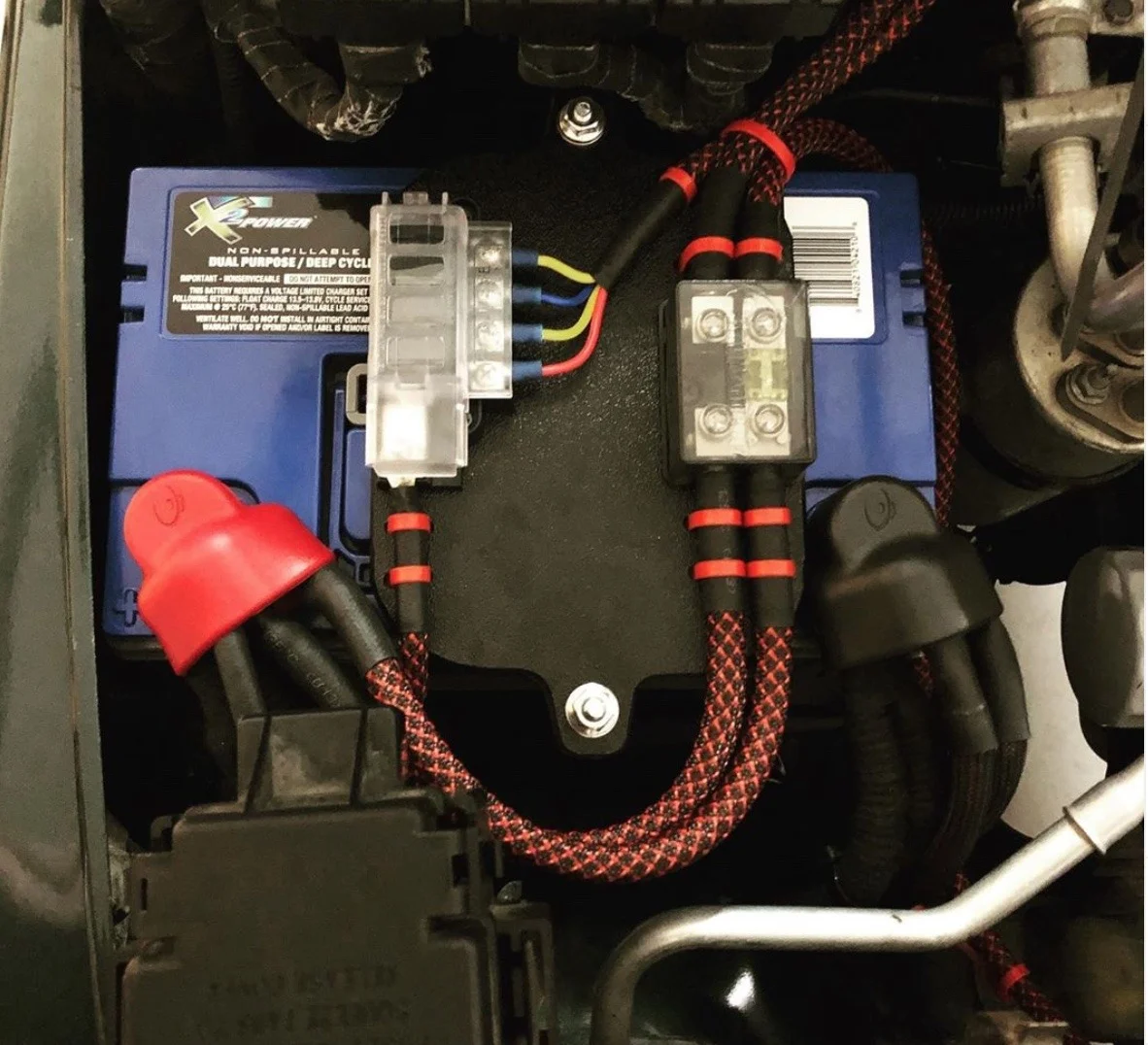

Nice work fitting off-the-shelf hardware to the existing tray! I really like how clean the finished setup is!
For a newbie could you describe what I'm looking at?
Is the black/red wire loom and the red zip ties your custom doing?
Learning about how to wire in any accessories.. love the look of this
Yes, all the black/red work is custom. I replaced the existing battery terminals and added my own aftermarket wiring to the stock wires. I added 4 guage cables to the existing stock runs for a Big 3 upgrade and also for the aftermarket stereo. The sheathing is a knock off of Techflex from wirecare.com that I got off of Amazon.
The fuse block on the left is a blue sea systems unit. It's what I use for powering accessories. Currently it's only powering the stereo DSP, but I will likely use it for rock lights and dash cams in the near future. Rather than place a fuse block in the interior of the Jeep, I figured it was easier to just place it under the hood.
The fuse block on the right is from KnuKonceptz. The one fuse is on the 4 guage that runs to the Amplifier, the second fuse protects the positive lead to the alternator that I added as part of the big 3 upgrade.
Would you tell me more about your battery hold-down? I recently installed the same battery and the OEM hold down works but I don't like the awkward fit of it.
You actually can't see the battery hold down in that picture. I used one of these battery hold downs in conjunction with this set of battery hold down bolts. What you see is the fuse holder mount that I made from abs plastic and mounted on top of the battery hold down and using the bolts from the hold downs to secure it.
