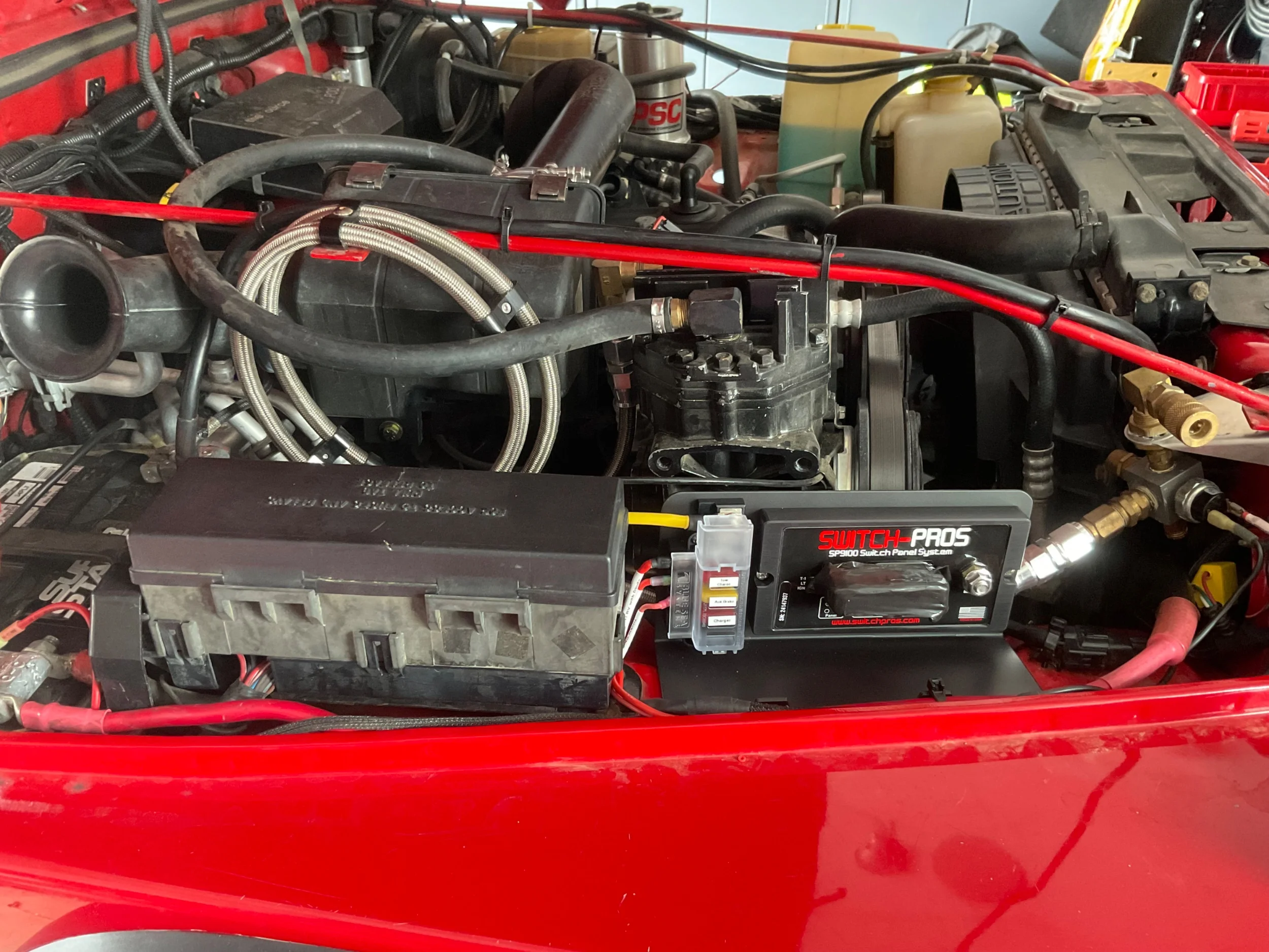

I saw that pop up as his avatar and wondered where it was displayed. As is usually the case, that is enviable craftsmanship. The only thing holding me back from doing the same thing is my shit fabrication skills and short arms that can't reach the center of the engine bay. So that leaves me with this solution to mounting the SwitchPro.
