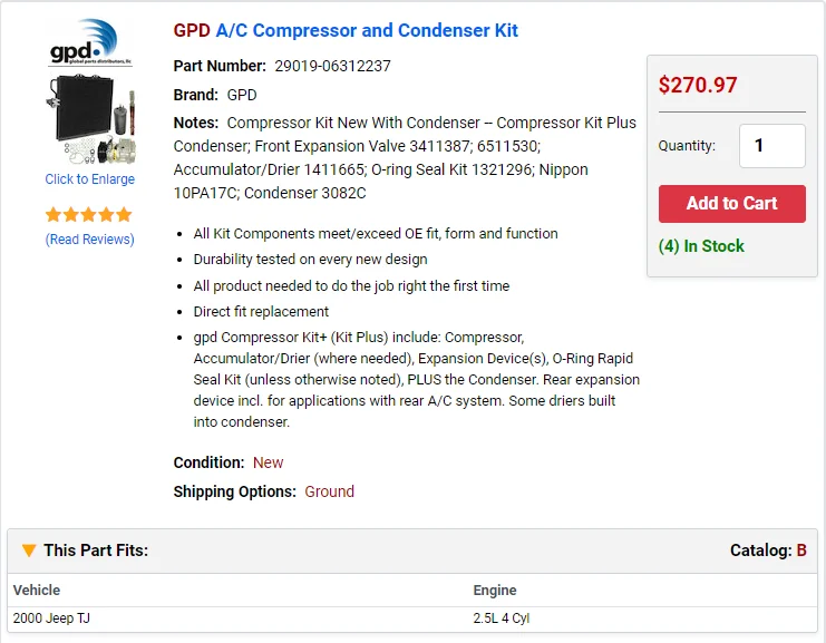

I have a 2000 2.5L MT that did not originally come with a/c (I believe the first owner opted out of it) and I'm considering adding it to make it more comfortable for the wife and kids, especially in the summers. I checked out JeepAir's kit going for 1k, but also found a kit by GPD on partsgeek just under $300 (will cost about $400 after I add in an evaporator and the required hoses). Any red flags with the significant price difference I should be wary of?
Is a junk chinese repair bundle the same as an ac retrofit kit? How are you going to wire and control your junk chinese parts? Bolt them on? etc?
