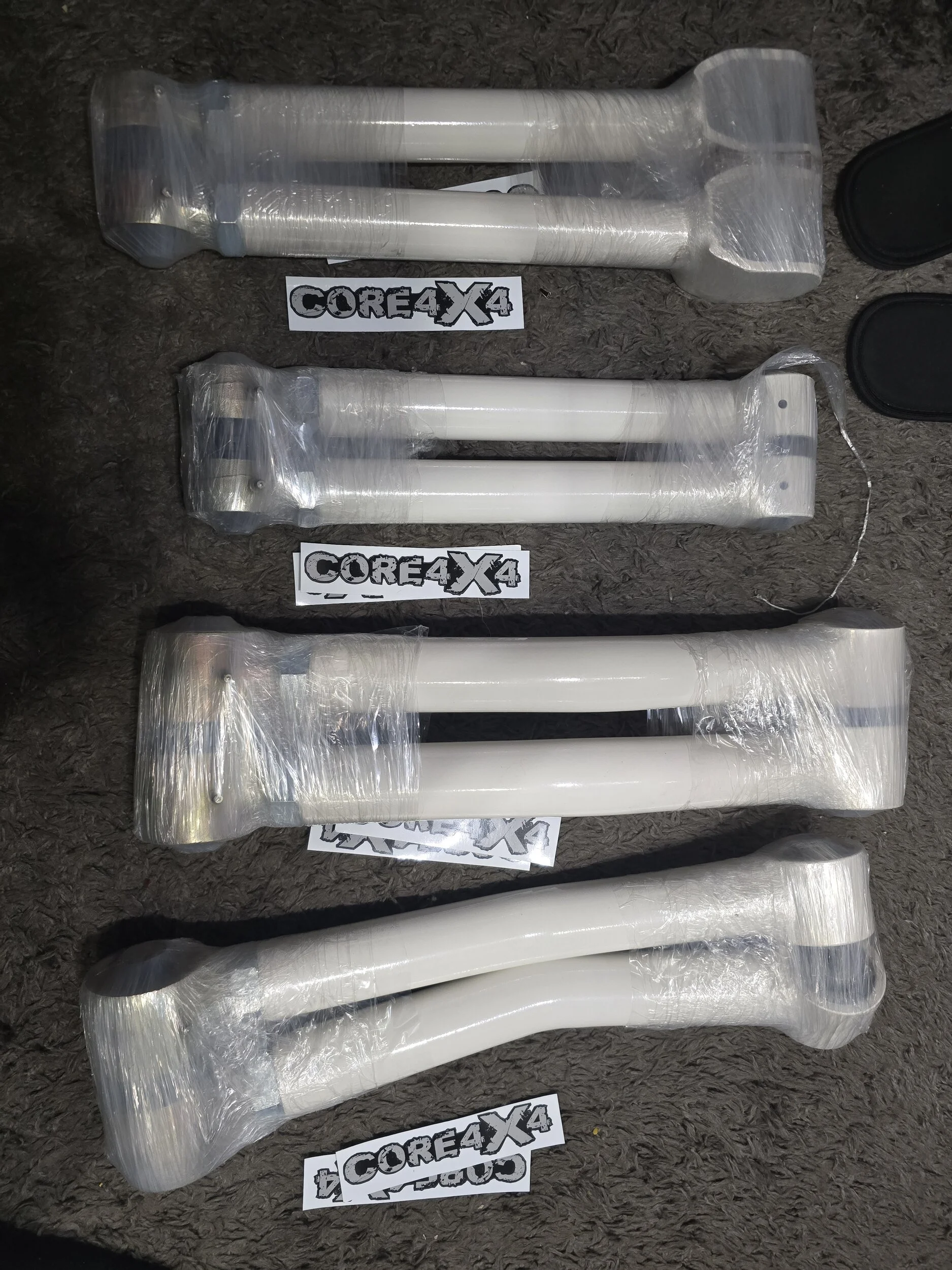

I have a 99 TJ with a new installed 2.5 lift. It has settled, and now I'm ready to add the adjustable control arms.(Core 4x4) I have a full set. I was told once you start lifting your jeep you shorten your WB. My question is what Lengths should they all be adjusted?
Feel free to go indeph. I've done all the work myself, so I'm open to all advise.
The manufacturer didn't give me anything to go on.
Reactions: Rickyd
The correct control arm lengths are the lengths that they end up being after adjusting to put the axles where they need to be. No one knows what that is for your Jeep except you.
