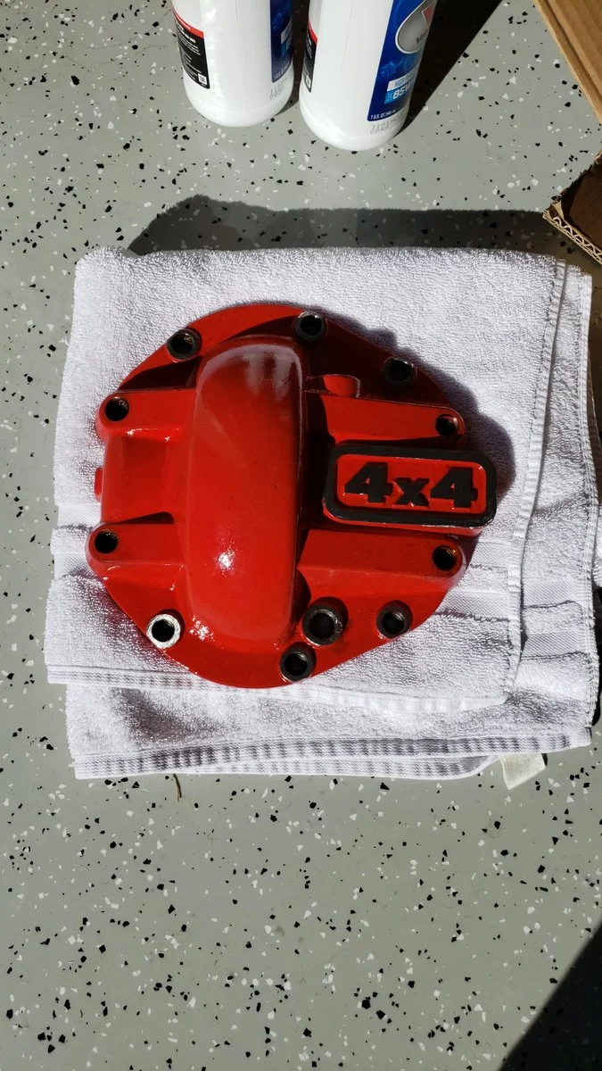

So, not knowing what the inside of my Dana 44 looked like or the condition of the lubricant I purchased a diff cover from amazon that looks identical to an ARB but has 4x4 embossed where the ARB lettering is.
Question: does this type of cover require more or less lubricant than the stock stamped sheet metal cover?
I removed my stock cover as todays project and the lubricant was pretty much all there based on what drained out. Didn't smell funny or burnt and looked like used oil. Installed the new diff cover and am now waiting the required time for the sealant to cure before re-filling the diff, basically sometime tomorrow. And yes, I do have 4 oz. of Mopar friction modifier to add.
It takes the same amount of fluid as the stock differential cover.

If you're talking about the ones that look like an ARB, but say 4X4 instead, I'd stay away too. I'm pretty sure they're Chinese knockoffs, and the pictures I've seen look like the castings may be porous. Or maybe there's more than one that says 4X4? Maybe somebody else can clarify this further...

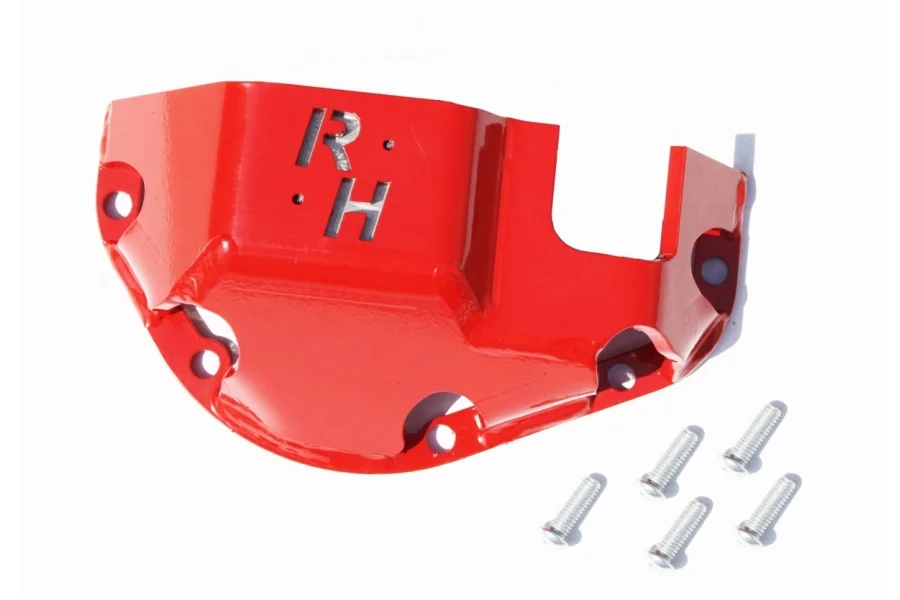

I went with poison spyder bombshell covers, I like to play in the rocks, they are thicker and I have no complaints whatsoever. It performs exactly how I think it would, if you want to keep your stock cover you can always go with a rockhard4x4 cover, it is basically a bolt on "shell" for the bottom half where you would most likely be hitting, heres a pic
