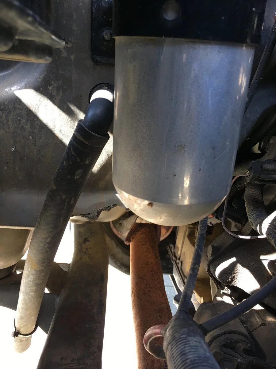

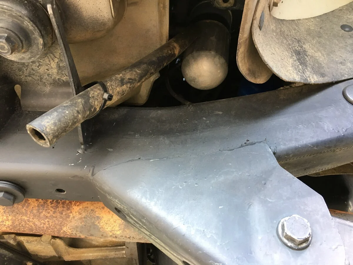

My '06 has a 90* elbow on it pointing to the ground. I'm not sure if all years had that, but I slide a hose (3/4" I.D. I think) over it and ran it down to the side of the frame so it went straight to the ground.

View attachment 175640View attachment 175641
Mine is also a 06 and I'm 99% it has a 90* elbow as well. Think I'm going to have to copy that sometime! Thanks!
I ended up copying your fix, found the perfect length tubing lying around at work lol Thanks for the solution!
