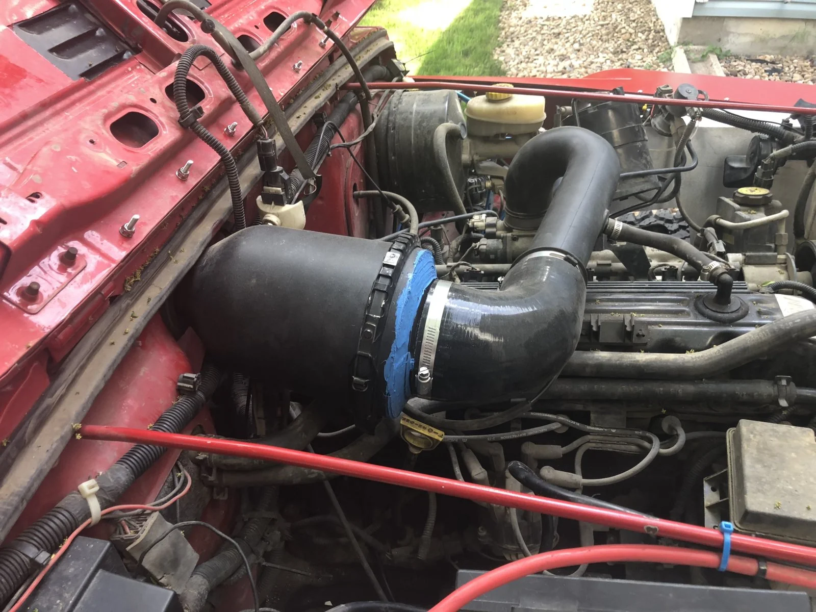

If they have a 00s Ford windstar (or any late 90s/early 00s Ford style Van/Truck) you can take its intake and adapt it to fit your TJ. It is a "true" CAI but dont expect any performance out of it. You can also use a traditional style paper filter with it.

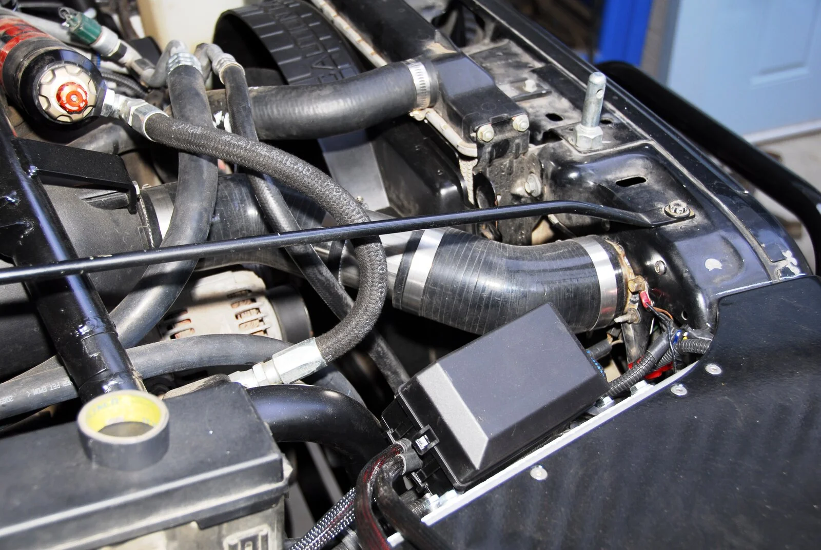

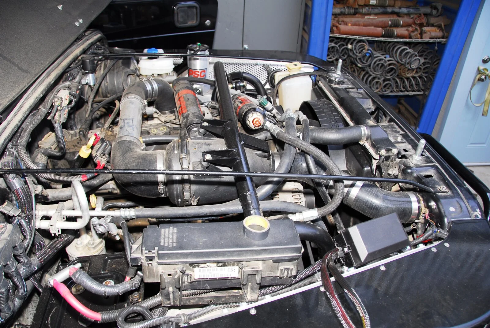

Ask a guy (me) who is forced to run a cold air intake due to my GenRight fenders how much it sucks here in the desert. If you saw how filthy my air filter is after each wheeling trip you’d totally understand why people like the factory air box so much 🤣

Sufficiently motivated Jeep owners can do this. Runs a factory paper filter with Genright fenders or an equivalent difficulty level.
Did you figure out it is an actual cold air intake yet?
Not if it’s hot air outside 🤣
Looks like it’s taking air from the outside via the headlight bucket though. Is the headlight installed or is something else clever going on?
