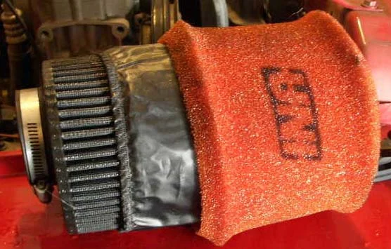

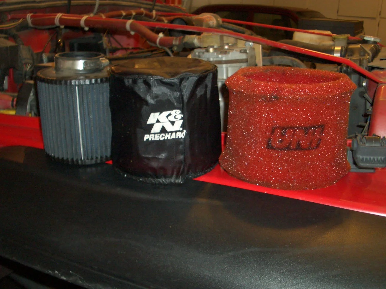

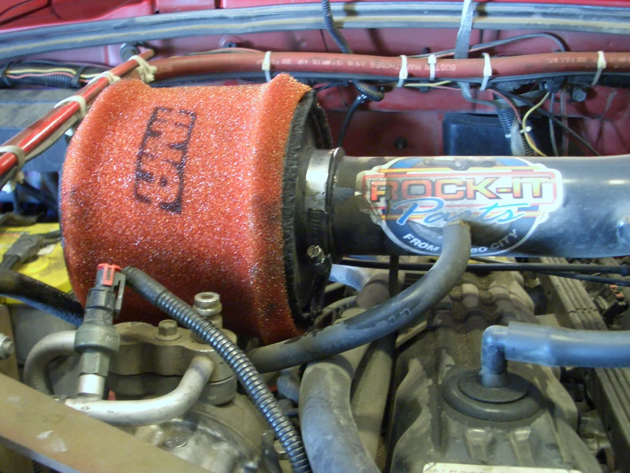

A single pre-filter didn't stop my K&N of many years ago from passing too much dirt. I ended up having to place a second prefilter, an oiled foam Uniflow, over the K&N Precharger pre-filter whose fit was so bad that dirty air flowed around it.

A single pre-filter didn't stop my K&N of many years ago from passing too much dirt. I ended up having to place a second prefilter, an oiled foam Unifilter, over the K&N Precharger pre-filter filter whose fit was so bad that dirty air flowed around it.
View attachment 280678View attachment 280679View attachment 280680
