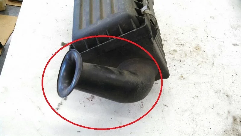

One thing I did on my TJ back when I drove 30 miles 5 dais a week to work was remove the 90degree horn looking thing attached to the airbox.
I did notice a slight change in fuel savings after I removed it. These days my job is only 1.5 miles away so the TJ does not get many miles on a weekly basis anymore.
Nope, removing the trumpet won't help mpg, not at all. It might only via the Placebo effect. Removing the trumpet only causes three changes...1) a louder air intake, 2) slightly reduced air-fuel mixing efficiency from the reduced velocity of the air entering the combustion chambers through the intake valves, and 3) a higher likelihood of water ingestion into the engine through that significantly more exposed opening. Replace it, its removal didn't do anything good for you. Really. :)
My comment above was based on testing scenario where the only change was the removal of the trumpet. Basically same route to work and back same fuel type and gas station. Basically only variable was the trumpet.

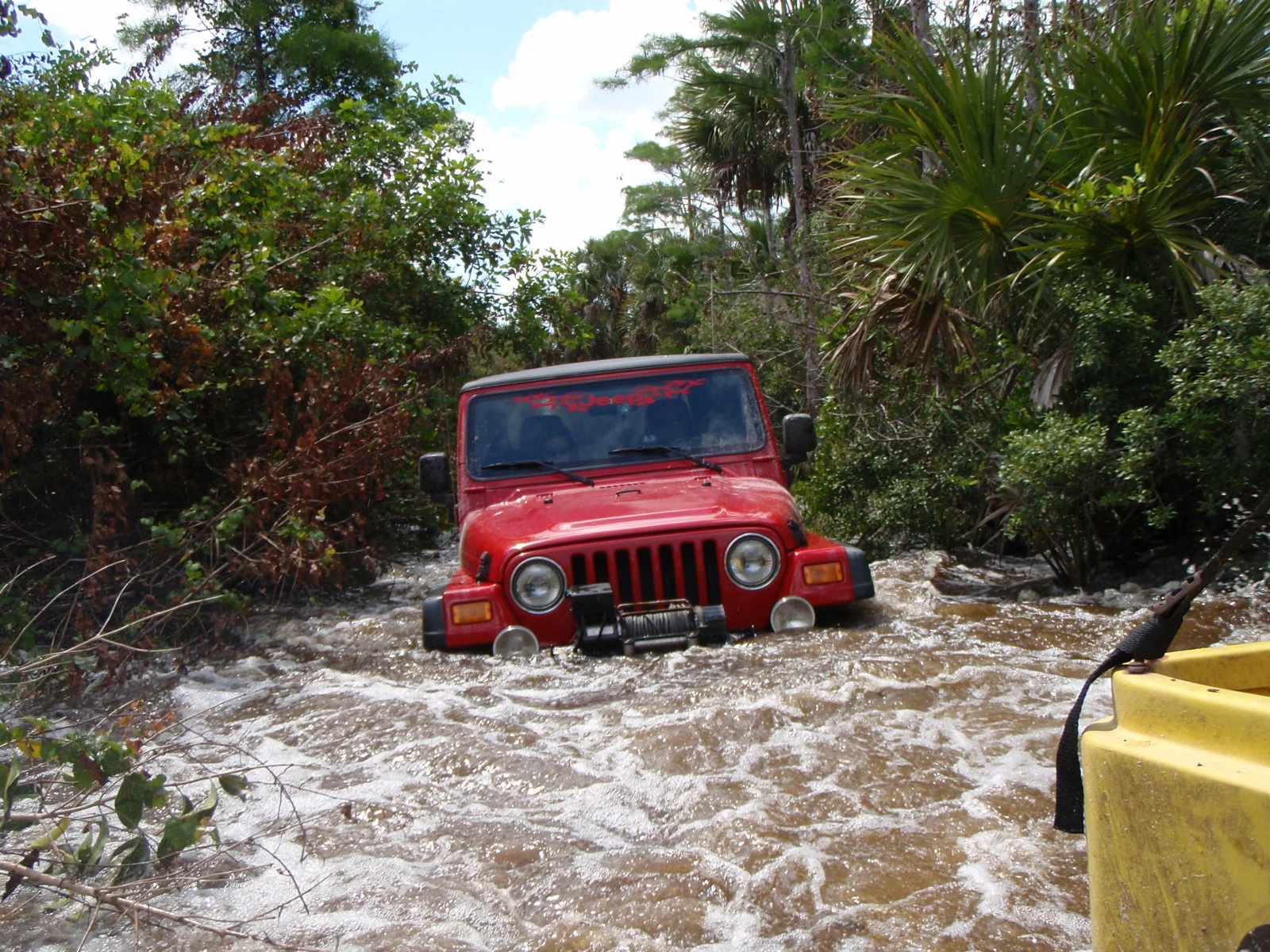

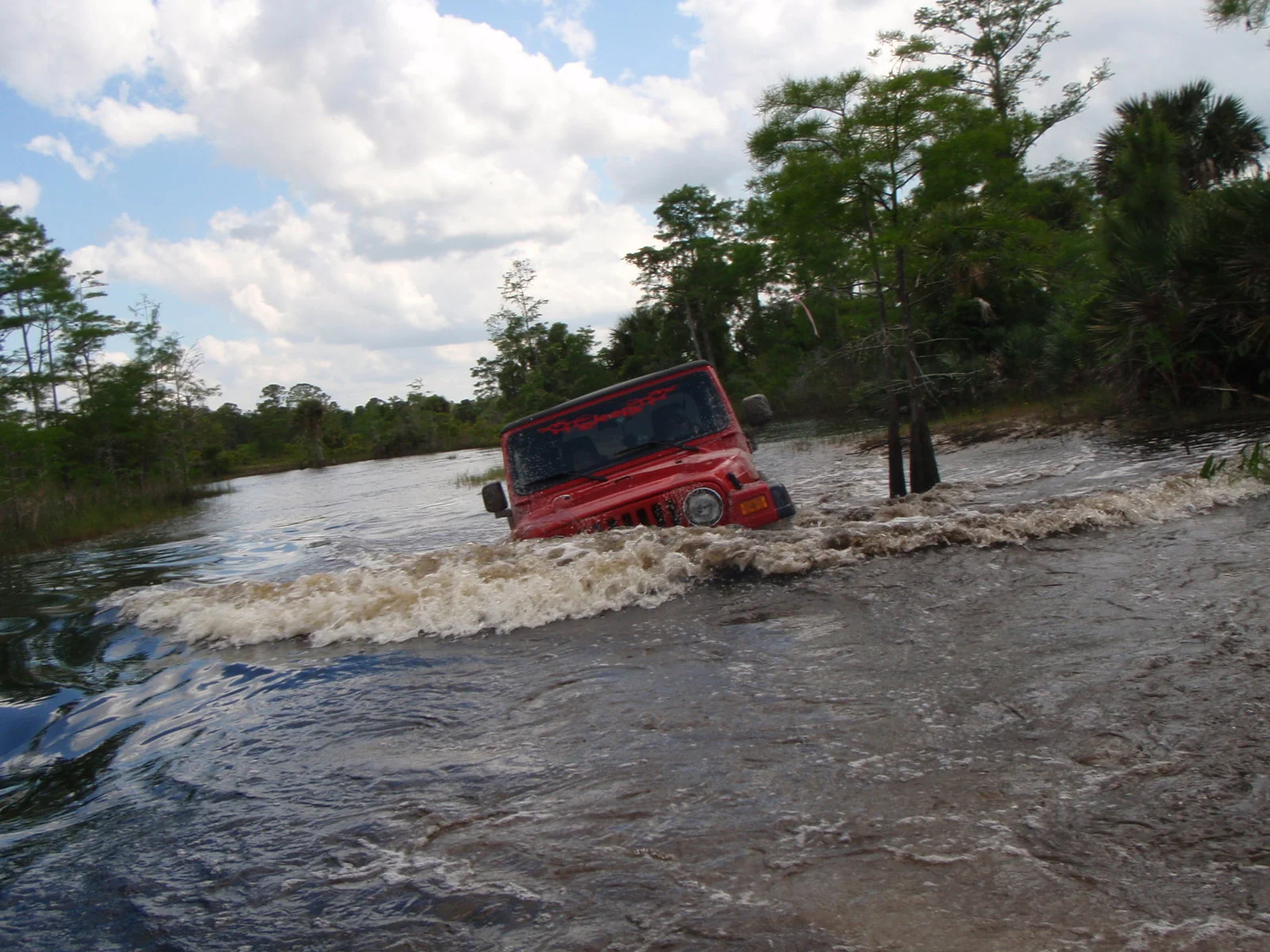

As far as risk of water probably only if I go deep enough to reach the air box but to me the trumpet angled up towards the hood curve has more of a chance on getting water splashed into it then an opening left by removing the trumpet. from 2006 to some time in 2010 my wheeling was about 80% water and mud as that is all we have down here in the swamps of South Florida. My TJ has been in many occasions with water just below the bottom of the headlight.
few water examples of my past wheeling days.
If you want to believe just removing that trumpet improved your mpg and that benefit you perceived outweighs the drawbacks like the potential for hydrolocking the engine in the situations you showed photos of, go for it. :)
