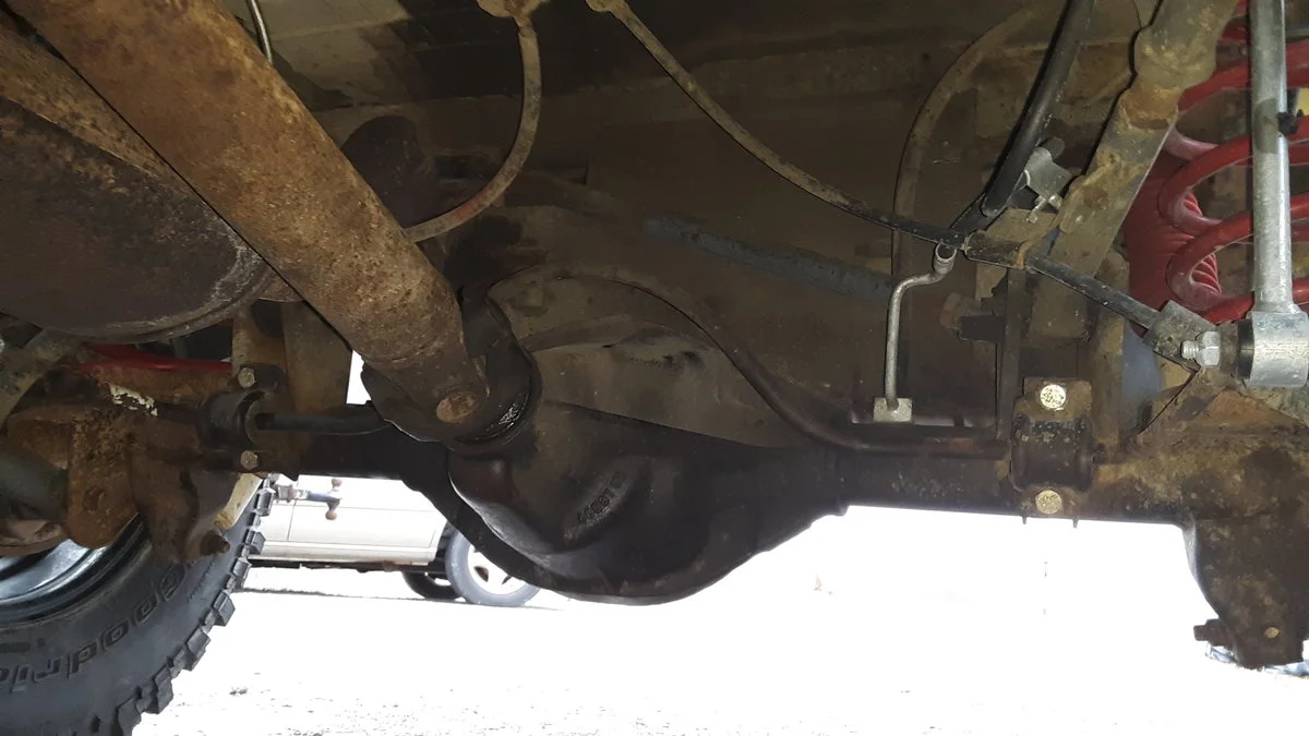

Well like i was saying, its sits so high that my control arm angle is severe. Iss it possible that i have my pinion angle so releaved that its allowing it to move badly? Maybe i should adjust it more so that my springs r not bending and possibly creating that rear movement?
Well 6° of caster is in the ball park for good handling , I cant remember the numbers on pinion ....even that pitman arm could make it wag its tail I suspect.
On the front im about 5 to 7. I suppose im gonna try to locate a stock pitman arm and switch em out. See if that helps. I certainly am glad i joined the forum to get some opinions. Thanks to all of u.

Yep , get that dropped pitman arm off , and be free.
We hereby banish all dropped pitman arms , dropped pitman arms , we darn thee.
Notice the diverging track bar and drag link angle .

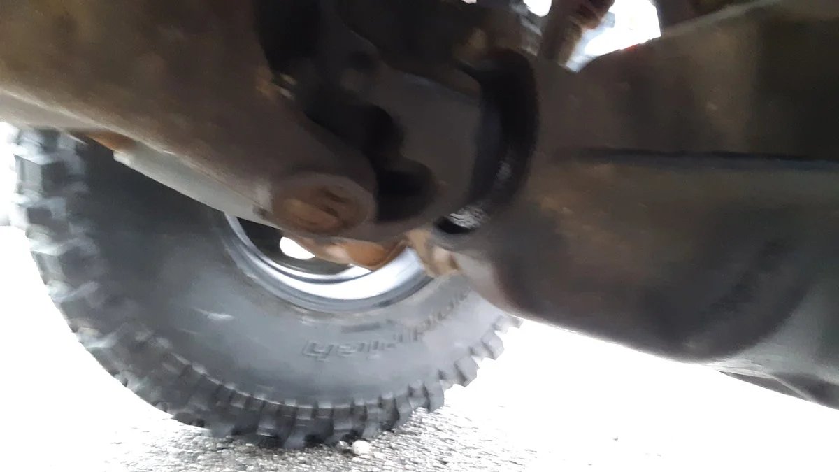

Get rid of the dropped pitman arm. Take a post of your rear driveshaft and pinion from the side so we can see how that looks. Get tire pressure to around 26-28 all around. Get your toe-in to 1/8" or a hair less.

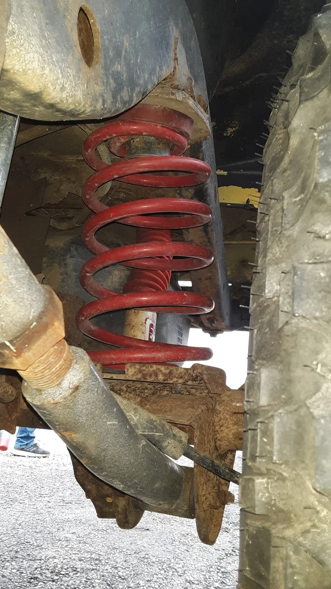

Cant wait to wheel again. How do ya feel about them back springs being bent like that. Should iput a little more angle in it to put my spring purches back to being more level?
I'd go for closer to the factory orientation.
I don't think the DPA is the problem. A DPA is a horrible idea if the PHB is in stock location. From the picture they should play nice together. How are the ends on the PHBs?
