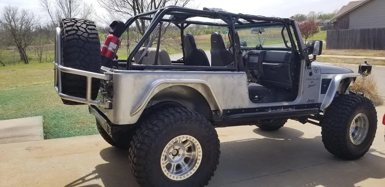

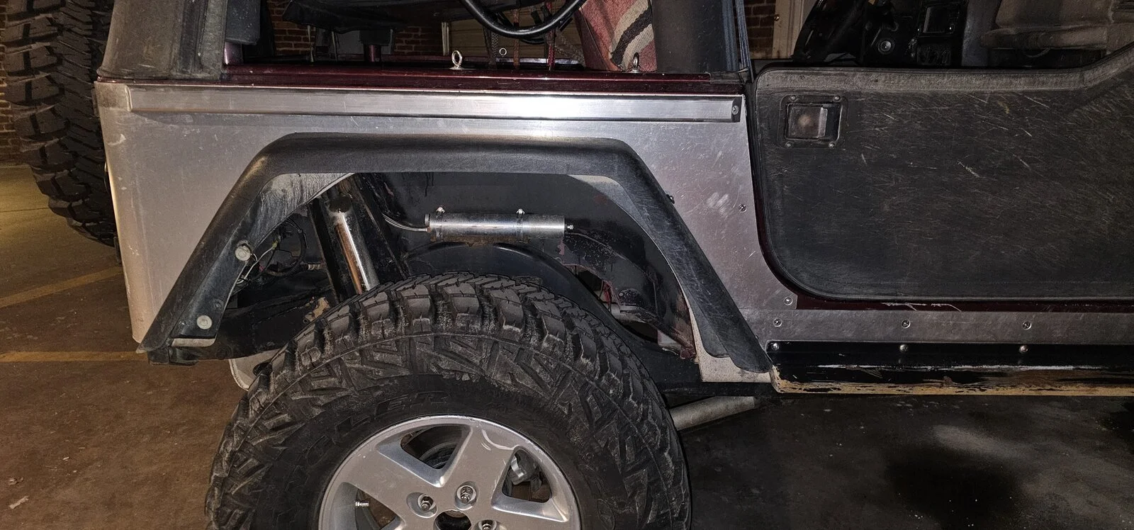

I got these corners used, so there were all kinds of marks. These are pics of what they look like raw after I worked orbital sander from 120 to 220 to 320 to 400 grit. If I was leaving them raw I’d stop at 320 grit.
I hit mine a couple times a year with scotch Brite pads, then take a random orbital buffer with Meguiar's cleaner/polish. It makes a mess, but does a good job of protecting the aluminum. The downside is, to do it correctly, you have to remove the rear flares.

I think this is what I'll do. Keep it raw and just sand/scotch brite/buff it once a year or so. Just need to get an orbital sander, might check out Harbor Freight.
I have 2 "major" scrapes (one from Little Sluice, other from Busywild), that bother me a tad bit. What grit would you use on a deeper scratch?
