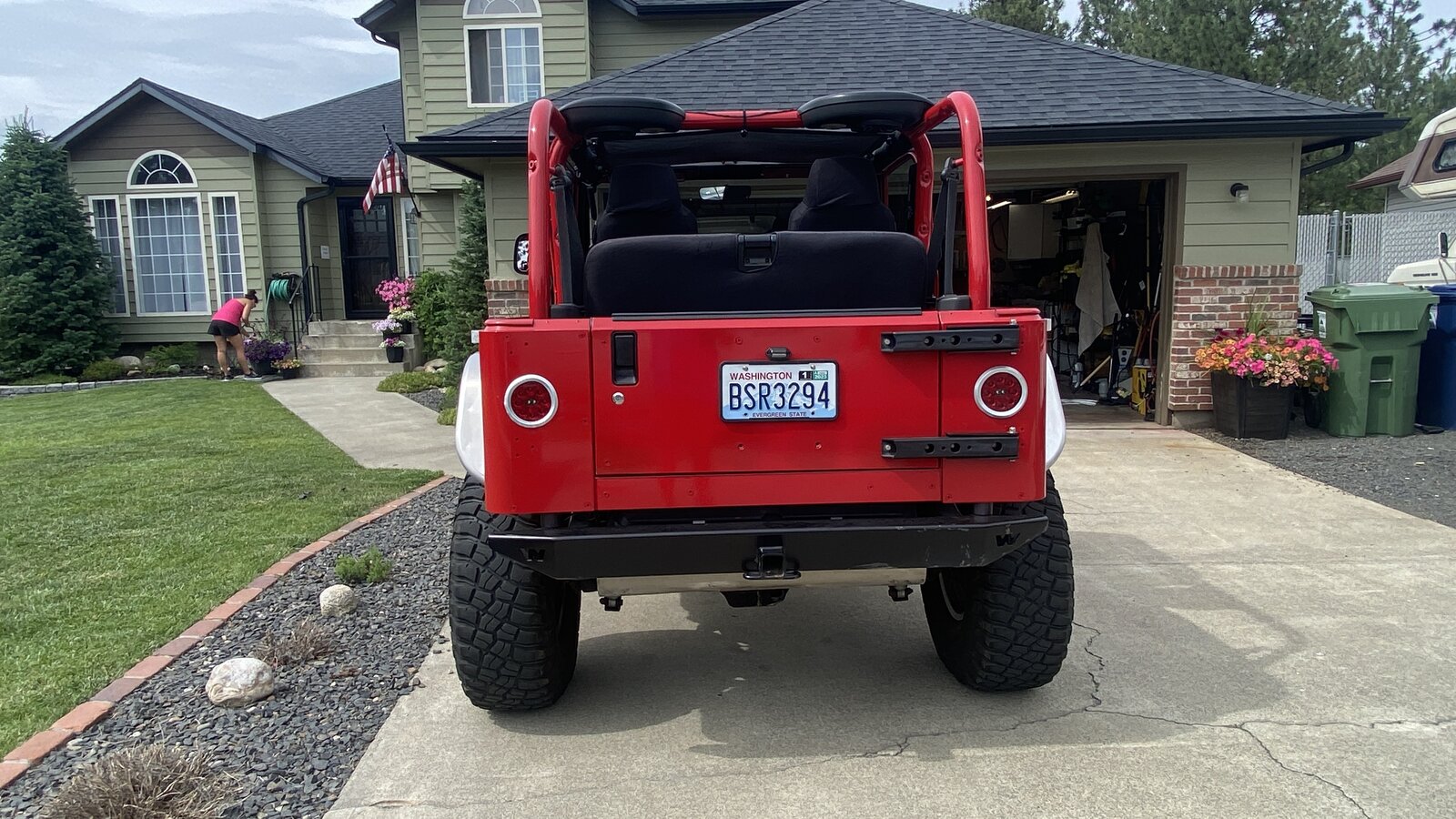

I recently purchased this jeep from a buddy to use at my summer house in the PNW. It has GR Aluminun bumpers and fenders. Unfornatully he powder coated then a textured black which quickly oxidized. I had them chemically stripped hoping to go back to raw.
They came back bare but not the same finish you get with new. I also like the raw look so I decided to have them redone with a Silver powder. I believe the powder will hold up better being an outside jeep.

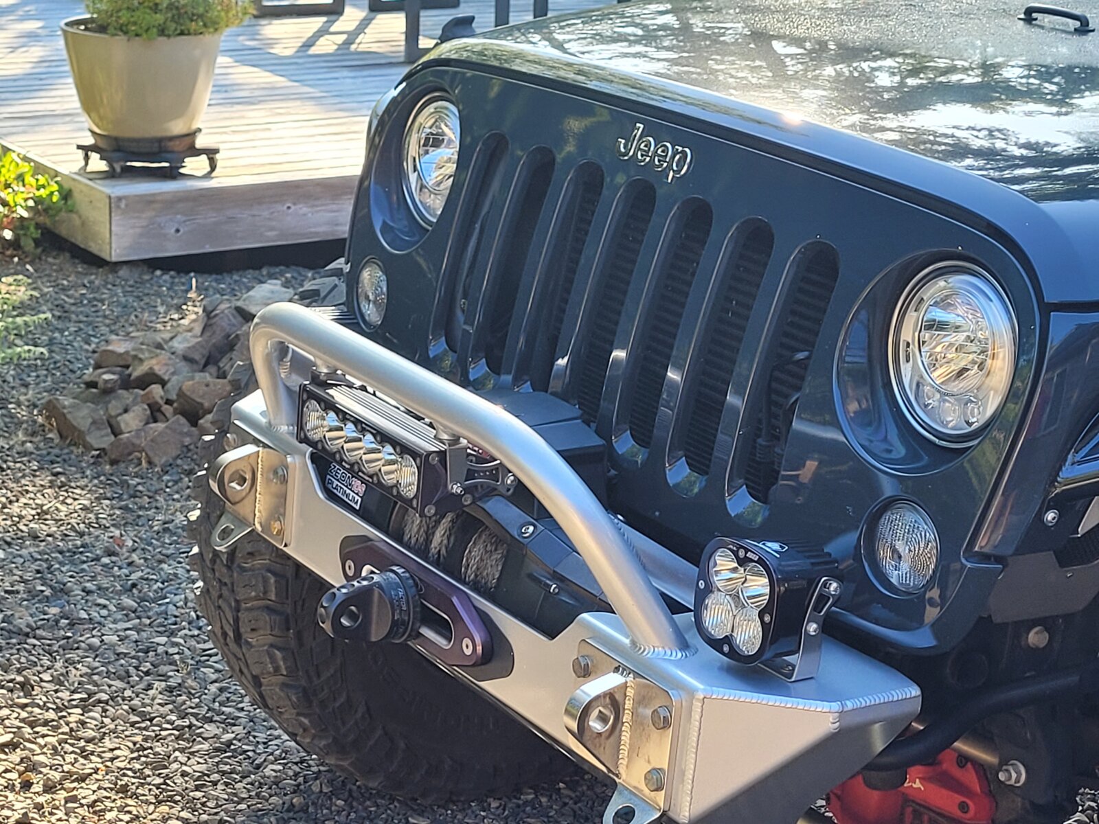

My Aluminum bumpers are painted but I have applied sharkhide to my savvy slider backers, under armor, and gas tank skid. They all still look as bright as the day I installed them (if you look past all the rock gashes).
This picture shows how my 2 years in the sun slider backers look:

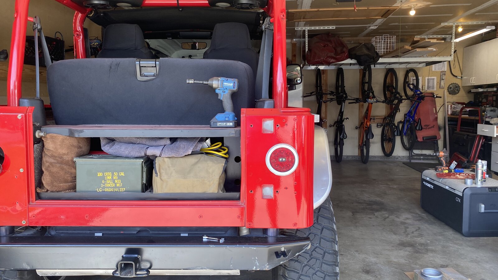

Here’s my paint process for Aluminum. You don’t need to sandblast aluminum to create enough bite for the paint or to remove contaminants.
Sand at 120, 220, then 400
Self etch prime with a good quality 1K Self Etch.
Check with your local Auto Paint Supply store. They’ll have everything you need. Also ask them as many questions as you can think of. You’ll learn a lot fast.
The extensive HVLP prep and paint process is attached in a Microsoft Excel file.
Here’s a few pics of what my aluminum corner armor and tailgate armor looked like after I followed the attached procedure. Any aluminum you see in the pics was left raw.
