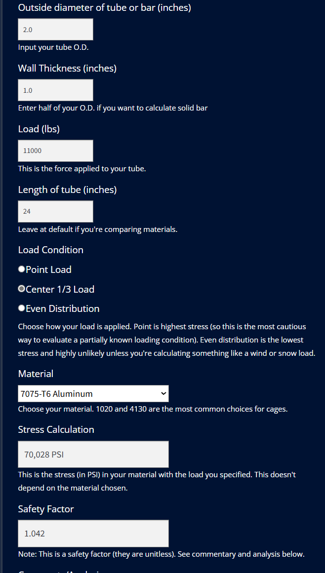

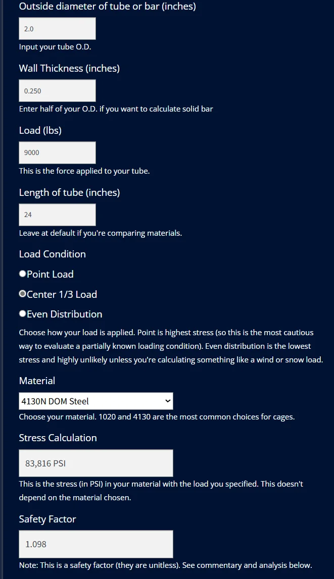

Play with a tube calculator to get some ideas of how resistant to bending different materials are. I like the one Rogue Fab has on their site.
Compare the safety factor to dial in the load at the center point. It explains the safety factor and what it means. In this comparison, I picked 4130 tube that most won't buy but it is stronger to a degree over normal DOM. 7075 links are common and easily acquired. I use Julene at Summit Machine. She takes very good care of her customers. To get the aluminum link, it just has to be cut to length and threaded. Easy. To build the DOM arm, you're buying two weld in threaded bungs, welding, and then you need the taps to clean up the threads. I've done hundreds of weld in bungs, anyone that tries to give you some BS method for fixing the threads after welding that doesn't involve taps, tell'em to fuck off. Taps work every single time without fail.
With the 7075, we pick up the strength of solid over tube without the weight penalty for solid steel round bar stock. It is also hard enough to slide over rocks just fine. You also pick up a weight advantage over steel tube with the solid aluminum bar. 2" x .250 wall round steel is 4.6 pounds per foot, 2" solid aluminum round bar is 3.7 pounds per foot.
2" 7075 is good for about a 36" arm on a lower, any longer and you should consider bumping up the diameter.
