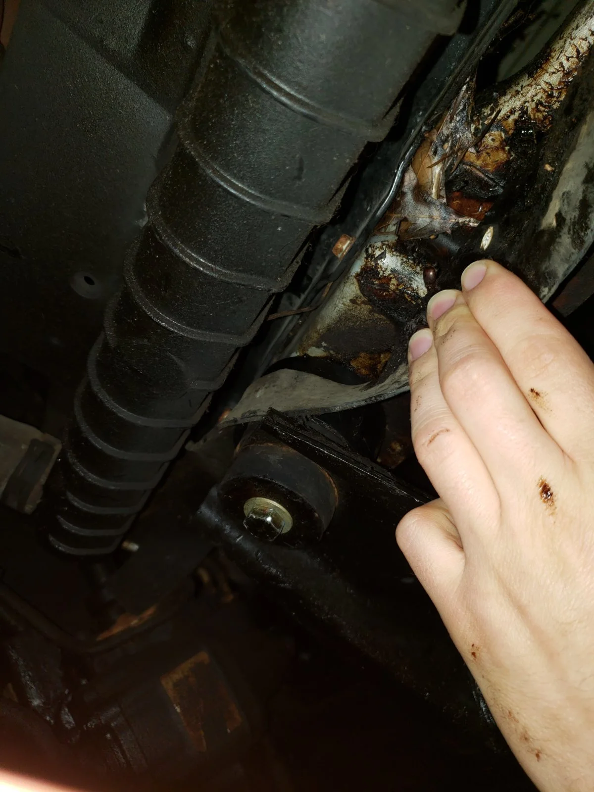

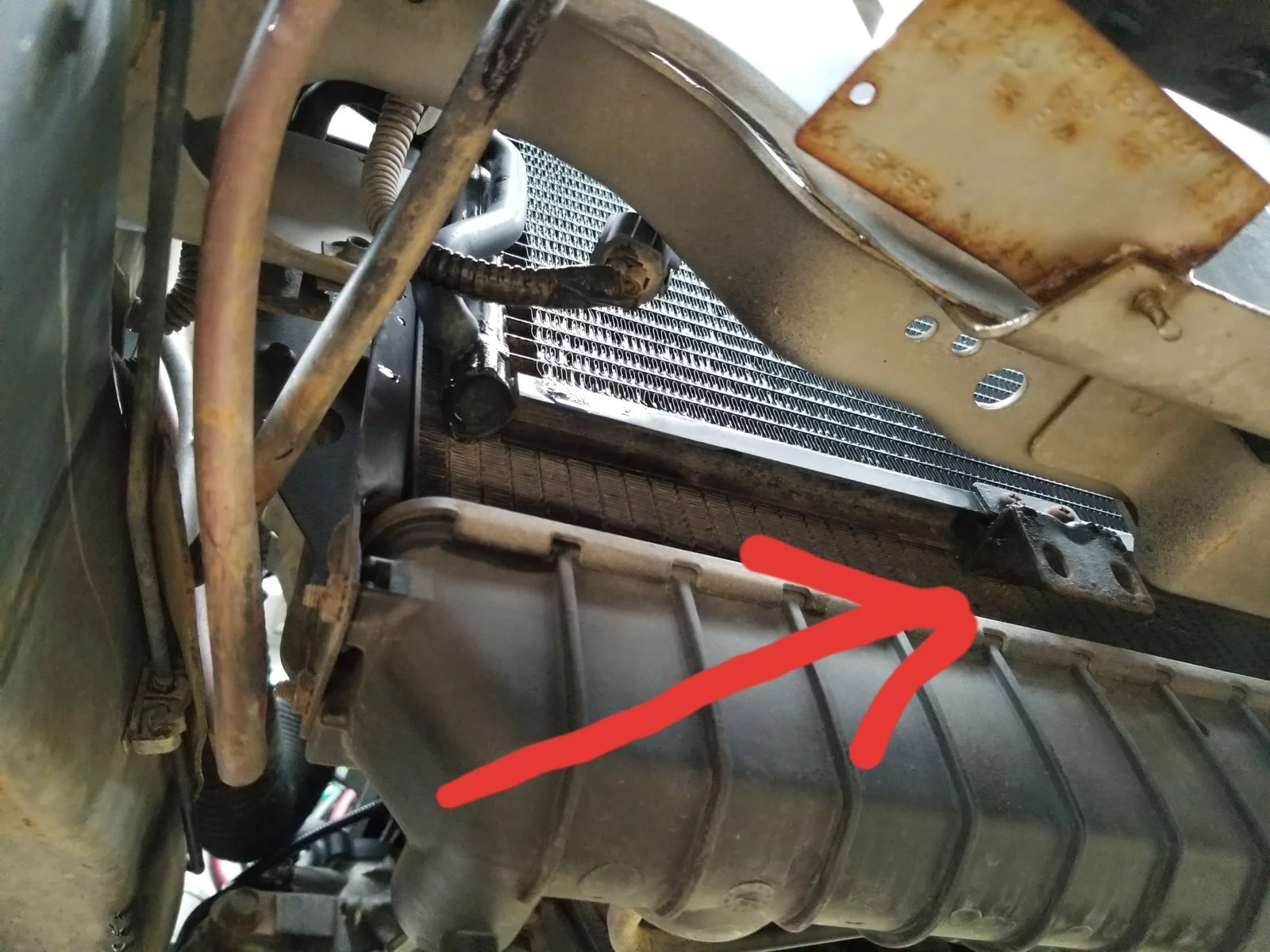

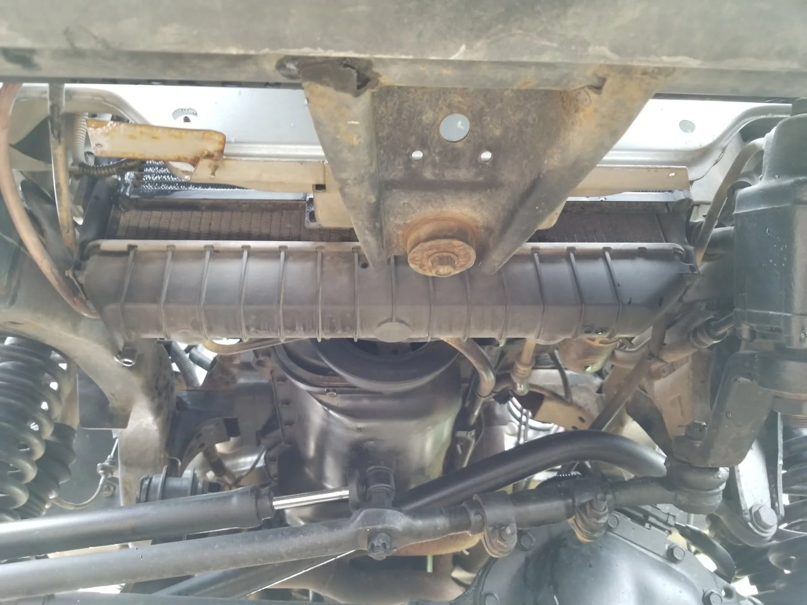

I flipped the petcock to drain the coolant and noticed the lower mounting brackets to the AC condensor are just floating, not mounted to anything, and I can wiggle it back and forth against the rad, which I am sure will cause a leak in the future. I'm also missing the lower rad mounting bolt, so I'll grab one of those.
Am I missing some sort of lower support that holds the condensor a hair off the rad?

It looks like your condenser has been replaced with a generic version. The factory one bolts to the grill at the bottom. You can search ebay for a used 2006 condenser and see the bottom is a bit different. There also should be a rubber air dam down there to direct air through the radiator that probably wasn't replaced when the A/C work was done. If you want to attach it you need to pull it forward. If the holes don't align you'll probably just have to make a custom bracket.
Reactions: Steel City 06
Sweet. Thanks guys. I made little rubber insulators by cutting slits in short pieces of old heater hose and slipping them over the condensor for now.
