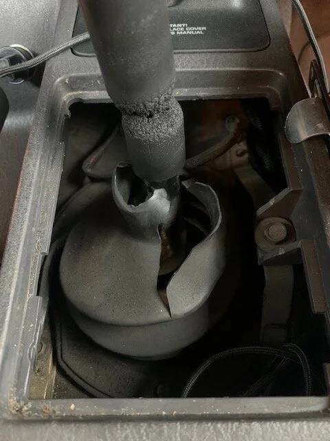

On occasion I have been smelling odors, feeling heat and hearing road noise and this is what I found on my '01.
Just ordered a replacement inner boot and plastic shifter boot frame.
For the interim I cleaned the rubber and wrapped a couple strips of Gorilla tape around the upper and middle rips.
