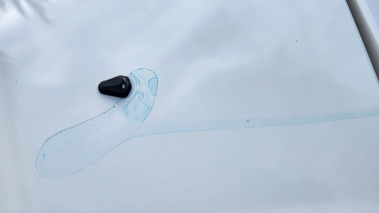

B1Toad TJ Expert Original poster Supporting Member Joined Jan 15, 2023 Messages 3,289 Location Arizona Apr 19, 2023 #1 My driver's side washer nozzle leaks for days after using the washer system. If I don't use for a while it will eventually stop leaking, what's up with that?
C.J. Roberts TJ Addict Joined Jan 26, 2017 Messages 1,910 Location Tucson, AZ, United States Apr 19, 2023 #2 The line probably has some crap in it that acts like a one way valve, not letting it equalize pressure. Try cleaning or replacing the line. Reactions: B1Toad and TJ4Jim

B1Toad TJ Expert Original poster Supporting Member Joined Jan 15, 2023 Messages 3,289 Location Arizona Apr 20, 2023 #4 C.J. Roberts said: The line probably has some crap in it that acts like a one way valve, not letting it equalize pressure. Try cleaning or replacing the line. Click to expand... Good idea and easy, I'll try that today.
