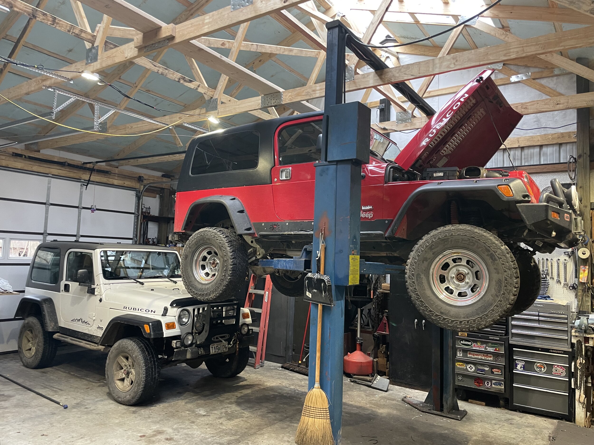

Thanks again! Keep currently on my lift for rear main seal (should be done today) so back on steering issue this week. I’m going to adjust track bar one turn and try the one upper control arm bounce and disconnect & then see how it drives.
As with any new ride, several things to work over. I’ve got a UCF skid off another Jeep and leftover MC bumpstops that work great for a body lift. This LJ has a Banks turbo on it so think I can spin a bigger tire w/out a regear.

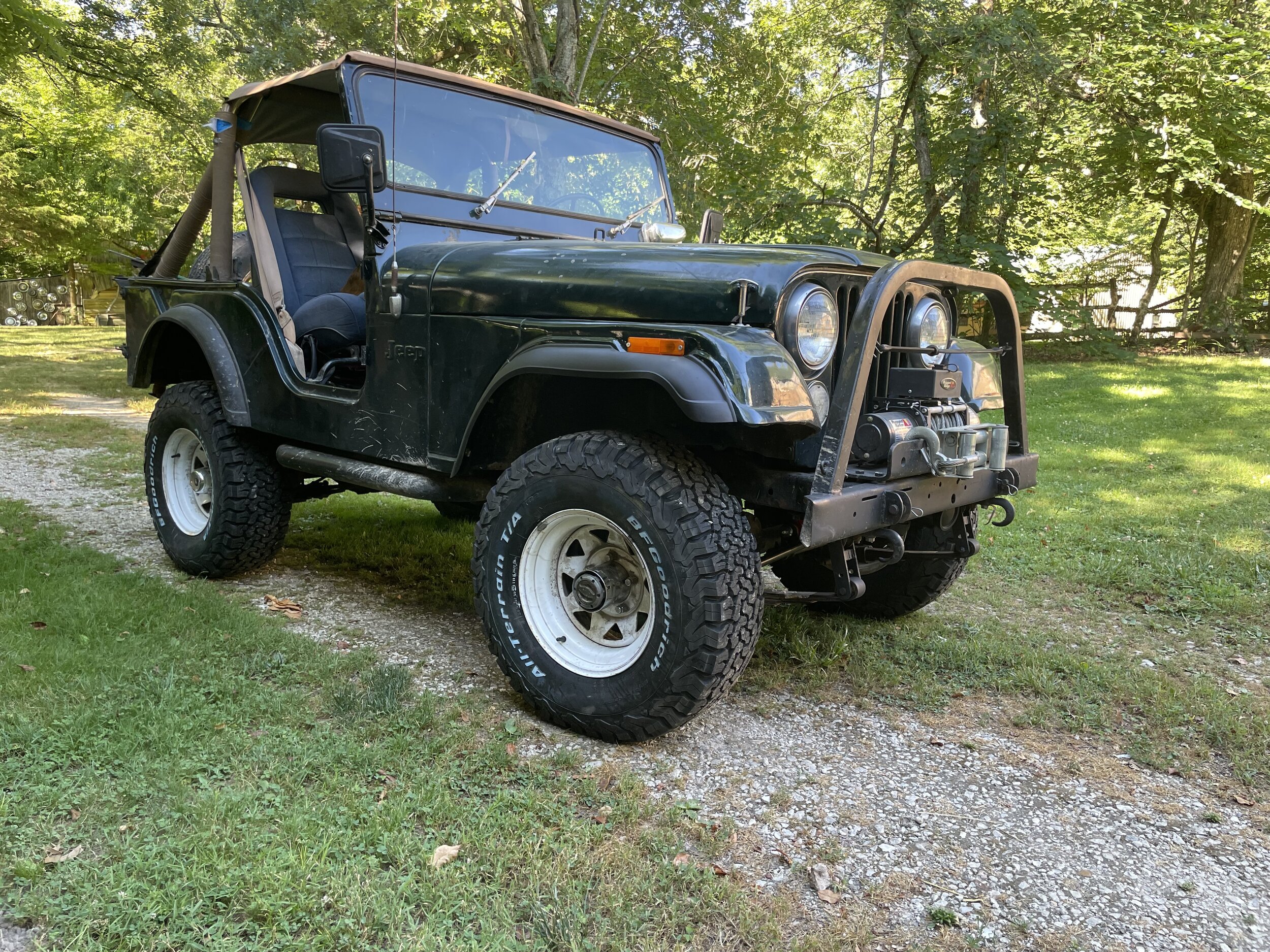

Both auto. I’ve got a CJ5 w/304 & two flatties w/3 speeds. CJ5 has a hand throttle on gear shift: well recommended when you need a little throttle “tickle”!
I like wheeling with the auto.

Wanted to circle back on this thread. When I installed the MC 3.5 lift, I had carefully ensured that control arms were the same length ( on opposing sides). The alignment guy had readjusted the CAs and front lower were 5/8” different in length.
Readjusted those to even and balanced front uppers as well as small centering of front axle w/track bar seems to have corrected most of steering issue. Haven’t gotten it back on rack yet due to weather & rear main seal but thanks to all who posted! Learned a lot!!

Understand your point but drove better when I readjusted them to even. Keep in mind, OEM were Nonadjustable. Additionally., Jeep drove well after initial MC install (DIY) but only took it for alignment after Currectlink add.

So I would have some serious questions for you alignment guy. If anything is 5/8 out on a TJ there is potential for something seriously wrong and you should have been notified.
