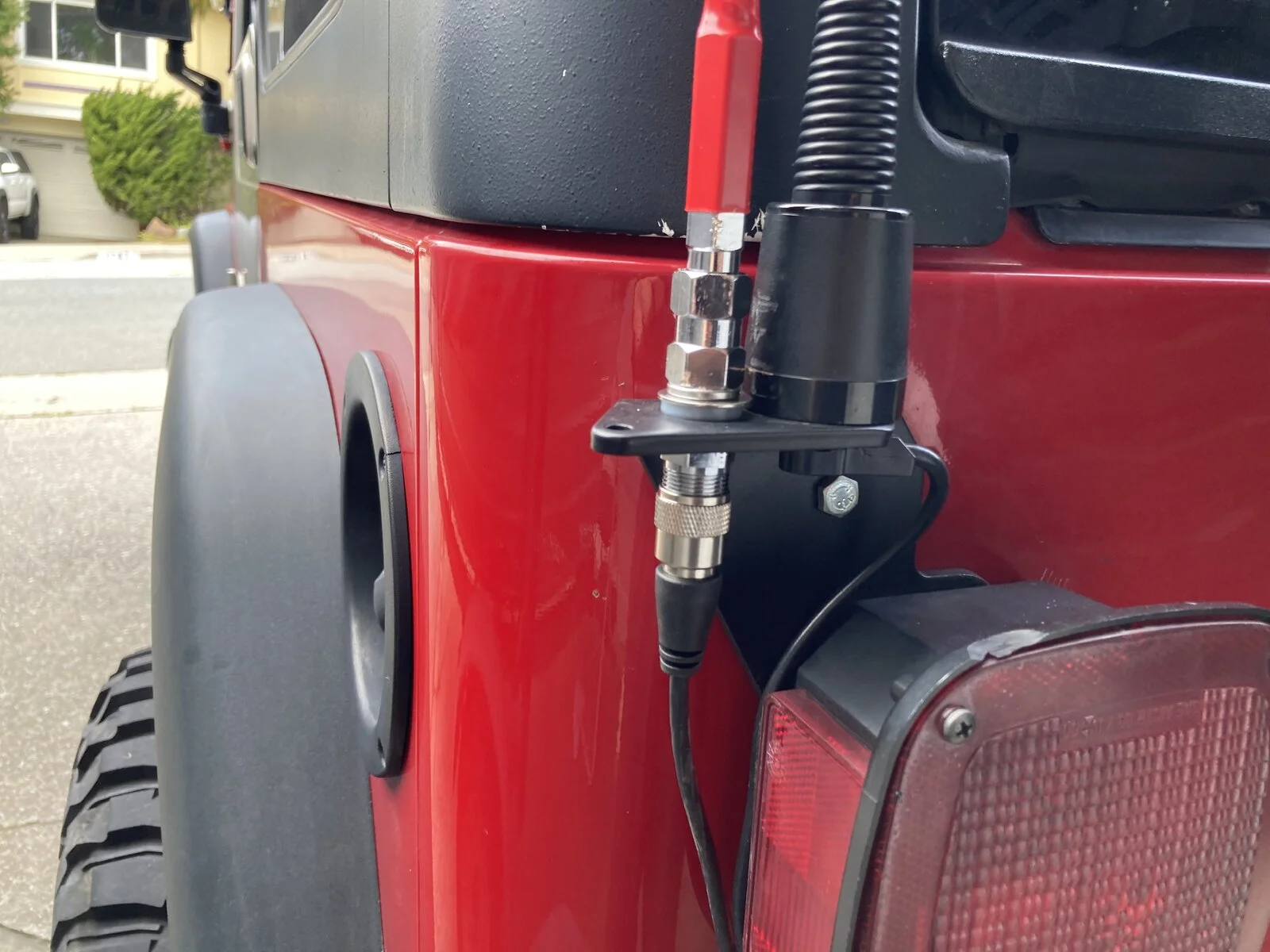

Hey everyone, trying to get my SWR dialed for the CB radio, Uniden Pro 520xl, 10ft male to male coax cable, 2' firestik on the teraflex taillight mount. Cannot get my SWR below 3, its around 3.7 ish no matter what I do. I used a dremel to get a clean ground for where the extra mounting bolt goes, but that solved nothing. There are no kinks in my cable, and my uniden is brand new. Could my SWR be high due to it being so close to my GMRS antenna? Heres a pic

Curious, Try disconnecting the GMRS antenna from the GMRS radio. Are the radios wired in the same power points?
Just checked my GMRS SWR and its alot higher than what it used to be. I tuned it when I didnt have the CB antenna installed and got it down to 1.01, highest would be 1.14. Now it reads 1.7-1.8 with the CB antenna installed. Am going to remove the gmrs antenna and see if it makes a difference

Removed the gmrs antenna completely and it dropped my swr alot. I tuned it and the lowest I could get it is about 1.9 on ch 20. I could lose alot more though
