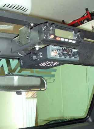

@Jerry Bransford do you like your ARR mount? I was planning on a rugged ridge windshield mount for my 2m/70cm and another mount at the A-pillar for my CB. But if the ARR overhead mount works for both I may go that route.
Love it. I had one on my previous (stolen) TJ and liked it so much that I installed another onto my replacement TJ. No drilling needed to mount the ARR and it hides the radio cables effectively.
I removed the ham radio's bottom cover and after drilling it for the CB's mount, stacked them as shown. I added large diameter washers on the back side of the bottom cover to distribute the CB's weight a little more. Probably overkill but I have washers of all sizes in my parts bin.
