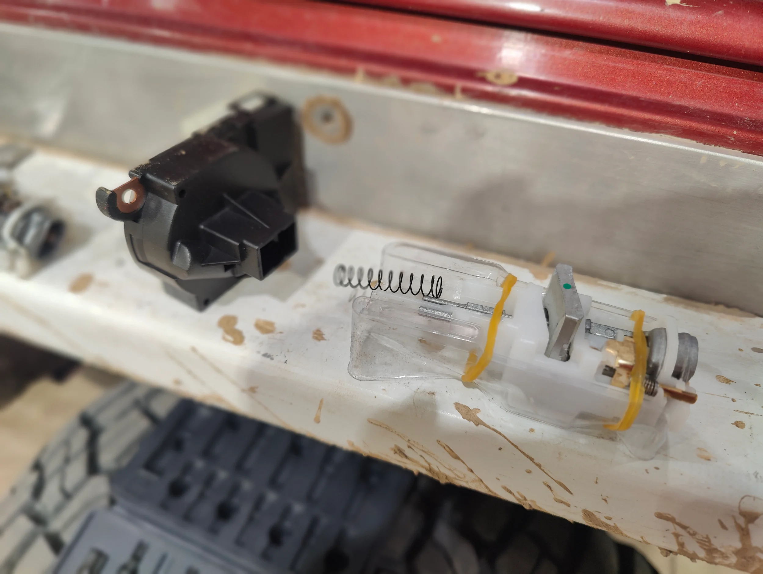

Actuator pin?

I replaced it recently and it ran fine for a few months after. But it definitely could be a problem again. Would power be getting to the asd relay if that was the problem though?
Reactions: macleanflood
When the pin breaks, everything works but the starter.

I believe I replaced the ignition switch when I replaced the actuator pin. Is it common for either of those to be bad out of the box? I've probably started it only 100 times since replacing those. Maybe I weakened them during install.

My new ignition pin already feels "crunchy" and almost stuck in the crank position.
I have a rusted out 2000 Sahara...might steal the pin from it as a trail spare.

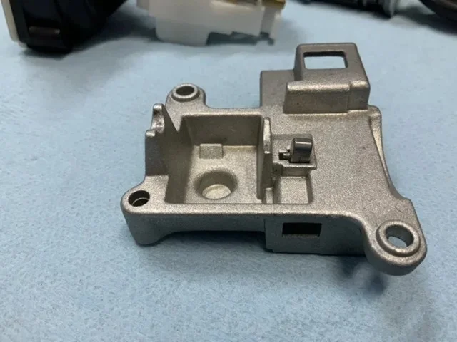

Ok, so i went in the steering column, disassembled all that, didn't find anything that looked bad, so I started putting it all back together. I turned the actuator pin by turning the key cylinder with my hand and it started. I put it all back in place and held it in place with my hand, turned the key and it started. I put the bottom cover back on (the one that has the plastic button attached to it for removing the key) and it wouldn't start. I loosened the screws that hold it in place and it started. I was so confused I did it back and forth a few more times and screws tight it wouldn't start, screws loose enough that that bottom cover wiggles around, and it starts. It almost feels like the key can't turn quite far enough when the screws are tight and it turns just a hair further when they're loose.
