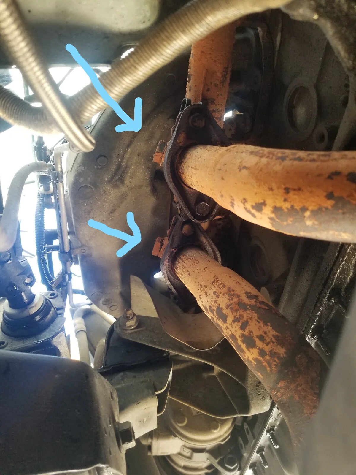

Okay, my check engine light came on and shows Code PO133 indicating the Bank 1, Sensor 1
"Electrical circuit was responding slower than required for an undetermined amount of time".
In earlier posts it was found that two (2) of my o2 sensors were capped. Either by PO or very possibly OEM.
Anyway, I attached a couple of pictures so hopefully you can see what I have.
Is the 1st picture the Bank 1 Sensor 1? If not, where is it? If so that should be an easy fix as I just happen to have a NGK23122

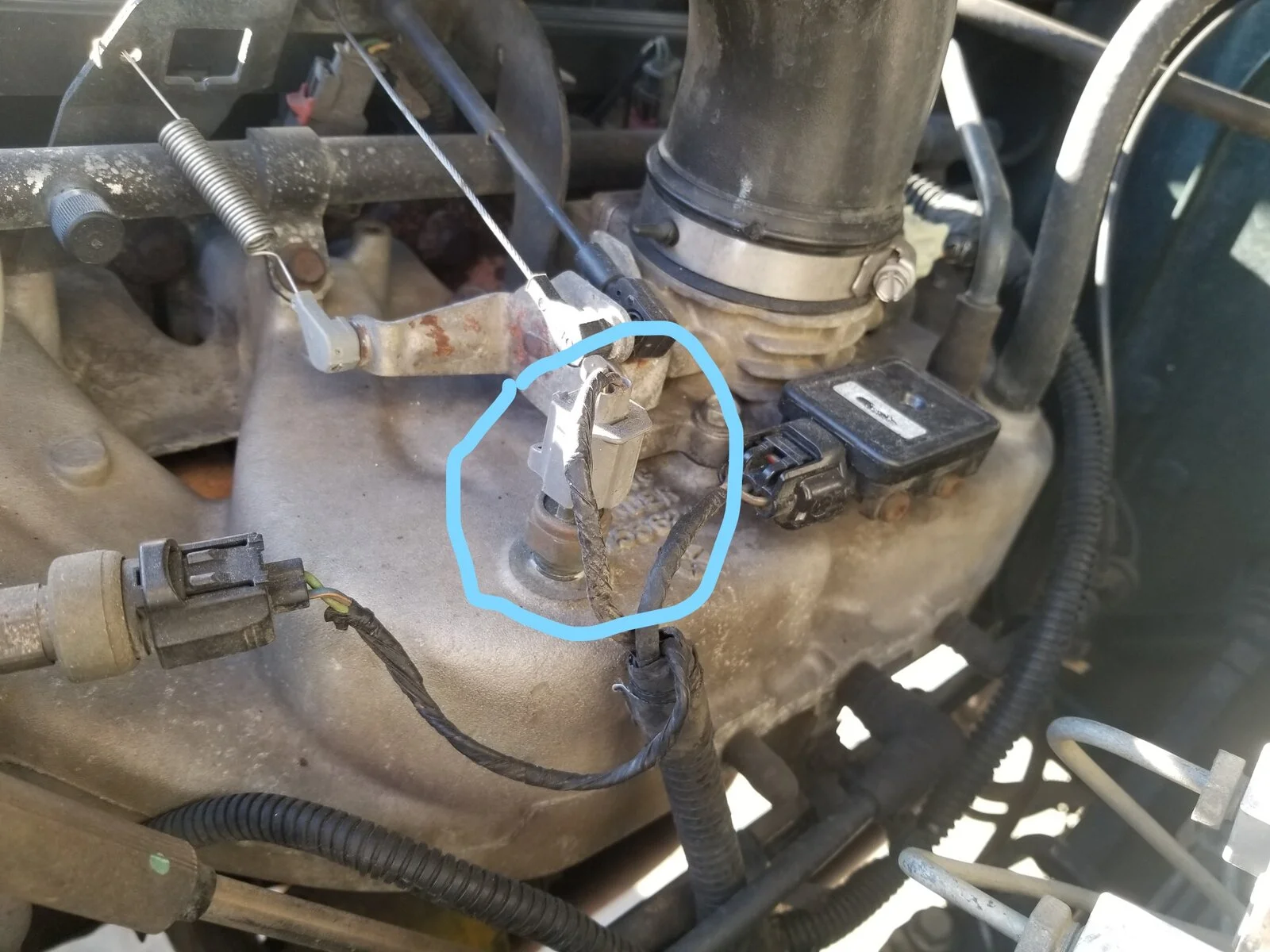

In the 2nd picture you can see the caps/plugs that are located under the manifold. I wonder which these would be?

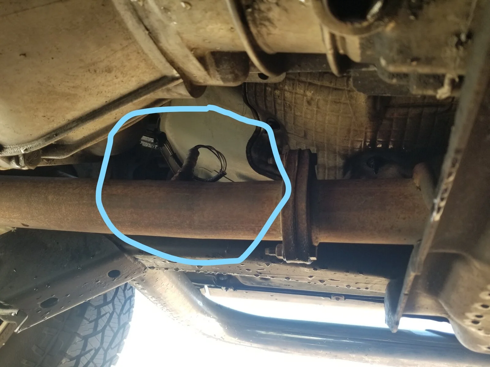

And in the last picture (I hope they are in order) is the last o2 sensor. This is located after the split and before the catalytic.
O2 sensors are located in the exhaust system. That is your intake manifold.
The bungs for California emissions Bank 1 Sensor 1 and Bank 2 Sensor 1.
That should be your Federal emissions Bank 1 Sensor 1. Bank 1 Sensor 2 should be located after the catalytic converter.
Do you know what this is then?
Well I am at a loss if one of these bongs are Bank 1 Sensor 1. How would I remove the check engine light?
Maybe this is the one I need to change if your saying this one is also Bank 1 Sensor 1?
it looks like an intake air temperature sender
Only for a California emissions TJ. You should have a Federal emissions TJ which doesn't use those bungs.
You can clear the fault code causing the light to come on by using a cheap code reader from Amazon or disconnecting the battery for several minutes but if the fault is still present the light will come back on.
It should be. I'm usually not an advocate of firing the parts cannon but in this case NTK O2 sensors are inexpensive and the part looks to be an easy R&R.
But I do have the bongs so, I guess it could be OEM or the PO capped them.

Now if I were to replace it (The Federal Bank 1 Sensor 1 you spoke of) would I use the NGK 23122??
It should be. I'm usually not an advocate of firing the parts cannon but in this case NTK O2 sensors are inexpensive and the part looks to be an easy R&R. I have the NEK
It is possible that the factory only made one manifold to use on both Federal and California TJs.
Yes. You might as well install it since you already have it.
