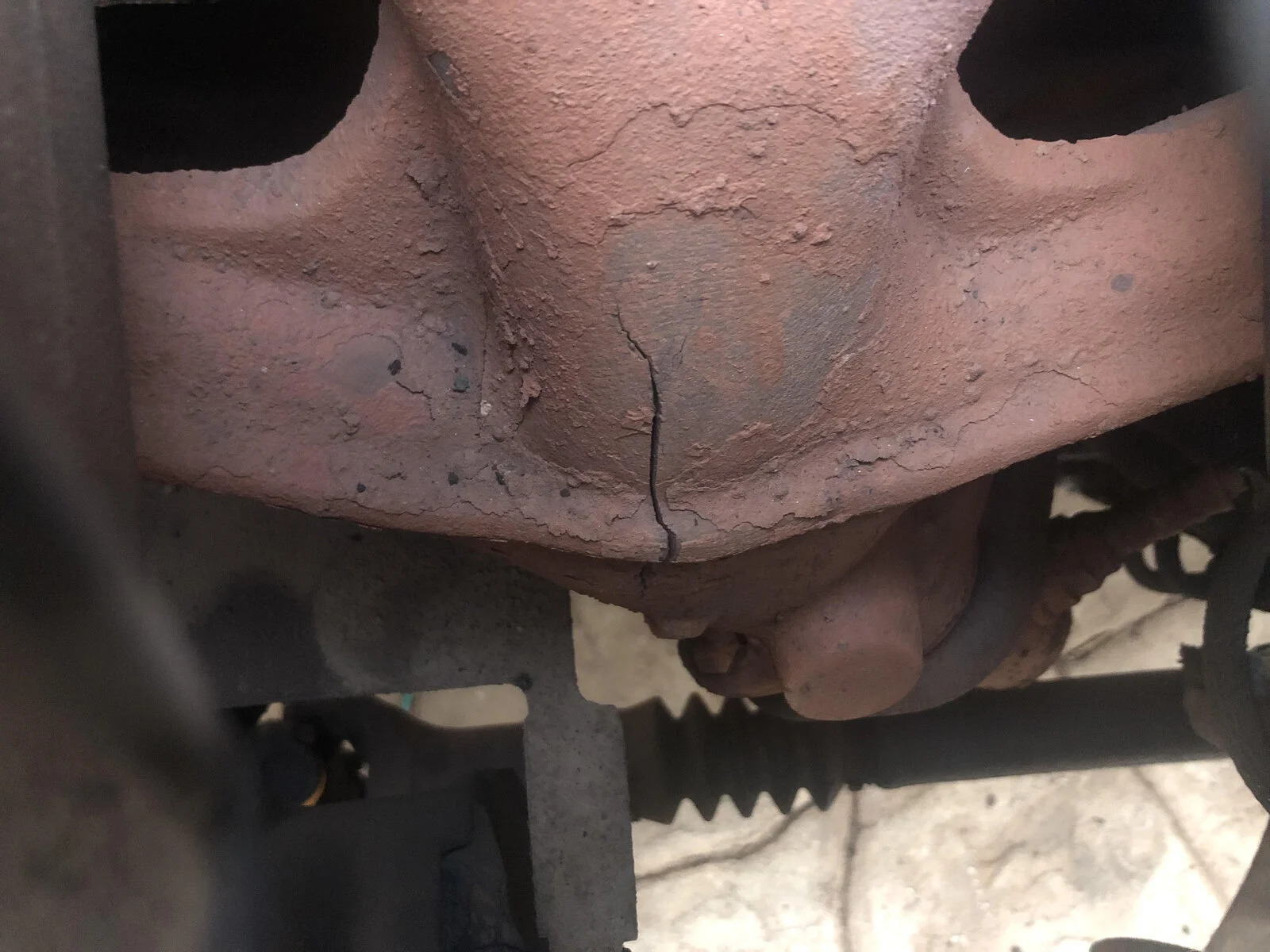

you mean like this?
that would explain everything considering i have changed out just about every sensor an looked over all the wiring and was getting ready to look up my insurance policies fire coverage lol
