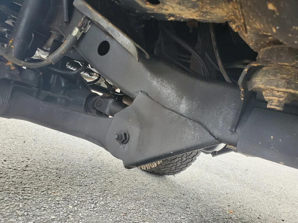

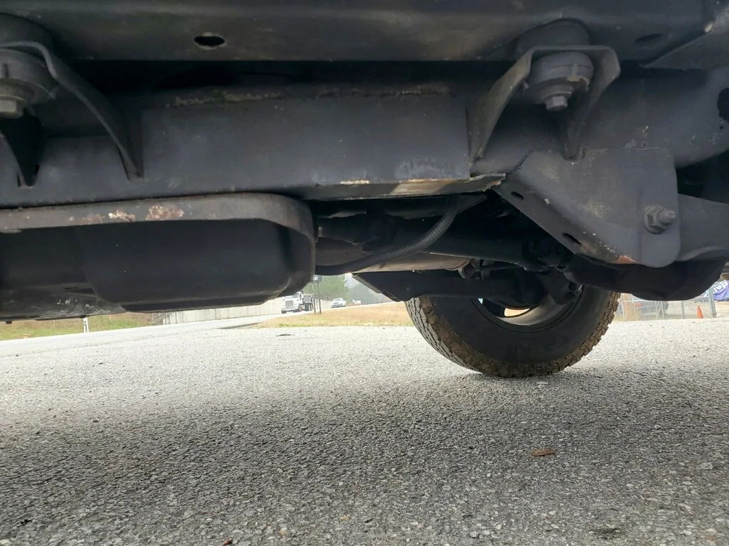

I'm looking for a stockish TJ for my daughter. I found a 01 Sahara auto with 180k for a decent price. All the pics of the body and interior look great. I asked for underside pics and the first couple looked good. No obvious rust issues. Then the last two pics show what I believe is one of those Safe-T-Cap frame repair pieces. What do you guys think of the condition of the frame?

Definitely been repaired..whats the asking price? It should be much lower than a similar jeep with a nice unmolested frame
1. Safe-t-cap is not welded in correctly. See no welds on the ends and no welds between the body mounts.
2. 97-02 had 32rh transmission 42RLE is 03-06. You can drive it in gear and see if it slips, find a long grade and see how well it hold gear going up hill. Also check the fluid to see if it’s burnt.
3. I would walk away from this Jeep.
