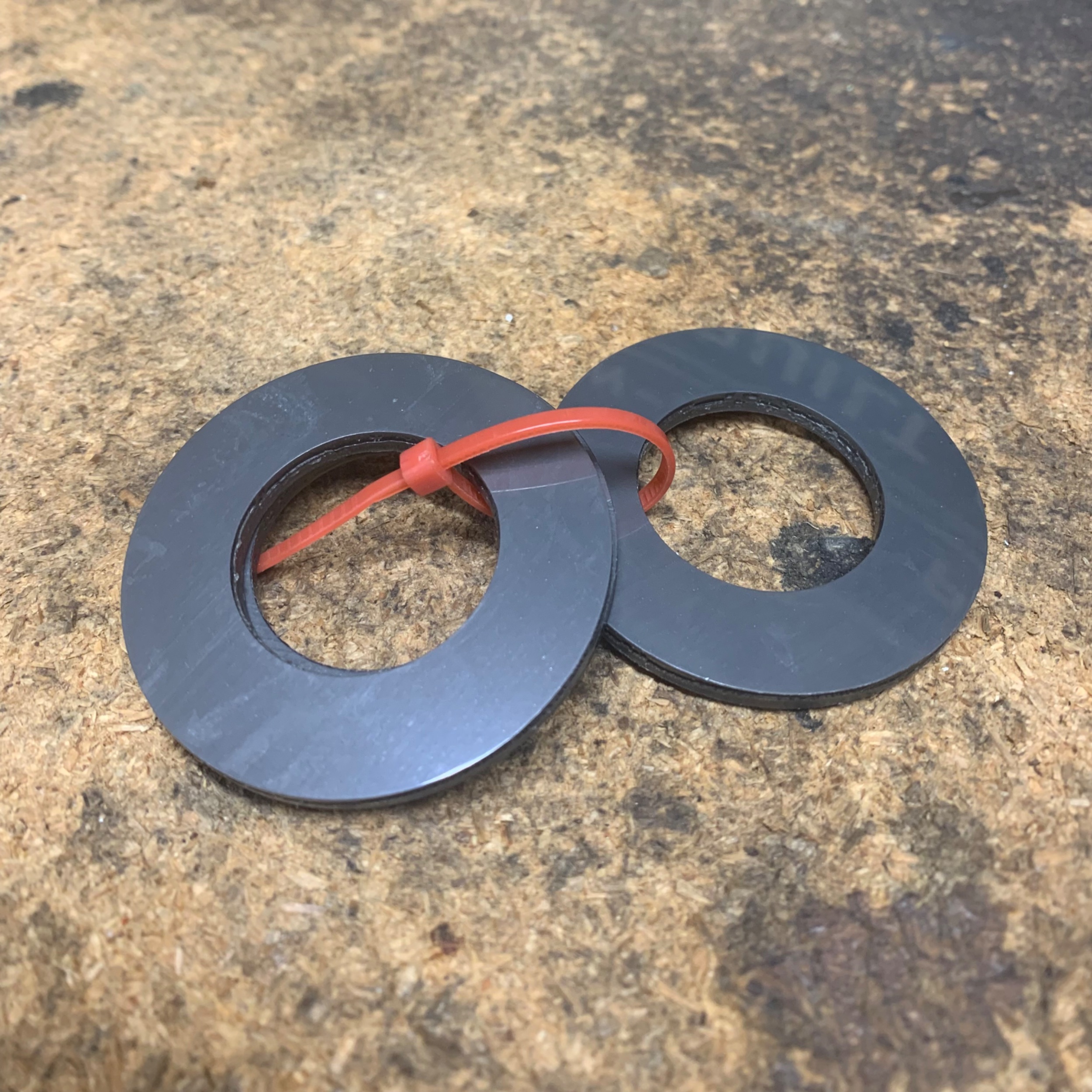

I noticed when rotating the tires yesterday that my Antirock on the driver side hits the lower rear power steering gear bolt on the downward swing of the Antirock arm. I have it installed per the instructions so I tapped the torsion bar over about 3/16" of an inch to clear the bolt.
Has anyone else had this issue and if so, how did you correct it? I am probably going to grab a large flat washer and put behind the driver side arm to keep it from slipping back to the passenger side.
@mrblaine once referenced these… McMaster Carr part number 91545A390
PM me your address and I’ll send a couple your way.
