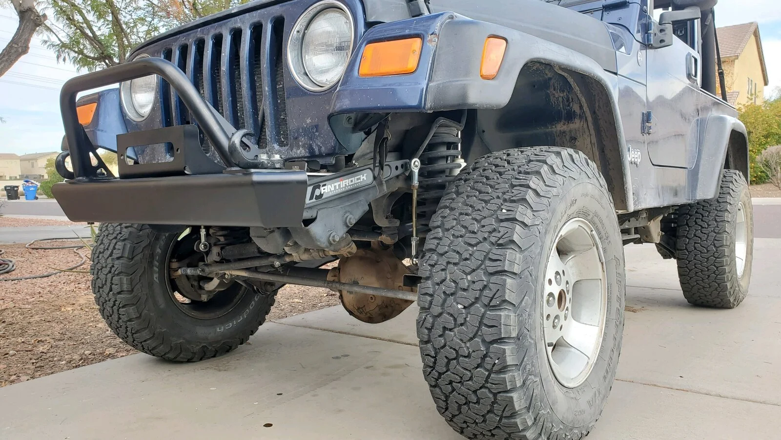

Im installing this antirock on a 2 inch lift so, per instructions, Im cutting the sway bar links down to appropriate length. I’ve maxed out how far I can go without removing the jam nut which ends up having the arms angle above the frame.
so...
- should I remove the jam nut to cut more of the rods and bring the arm angle down, or would that be stupid?
or
- should I leave the jam nuts where they are leave the arm angle as you see?
or
- contact Currie for shorter links?
Hang the axle from the shocks and double check that the arms and links aren't pulled straight. If not, then run it!
