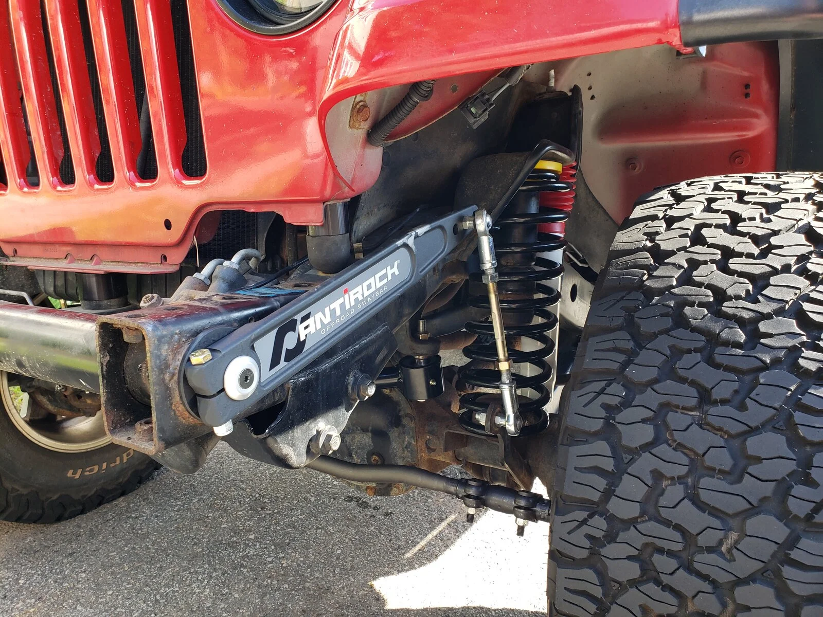

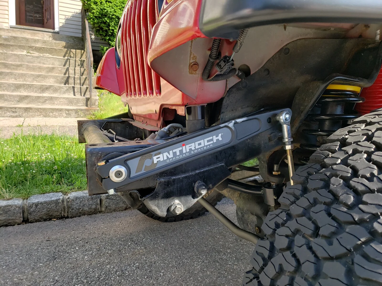

Installed the suspension and antirock. Does the angle on this look right? I did not cut the links yet and wanted to get some input before I did.
It might be a bit high compared to other installations on other jeeps, but what matters is whether or not the arm contacts anything at full stuff more than whether the arm is at a particular angle.
Cycle your suspension and check to see if there is contact when stuffed. If not you are golden in that direction. Since you have a body lift my guess is that you are fine without cutting the end links.
Then check with tire drooped, if no risk of the link inverting you are golden in that direction as well.
