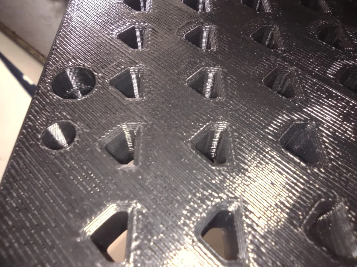

If you can get if off in one piece, I can probably model it up. Before I got into managment, I was a plastics products engineer. I know how to model that kind of stuff...as long as its relatively box like. I don't do much surfacing...but the picture you showed looked like a pretty simple shape. The print would need some finish work before you install it in a car...
this is pretty typical for a final surface of a 3D printed part:

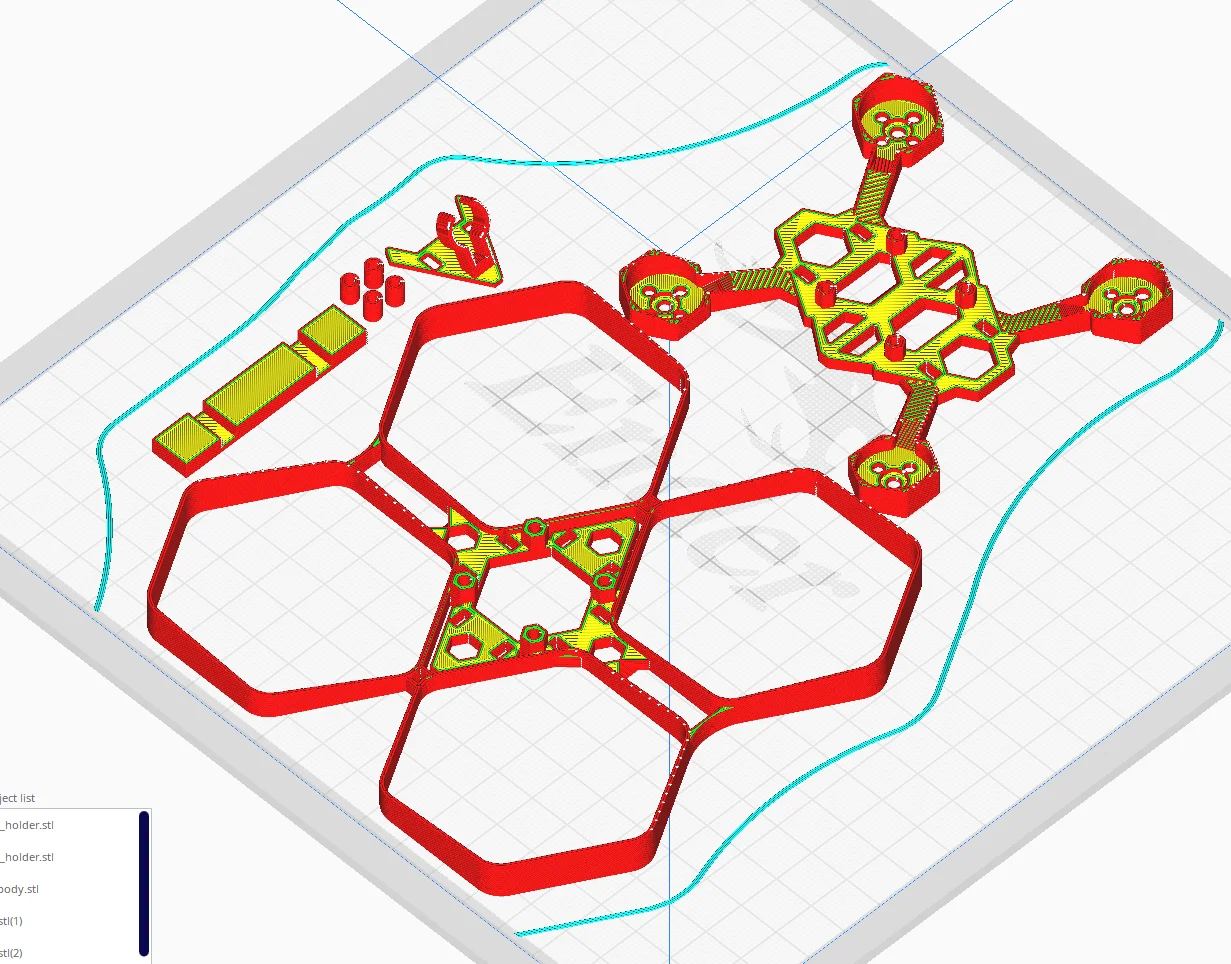

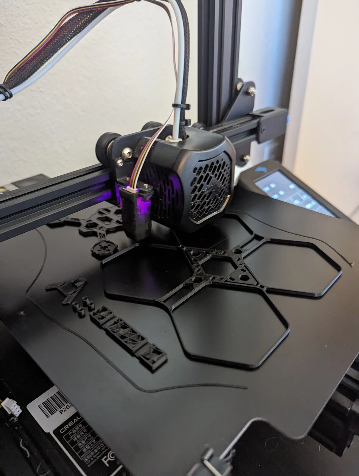

Which one did you go with? I'm currently printing a quadcopter frame.

That's a clone of mine (ender 3v2) - it takes some tinkering but then it gets pretty good.

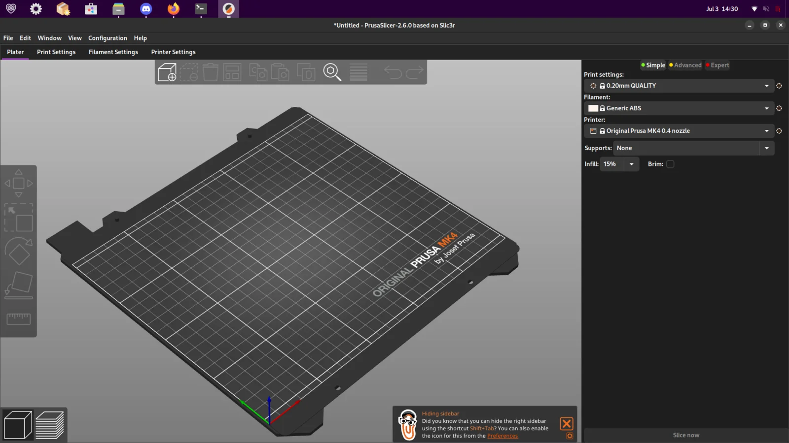

I believe one of the libraries nearby might have one to use for a fee. Is Prusa Slicer a decent one to use? I've heard of people using this and I just installed it on my laptop to play around with. But yeah, I have a bunch to learn for sure!
That generates the print file from the model...so its a couple steps away from your sketches in a note book. Typical Process:
1) Design your part in 3d
2) Convert Native model to an .STL file
3) open the STL file in the slicer program. The slicer will Layer the model out, and generate the code for the printer to run.
4) Push the print button.
5) Pray (though the software and printers are getting SO MUCH BETTER now, successful prints have a much, much higher probability. I've been playing with them for a while, and at one time, it was about 50%).
