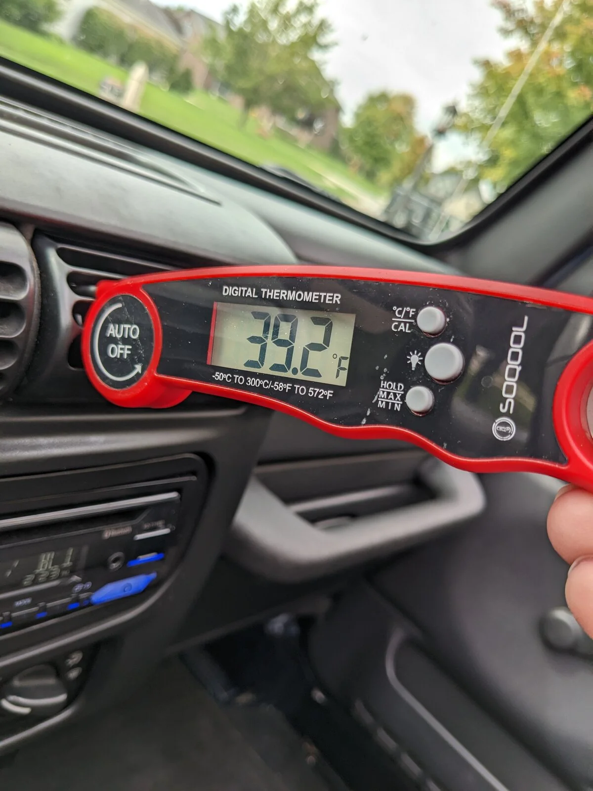

Fwiw I've got 63 ambient and 48 at the vent.
Oh, nevermind!!!! Just went and drove it hard. Came home, it took the rest. Compressor stays on. The FSM doesn't recommend pressures at 60F but I'm at 30 low and 150 high which jives. Oh, and now it's 39 at the vent. 🥶🥶🥶☃️⛄❄️🌨️
Low side pressure should be around 28psi off to 38-42 back on, you look like your good.
