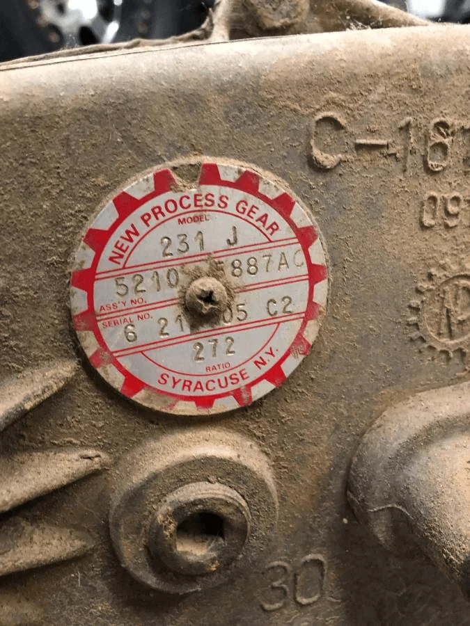

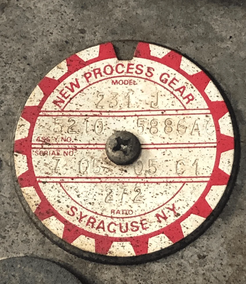

If you can get the tag numbers off of the two tcases I can tell you if they are the same or different.
Here is the tag off of my case
79576
And here is the tag off of the case I am buying
79577
Your top 231 tcase is configured for your automatic. The bottom tcase is configured for a manual transmission... which means it has a different length input shaft.
