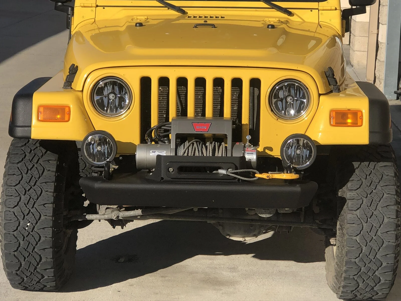

I have the e-code Hellas on both my Jeep and my car. Still running halogen on the car, but put Beamtech LEDs on the Jeep. I've never seen headlites so good. Some of the dedicated LED replacements may be better, but these are plenty good for me - and I wanted to keep my headlites made of GLASS. Otherwise, I'd have to replace them every few years here in Florida.

I removed E-codes with LED bulbs to install the Truck Lites. I was worried about blinding people by all the horrible stories people tell on here. The cutoff is definitely more defined with the Truck Lites. They might light the road a little bit better too. I'm still flip flopping on going back. They just look ricer to me.
