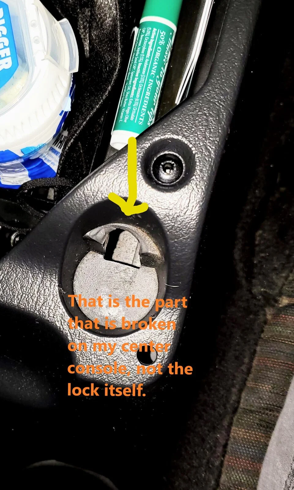

I couldn't find the thread on the console issue I have (probably operator error), but this is the part that is broken on my console.

If it were mine, I’d try and find a piece of plastic from something random, cut it to fit and epoxy it into place. You could even epoxy a small price on the under side to keep the lid from having excess slop.

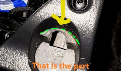

Similar to what @ChadRay13 said I'd cut a piece of aluminum or plastic in a small semi-circle. I'd use a dremel with a cutoff wheel to cut on the green line so the insert fits in a slot when you epoxy it in place. I'd cut the slot in the side of the recess, not through the damaged part if that makes sense. That way the new piece is wedged in place as well as bonded. If you wanted to go crazy you could even cut out the entire old section and put a new flat piece all the way across at the same height. Depends on how crafty you are.

Adding the slots a good add-in I didn’t think off. Keep the piece from pulling up.

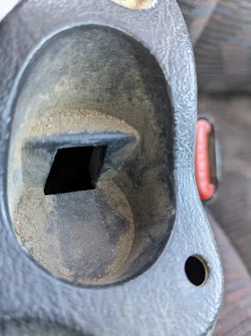

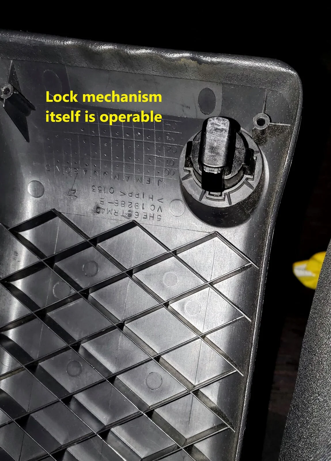

Would someone mind posting a pic of what it looks like not-broken? I’m looking at the lock and my broken part of the console and for some reason I cannot make sense of how it works.
Thanks!
Ahhh I’m just seeing now that there’s that little piece on my lock cylinder missing.
Never even saw that in the second pic on #5… so that would be my issue.
My bad *facepalm*
Guess that means I just need to replace my lock cylinder unless there’s some easy DIY fix for that.

Get a small piece of welding rod, 5/16- or 1/4'' , about 1.5 '' long (trim to fit). Heat it with a propane torch while holding it with a pair of needle nose pliers'. When ready melt it into the plastic from the underside and enforce it with epoxy. Just be careful you don't push it all the way through the plastic..
