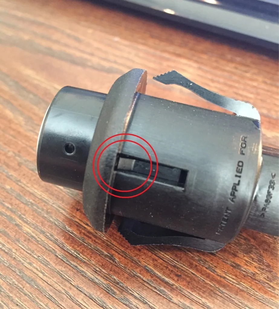

  1. Remove the lock assembly from your center console lid by pressing on the tabs on the side of the lock, and pulling it out.
  2. Remove the center lock out of the entire assembly: press on the circled tab with a slotted screwdriver or anything flat, and then pull the center lock out of the assembly (hold onto the bottom slide while you do this, because it is under spring load and will fly out if you aren't careful.
  3. With your key inserted into the lock, in the unlocked position (the key will be in-line to the tiny hole), use a strong needle to press into that tiny hole, holding down the retaining pin. While it is held down, turn the key counter-clockwise until it turns a full 180 degrees. Then, the actual lock itself will come out of the center piece.
  4. For re-assembly: put the lock itself into the center piece, and turn it 180 degrees clockwise until it clicks into place.

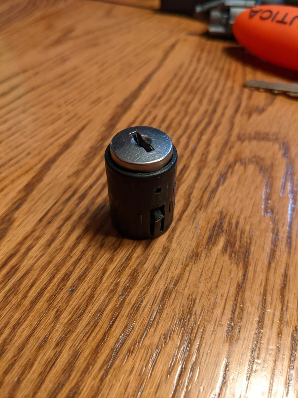

I'm wondering if anyone can give me some advice on this. For some reason I'm having a hell of a time getting the cylinder out of the little plastic sleeve it's in.
I'm stuck on step three. I have a punch set, using the smallest punch I have I can insert it into the little hole and I can feel I'm depressing the little tab. But the cylinder will not move at all. I even tried holding it with a pair of vice grips to get better leverage on it. With the key in the cylinder, and holding the tab through the hole with the punch, this thing doesn't move at all.
Can anyone give me some tips? Am I missing something? I've followed these directions to the tee but I'm getting nowhere. I just tried doing this on the older style 98 console (the cylinder is the same part number, just different housing) and had no problems removing it from its metal sleeve. Are these plastic ones for the later year consoles really that much harder to do? I attached a pic so to better see what I mean by the plastic sleeve holding in the cylinder.

dunno if you figured this out yet but since I just went thru it with mine I'll chime in. The key needs to be in the unlocked position, which it appears yours is since the slot is inline with the little hole. You should be able to see the little button inside of the hole. With a small pick you should see it press in. With a stronger pick, you should be able to press the pin in, while at the same time turn the key slot counter-clockwise. It turns about 90 degrees and stops. Once you get it to this point, the lock cylinder will pull out. You may need to push/pull on the cylinder a bit as it might be jammed in the plastic. Just looking at the pic, it looks like its a lot higher in the sleeve than it normally is so it may have been pulled up before turning it counter-clockwise and is now jammed in the plastic sleeve.
Hope this helps
