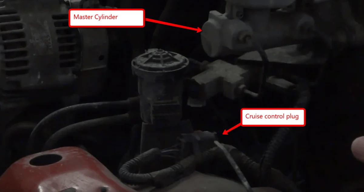

The unused connector in the engine should be easy to recognize if there. Driver side fender, midway up, and is one of the connectors with the little red locking clip.
If you are sure what that looks like, the speed-o on the back of the transfer case, the fuel pump on near the gas tank, the hard top harness, and the cruise control may be the only red locking pin harnesses in the TJ.
i find it hard to believe that mine isn't already wired when everyone swears up and down that all of the '05-'06 models had it. from what i've seen/read, this is the only place the plug is located and it's not there for me. it doesn't even appear as if it's been snipped/cut off.
Yeah, that is weird. I didn't know 05-06 were all wired, but that is indeed a cruise control plug. You can see the little red clip if you look carefully. You don't have that, huh? I also can't imagine someone cutting that off.
If it is not there, it is not there.
Not all are wired for it, regardless of the year.
I have probably a total of 20 minutes of staring time into that spot over a period of a month. And every time i did it, its because everyone swears up and down that it should have it, so i kept opening the hood just to make sure that 11 previous times i opened it were not in my dream.
You are not alone, i have counted 6 people so far who don't have it. Hope this misinformation ends soon.

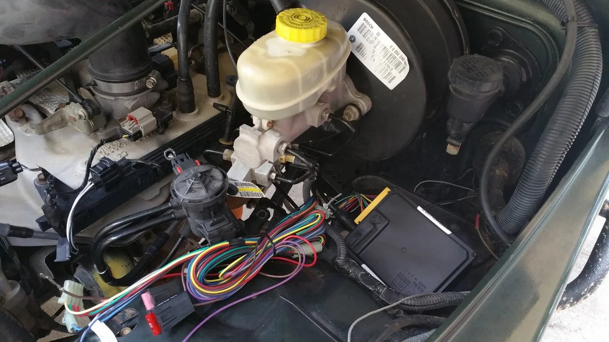

Where did you guys mount your unit? I could not think of a better spot than on tray under the booster
There should be piece of flat bar stock that attaches to the control unit with lots of holes in it. To the passenger side of the power brake booster, there were two stock bolts that come out of the firewall at the same level a few inches apart, and have nuts on them. I added an extra hole in the bar so that it would slide right on those two bolts and put the nuts back on. I might have had to bend the bar a little so that the box didn't hit the firewall. I don't have that Jeep anymore or I would just take a picture for you, and I've relocated a bunch of stuff to that location on my LJ so I can't take a picture of the bolts. Hope that's at least mildly clear.
Yes absolutely, thank you very much.

how'd it turn out? did you buy the kit because of this thread?
So far on pause due to the weather. Unit is mounted and everything is wired besides the power wire.
Current issue is reaching the power wire to the fuse box, because i tapped into a speed wire in the PCM, and the only firewall exit i could find was on the driver side.
I purchased it because I had my eyes on this kit for a long time, but i couldn't find the courage to do the wiring job. I simply lack the experience and basic knowledge. Don't have any clue on what i can and cant touch or connect together, but i do know the consequences of replacing fried wiring harness 😰💀.
However, last 30 hour round trip kicked my butt. It was not the first one, and defiantly not the last one.
