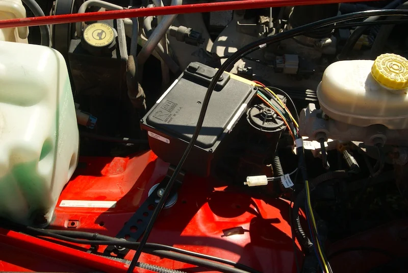

I installed the Rostra unit last year with rather less than "the usual" hassle. Bought mine from "The Cruise Control Store" - they included a 1 page "cheat sheet" for wire colors et al. However, one color therein listed was wrong, but the FSM got me straightened out. I too went through the problem with where to tap into the speed wire - I ended up tapping it right at the xfer case (for better or worse). I do have the clutch switch, although I drove it without for a bit and it was "ok", but I like having the switch. I even wired a PBNC in series with it as a "cancel" switch as the factory Rostra control handle doesn't have that feature and I use it quite a bit.

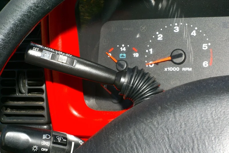

I installed the Rostra as I specifically did NOT want the factory cruise setup - I patently dislike cruise buttons on the steering wheel. The default control handle that "The Cruise Control Store" normally sends wasn't what I wanted either, but they gladly substituted the one that I *did* want:
The driver *can* see the fuel gage from the driving position with the wheel tilt mechanism set about 1/4" low.
Servo mechanism in a position similar to OEM. I've had Rostras in several vehicles over the years, and have always gotten good service from them.

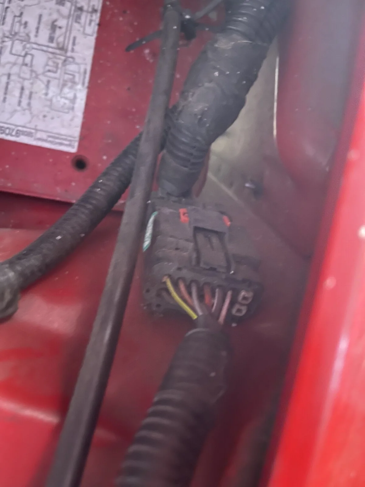

Sorry should’ve worded that differently. It would be near the empty ABS tray, in front of it, alongside the driver fender if you don't have ABS. It looks like one of those annoying red tab connectors. Again, I don’t have it so going off of what I’ve heard from other people. If you go to this YouTube video you can see the connector at 15:00 (however, on an XJ it’s on the passenger side).

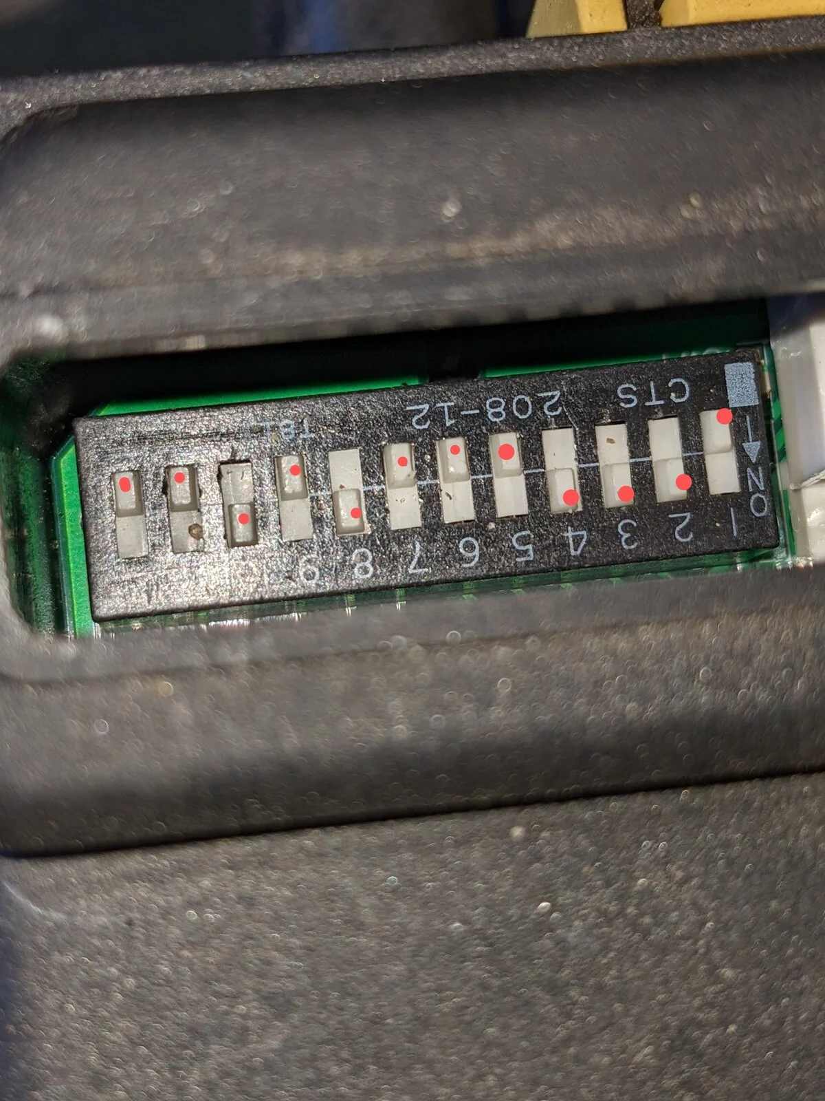

This are mine for the 6 cyl manual. Engine and transmission should be the only variance in settings, but double check my words as it has been a while since i installed mine.
Google their programming functions, if by evening you are still struggling i will be able to help you then.
Reactions: Zorba

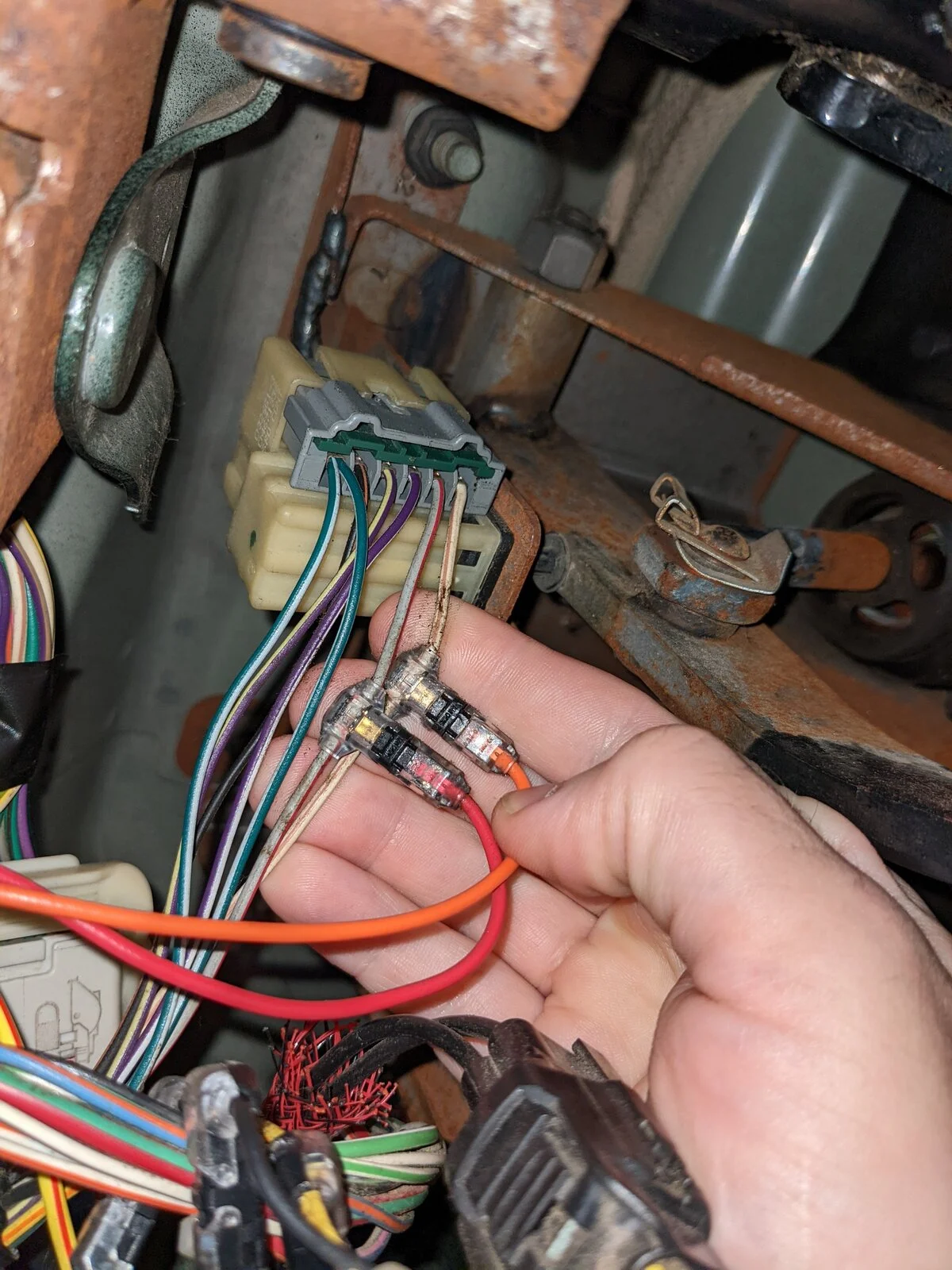

I used your settings and it works a lot better at keeping the set speed. It's not perfect but better. My brake doesn't cut it off tho. What wires are yours connected to? Thanks for all the help!!
I assume this are Rostra wires.
Brake:
Orange to White-Brown
Red to Grey-Red
* refer to factory manual for wiring, after some year later models received a bit different wiring colors.
Reactions: Rickwhoo and Zorba
Clutch disconnect will not work with factory wiring, mine is not functional and i don't remember why i spliced the wires. So if you are not using it, you should have blue and black wire not connected to anything... Unless black is ground, then you can do black to black on clutch switch.
