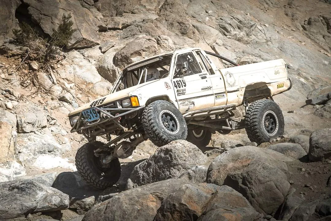

Wow!!!! Shocked. Ever heard of Jesse Haines? Or his 2019 co driver Harry Wagner? Jerry should have with his high online forum activity. They used a leaf sprung rig in 2019 KOH but okay.
More hear say on the forums from the high post guys.
How far did they get before they broke it?
Were you at 2019 KOH EMC? The only reason I ask is bc the winner was on leafs at all four corners...
I was there as they rolled in. To put this into perspective, the relatively stock Toyota on leafs came first which was before the initial time cut off. Something that Savvy/Jeep was unable to do on coils with a near unlimited budget and choice picked drivers.

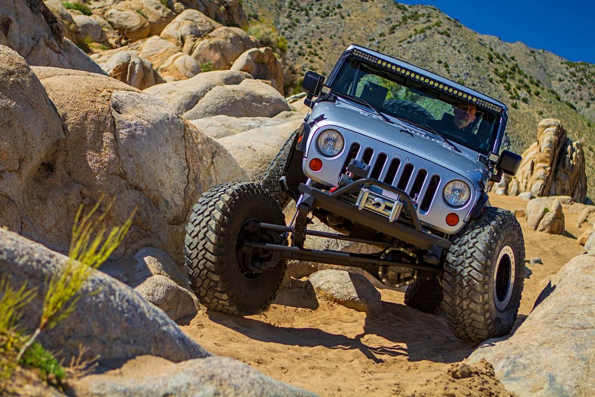

Would the word from an Ultra4 champion be of any value? He owns Marked Motorsports and builds Ultra 4 and KOH rigs.
He was quoted saying the leafs on his JKU build ride great and flex “like mad” off road: “The handling on the road is great and they flex like mad on the trail.”
From his website: https://markedmotorsports.com/jan-2017-4wheel-offroad-jp-featured-the-leaf-spring-jk-p-167.html
“2008 jeep wrangler JKU that was specifically built to be lighter, longer, and more capable then similar built JK's on the trail. Professionally built in 2016 by rock crawling, and Ultra4 champion Jake Hallenbeck. The JK features a minimalist approach by keeping it simple and light, while using quality components that work. Its design was meant for trail fun while keeping his children and wife safe. The jeep was featured in the January 2017 Issue of Petersens 4wheel & Offroad.
The main attribute you will notice is the jeep is mounted on leaf spirngs. WHY? This jeep can do 80mph with one finger on the steering wheel. There is no bump steer or any other negative effects on the street caused by a majority of suspension systems on the market.
Typical JK's have coil springs which are not captured (mounted) on the top. Weither turning on the street or flexing, nothing is pulling the body back to the suspension which lets the body roll. Add a locker, and bad suspension geometry, and the body roll is heavily increased on the street as well as offroad. Coilover shocks also work in the same way. They only PUSH UP, never pulling down, only adding to an already unsafe issue.
Leaf springs "pull down" as well as "push up" creating a perfect balance which also makes this JKU more capable offroad then the next. Leafsprings do have some spring wrap or wheel hop, but to alleviate the issue Jake added a custom traction bar which doesn't limit articulation. This JK has NO swaybar, and if that's not proof enough of the concept, or you dont think its capable enough, come take it for a ride!”
