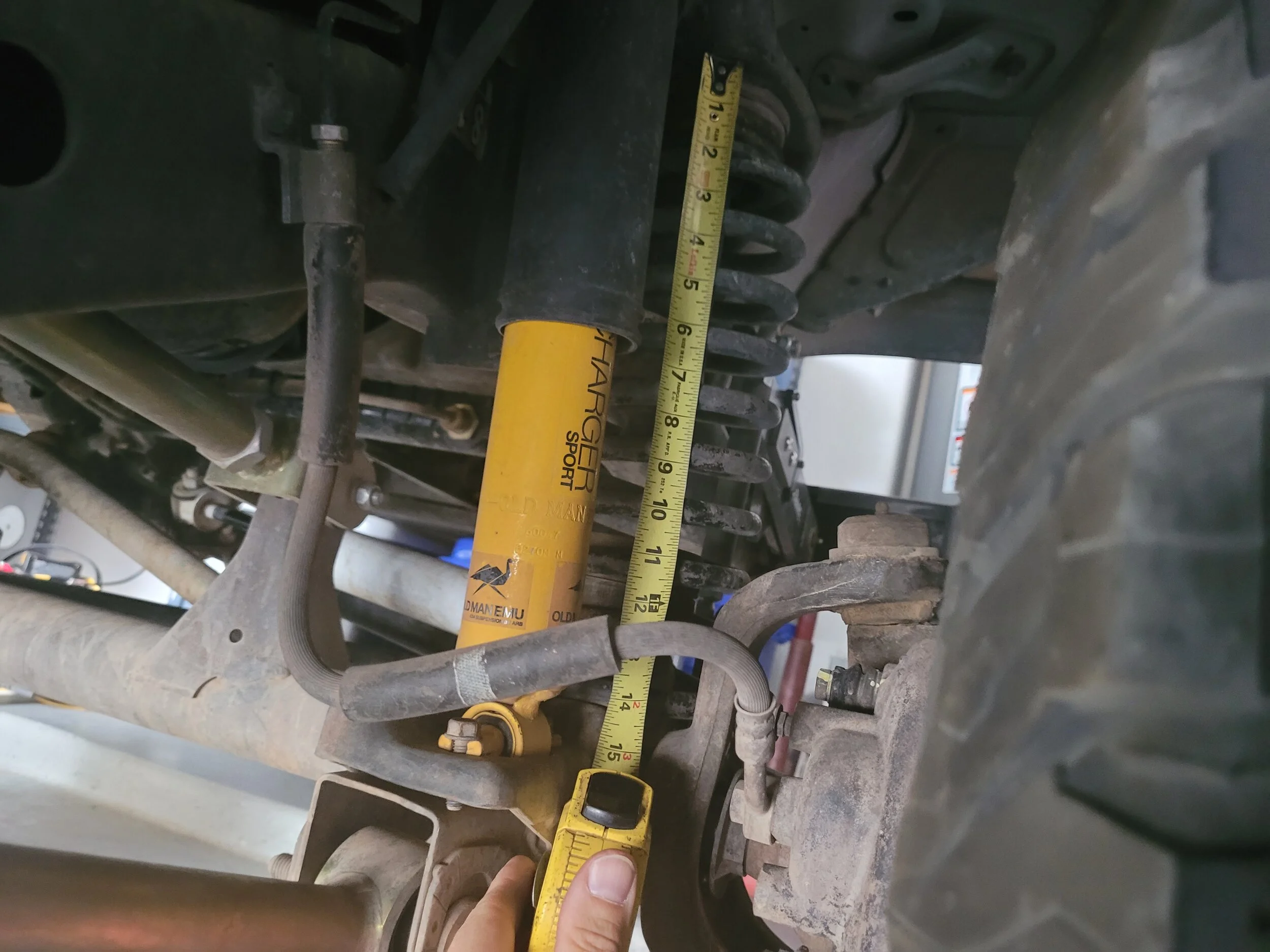

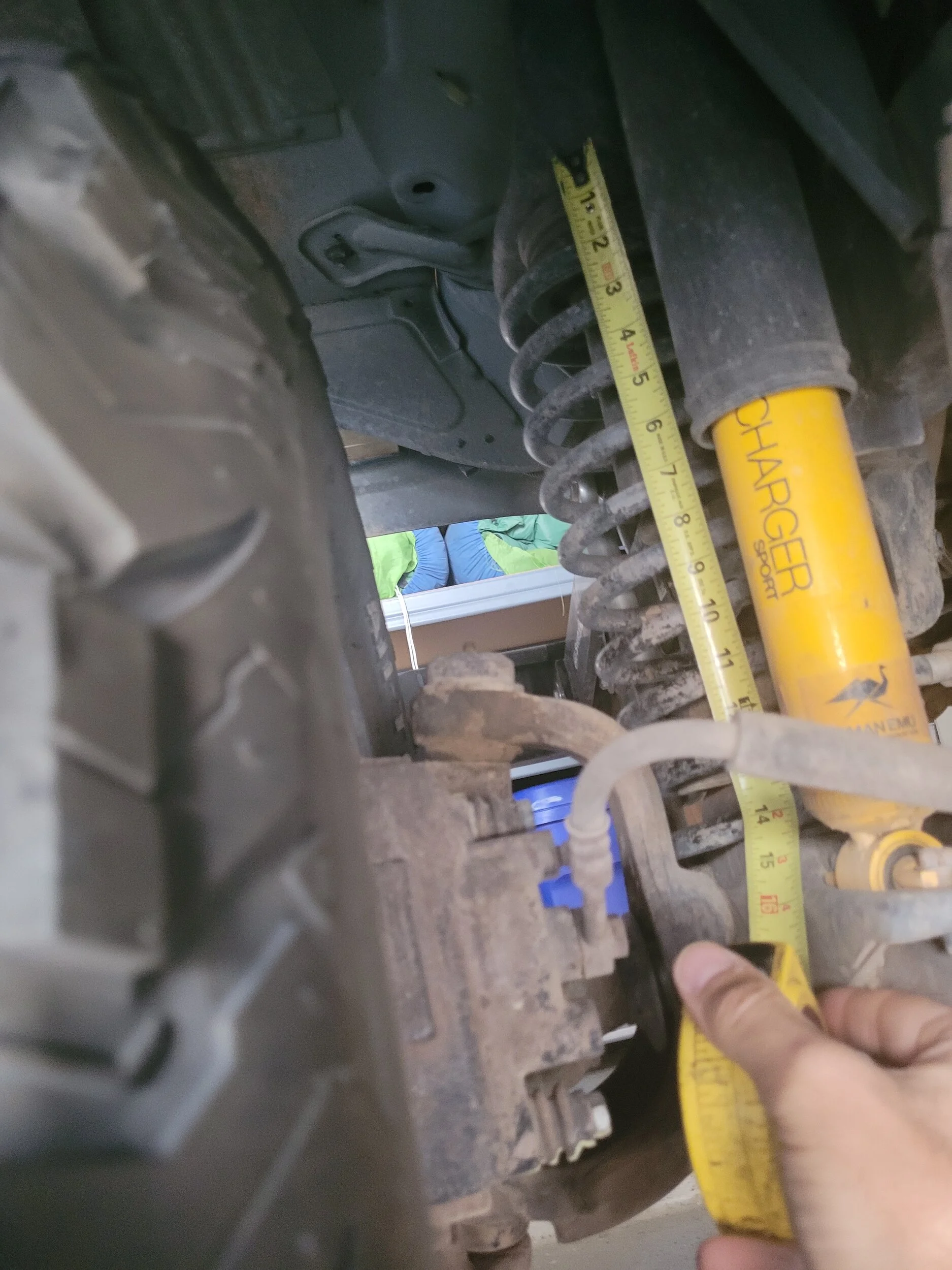

How much spacer and what is the compressed height of the spring?
1st pic passenger side, 2nd driver. Tough angle, but just a smidge under 2.5" (call it 2 3/8) including OEM isolator + 1 additional isolator. ~14.375" between the top/bottom spring perch surfaces. OEM front bumper w/o milk jugs + tow ponts (2lbs) + light mounting bar (1.75 lb) and lights (2 lb), so OEM bumper + ~6 lbs on the front).
I went ahead and installed the springs and got right around 14 inches, so a 3 inch lift for my jeep, or two inches for a “normal” jeep
