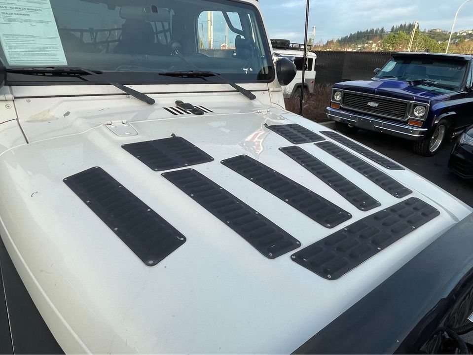

Anyone install hood vents?

If vents made a difference I submit that Jeep would have integrated them into the factory design. It's not like automotive engineers aren't good at their jobs....

That's not the correct assumption
If jeep needed vents for extra engine cooling they would have them integrated into the factory design.
Vents work, they just are not needed in a normal jeep with a properly operating cooling system.

We are also adding venting to the engine bay for reasons other than performance. Jeep engineers didn't care about the longevity of these vehicles after a certain point in time. We are 18 years past the last of the TJs.

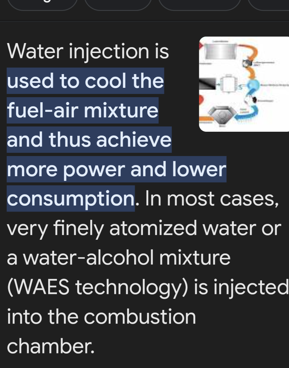

Water injection has been used for decades to lower the air intake charge temperature to reduce premature ignition
Higher octane fuel has the same effect.
Water injection or higher octane fuel does not increase hp on it's own. Under certain conditions it can minimize the loss of hp especially on VVT engines.

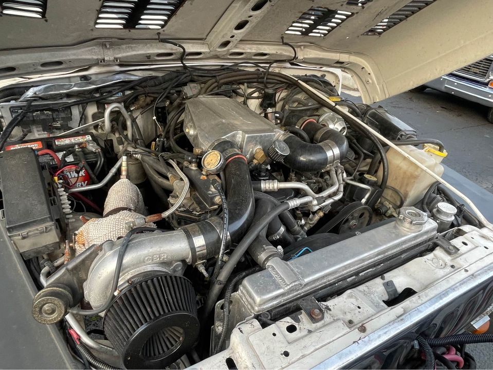

This is under that hood.

That's not entirely true as they've been using water injection on turbocharged vehicles for many years and even naturally aspirated....
Which turbo did you install on your 4.0?
No, I didn't fit a turbo , what I'm saying is water injection had been used on both turbocharged and naturally aspirated engines, for years , It makes a sizable difference. And on certain mornings when that air density is just right you feel the difference... So if you can take some of the hot air away from the air inlet and give the engine a cooler air mix you going to notice a difference..
You should install water injection onto your 4.0.

They may have, but the bean counters came back with:
It will cost us 11 cents per vehicle to install these vents that will help longevity, however it will only save us 8 cents per vehicle in anticipated claims within the warranty period.
Therefore, this is an unnecessary 3 cents per vehicle additional cost that directly diminishes the profits that we could be getting.
And all us bean counters get an attaboy and a bonus for saving those 3 cents.
