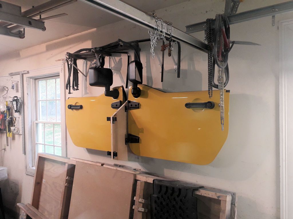

I need to hang a few sets of doors on the wall. Has anyone made something that holds them just like their mounted on the vehicle?
I have a 6x4 that I plan to bolt to the wall and hang my doors on using the following brackets. The 6x4 allows the weight to be carried straight to the floor and also spaces them out from the wall. It’ll be set up to have two sets of doors on it. I have 3 sets.

I took a 6x6 post, 5 feet tall, added snap clips (like you have on a dog leash to connect to the dog's collar) at the top and bottom to connect to the wall of my garage, and then added door hinges I bought off eBay. When the doors are on the Jeep, the post is stored out of the way. When the doors are off the Jeep, I connect the post to the wall and mount the doors to the hinges and I use a bungee cord to keep the doors from swinging away from the wall. I guess I have less than $25 into it and I did it some years ago.

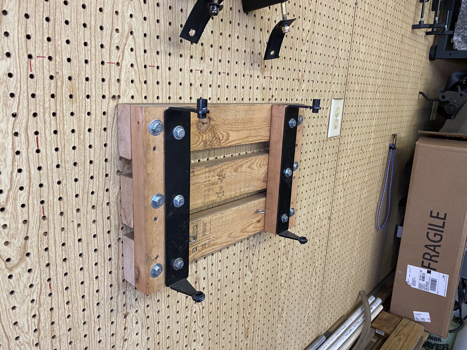

Thats what I have too. I hang mine with the exterior towards to wall so I used some 2x4’s to be able to space them out because of the mirrors. I fold them in when I hang them. Then I use the two blue bungee cords over the doors and hooked to the eye screws on my mound to keep the doors from moving.
I glued the little spacers in the hangers so they would pop out when I remove the doors.
