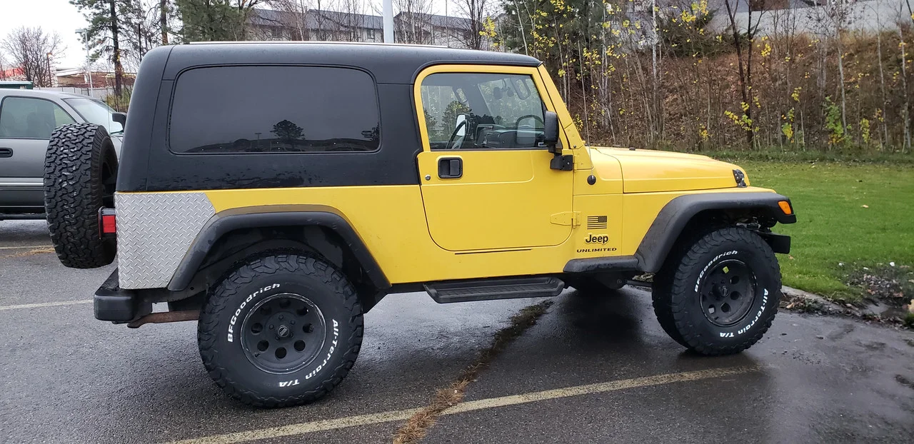

My buddy likes them because they sit flush with his Rubicon flares on his tj. It looks good. Here is a picture of his tj.

My buddy's jeep above is running 15x7s. I believe the backspacing on those is 3.70 though.
